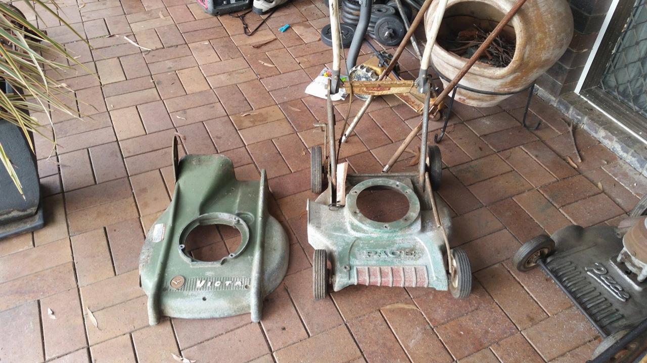

All Good Partrick! I will look out for more Kirby things for you around the place. I have been thinking about putting new Kirby engines on these 2 bases so i will look out for parts and manuals, If not the Ambassador will become a parts mower for my New Victa Viceroy !
My Victa Ambassador and i think a Pace Prestige?

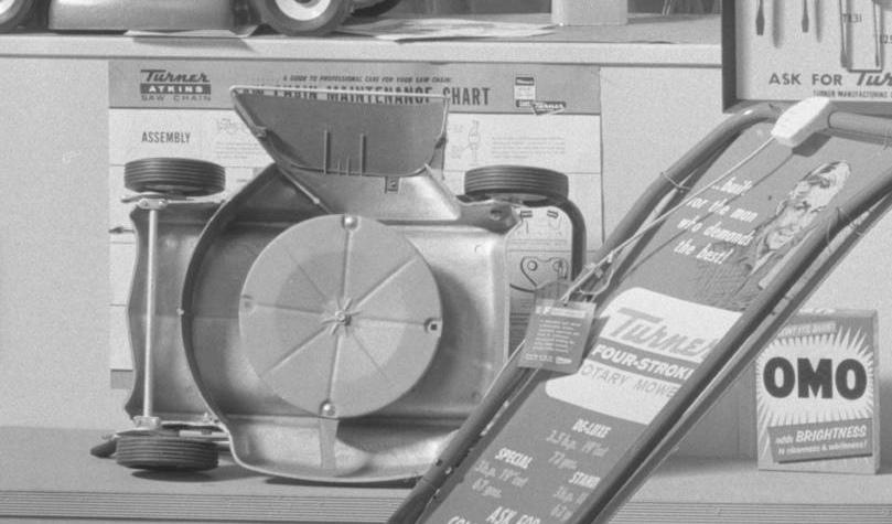

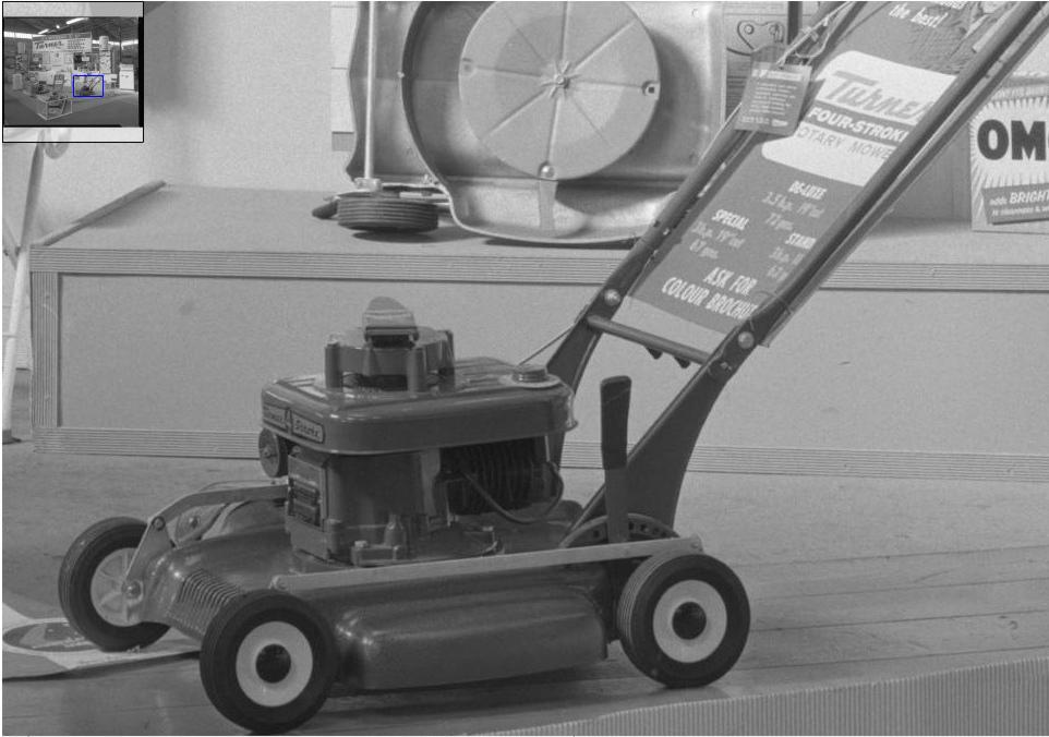

Your front wheels are genuine Turner 'Delrin' (Du Pont) wheels.
The rear ones are not - in my view. Here is a photo of your
chassis on a Turner at the Royal Perth Show, 1961.

Patrick, I was trying to not say this so i wouldn't upset you, but in my opinion i think this mower is too rare to make into a trolley, it is so far the only EA we have found (although there must be more out there). I'm sure there will be more mower bases out there to turn into a go cart, some much more common. If i was i would get the parts i needed, add them on and leave it, perhaps doing a full restoration later. As it is it looks very very good as it is.
But, no matter what you do, i hope it all works well!

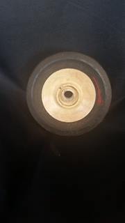

Patrick, you wouldn't believe it, but i have a spare Turner wheel, the only problem is, i'm so far away from you! I seem to have all the stuff you need, Kirby parts and wheels!
sorry for the bad pic, not sure if it matches but its a Turner

In the background of your photo of the Turner at the Royal Perth Show 1961 does the mower on its side show the original base plate for the Eric Anderson/Turner?
Thanks,
Patrick
Joined: Nov 2015
Posts: 637
I think that is another Turner, your EA doesn't have that point on the front.
Thanks for reading!
Likes: 304
Hi Patrick and Kye
Yep, I believe so. The Turner F61 base = Eric.
Note the rear safety skirt. This base did not have a font safety skirt.
[rear of mower is the LH side in photo]
