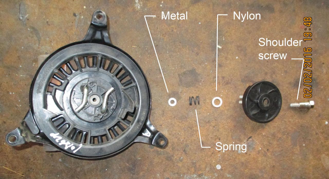

Much to my chagrin I disassembled my neighbour's pull start assy without noting where everything came from. Can anybody help me with an exploded parts diagram?
I am unsure about the order of the small spring, nylon washer, pulley & steel washer at the centre.
Regards.

Off the top of my head, put the pulley in place and the order should be spring, nylon washer, metal washer, bolt. If not then its nylon washer, spring, metal washer, bolt.

Thanks bigted.
This is on a Rover Easytrim Xtra i4500.
I think you'll agree that a picture is worth a thousand words.
With the nylon washer under the screw head the mechanism tends to bind up.
As per photo it works & the old scratch marks roughly line up.

Posts: 961
You can loctite the screw if you wish but don't use anything on the moving parts, you need friction to make it work to throw the pawls out when you pull on the starter.
