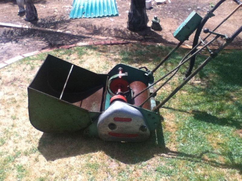

Hello everyone, I found another Scott Bonnar but this one a 20 inch Supercut. The mower is in ok condition but is need of a restoration. It has no engine and engine plate, but the catcher looks to be ok like the frame. I have a few questions regarding how many HP engine this mower can handle and locating a new or used engine plate for it so any answers would be very appreciated.
Cheers, Nicholas

Hello Nicholas 24
The condition of this machine looks quite good.
It appears that it has a cast iron landroll, suggesting that this machine
will also have a cast iron sideframe as well (not alloy).
It appears to have been crank start and there was an SB air-cleaner fitted.
If you can count the number of blades on the reel you might be able to narrow
down the model from the document link (below).
What I am unsure of is why SB would offer some models with reduction gearboxes.
I'm thinking your machine may have had the 25C Villiers 2-stroke on it, but
am unsure (more photos of the engine mount and other side might help a member).
There are a small number of Super-cut owners (including Mod BB) who should
be able to help with engine size suggestions.
Here is a link to the Record (work in progress)
https://www.outdoorking-forum.com.au/forum/ubbthreads.php?ubb=showflat&Number=64309

Hi Nicholas and CJ,
I'm thinking that this SC was originally fitted with a Villiers C12/2 ~ 412 engine which is a four stroke unit. Have you actually bought this machine or are you merely contemplating on purchasing it ?
They do have a bit of a following amongst us enthusiasts but nothing like the model 45. I've just added another early solid deck HK25 kirby powered 17 inch unit to my on going collection that I should really cull down but I seem to part with one and then gain another.
Since you are in Adelaide we should catch up for a brainstorming session LOL !
BB

I've been contemplating on buying this mower for a couple of days now but I don't know a whole lot about them, mostly about the engines that were fitted on them. I was planning to buy this mower because I wanted something a little bigger for the front yard as it is reasonably long. Also, the 20 inch 45s and queens are hard to come by, and I just wanted another Scotty to add to newly growing collection. However catching up with you would be good though :D
Cheers, Nicholas

Hi All,
This particular "Supercut" in question was originally fitted with a BSA engine, (note the odd engine mounts and the rare air filter snorkel). Definitely not the most common engine on a Scott Bonnar but it was a part of the Scott Bonnar line up and thus makes it part of Australia's Mowing Heritage.
BB
