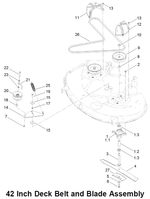

Hi all, I'm a newbie here, just registered, and have a question. I have a Toro XLS 420T ride on which is 4 years old and has had approx. 120hrs of use. Today I noticed some noise and vibration while mowing so stopped to check the cutter deck to avoid major damage. The bearings on the cutter shafts are 'shot' and have serious movement at the blade end. This surprised me as I've had a Rover for some years and only replaced the bearings once but after much more use than this has had.
I'm going to replace all bearings on the deck but can't loosen the nuts on the pulley end of the shafts. Are these left hand threads as I have assumed or conventional RH thread? I've tried both ways but don't wish to force the issue in case I'm turning the wrong way.
Also are these pulleys a press on fit as I seem to be able to turn the shaft within the pulley.
Thanks in anticipation to anyone who can shed some light on this.

Is this your cutting deck?
Manuals can be found here.
https://www.toro.com/en-GB/parts/partdetails/?id=40448
You should be able to determine the thread using this.

Hi Mark,
Yes, thanks Mark, that's my cutting deck and I intend to replace the upper & lower bearings on both cutter shafts as well as the tensioner pulley if it has any, although the exploded view shows what looks like washers rather than bearings, my problem is identifying whether the shafts have a LH or RH thread as the nuts completely conceal the thread. I don't want to use excessive force in either direction in case I do damage to the shaft or housing. Do you have a legend to go with the parts list which states if the nut (part #10) is LH as most part lists I've seen nominate a thread only if it is LH. No such identifier is used if the thread is RH.
Sorry just looked at the link you provided and have answered my own questions. It doesn't nominate which hand the thread is so would therefore think it is RH, but I can't undo in that direction without massive force which I'm unwilling to do.
Thanks for the diagram and parts list as I'm sure I will use these in future.

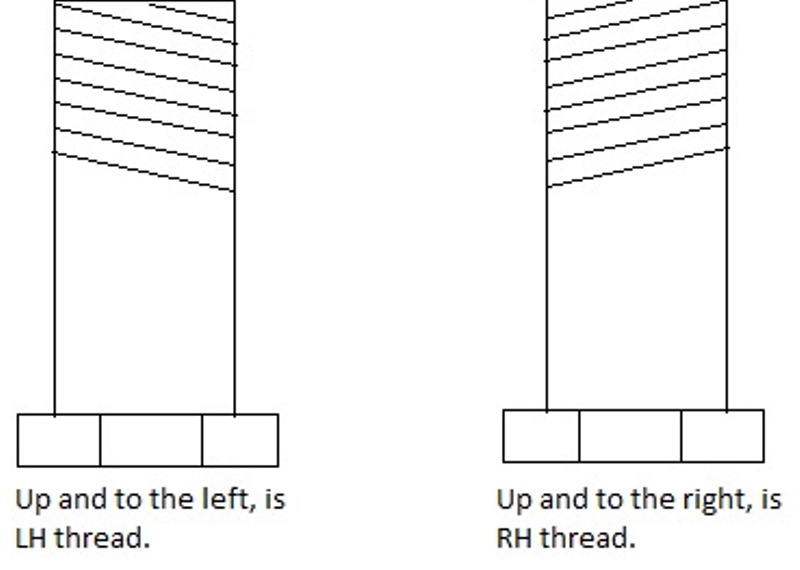

Another way to approach this is, what's the cutter spindle rotation direction, looking from above?
If it is clockwise for both spindles, there's no reason to use left hand threads, which are quite rare on mowers.

Well, think a bit more about the direction of the torque applied to the nut by the pulley.
For CW spindle rotation, the pulley is tending to slip in the CW direction, which will tend to tighten a RH threaded nut.
The only cutter decks I've encountered LH threads on, have CCW spindle rotation. The old Mobilco Heavycut slashers spring to mind, and most Greenfield ride-ons.
Bob W #70065 19/11/15 05:52 PM
Joined: Feb 2011
Posts: 510
Thanks for that Gadge, you had me drawing a diagram of a cutting deck and pulleys, drawing in direction of rotation arrows.
I can see how CW rotation of the pulley will tighten a RH threaded nut.
