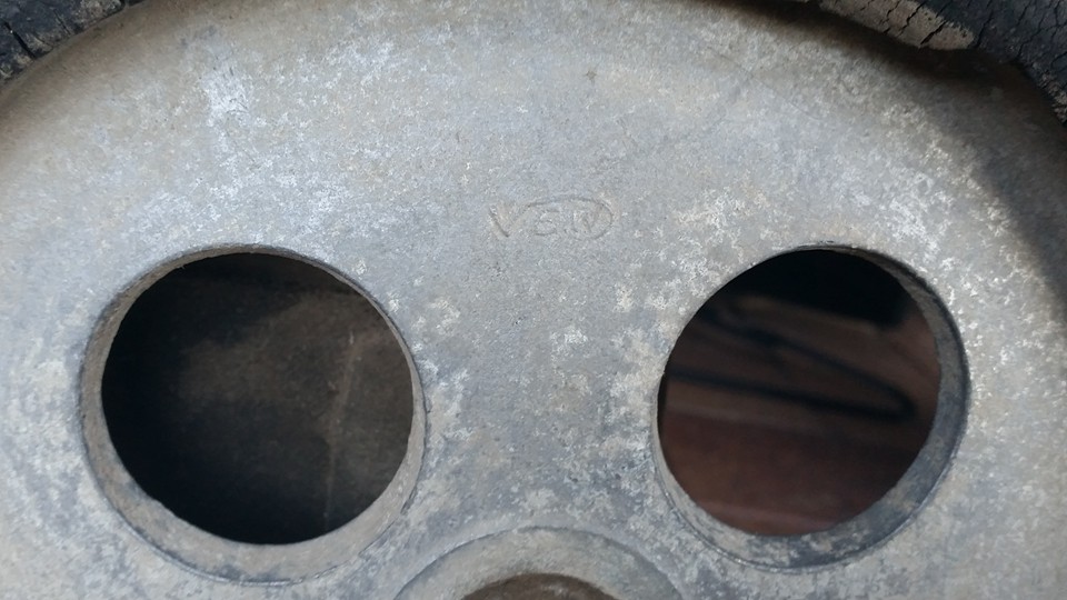

thanks paul, do you guys know any other mower sites that could help me? i really want some more info on this thing ALSO i have found the letters V.E.W on the rear wheels of the mower

i would like to join that but i don't think my dad would like me paying for a mower website frown also heres the pic of the V.E.W [Linked Image]

I was originally distracted by those slotted rear wheels, thinking
there may have been a connection to Kelly Engineering:
