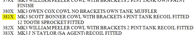

Members might note the early mower number of 00223.
The Midget document I have lists the 381X.
Note the spec says it was fitted with a recoil.
[I do not see how that's right]

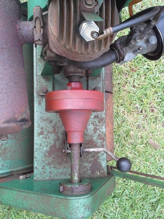

Just looking at some other models and should mine have a thrust washer/bearing where the fork engages the clutch ??
If so, what parts do I require and are replacements available. I don't want to do any damage to the clutch. Thanks
Hi paul_c,
Absolutely correct. In actual fact it would've originally had a brass thrust pad. Strange as to why that would've been removed ????
You can use a current plastic unit that's to suit a model 45, but the engine will have to be removed and it's certainly showing a lack of lubrication at the clutch cone / transfer shaft area.

Thanks for the reply BB, I oiled the fork and lever plus the bearing before use. Would grease be a better lubricant in these areas ? I have found a bush not a problem to fit. What holds the clutch onto the engine output shaft in the absence of a cotter pin, is it just a key way and the clutch is sandwiched in there ?

Removed the engine today
While it's off I will give it a check over
Greased up the clutch lever
Should have my parts before the weekend, I notice that there is a hole in the clutch drum closest to the engine where it slides onto the crankshaft. It looks like an oiling point ?
Hi Paul_c,
You beat me to it, yes take the engine off and leave the clutch assembly attached as it will all simply slide straight off the transfer shaft. I would clean the wearing areas of the shaft with a long strip of emery so as to polish the shaft and reduce any excessive wear of the associated parts, eg. the internals of the new thrust pad you will be installing as all these parts are no longer cheap and preservation is the name of the game.
BB
