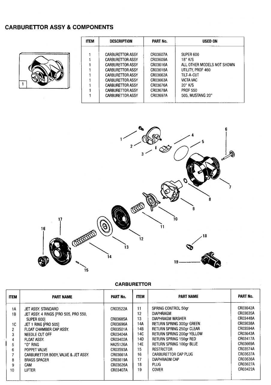

Cleaning up a powertorque carby, all going well except the end cap of the carby which has the breather hose(that connects up to engine) will not seat on the carby body. It appears to click but doesn't seat properly and comes off when a little pressure is applied. Cannot detect any warpage on either the carby body or the end cap, can you sand a little of the body away to get it to fit or is there a better way? [Linked Image]Just to clarify, talking about part 17 onto part 7.

Don't sand it at all, check the diaphragm is seating correctly. If it still doesn't stay on, consider a new cap (17)
Posts: 310
they have a propensity to warp..
Best to get new cap....
