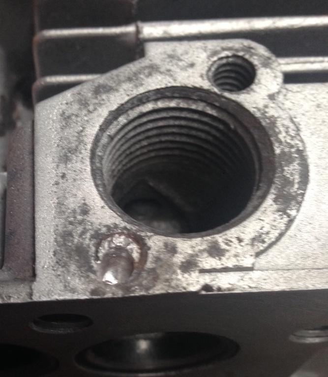

So ive been rebuilding an old briggs 3.5hm (92908). I never noticed when i stripped the motor down the muffler had only one bolt holding it on, anyway i discovered today that a bold has snapped into the cylinder. so silly me went, "well i'll just drill that and use a bolt extractor set" to fix this issue, wrong. I drilled the hole wonky and have drilled the cylinder frown
does anyone have any suggestions what i should do now?! ive been on ebay and i cant even find this part i believe its "298922"

Did you drill right through so there is a hole or did you stop before going that far? if not go and buy a round screw in type muffler and job is done.

hey, thanks for the speedy replies. im freaking out here haha. i only drilled a few mm before i realized i had moved the drill and wasnt drilling the center of the bolt. well i had already ordered a new muffler "132106-754" from the outdoorking, i was hoping to keep it original and how it was frown whats the difference between the muffler i have now and a screw in muffler you mentioned? i did wonder what the thread was for :P if i was to have it drilled out and had an insert put in to retain the muffler that was on there, where would i go to have this done like what kind of shop? a mower shop or some kind of engineering shop? im not confident anymore haha.

ok im going to pipe in now, as this might be an easy solution, it looks like youve still got some meat on the sheared off bolt, so get yourself a cold chisel, center punch, screwdriver etc, and try to unscrew it by tapping it out, it might work on the un-drilled area, the hole you drilled might come in handy to get the cold chisel in to tap it out easier

I spoke to a gentlman i used to work with who is a refrigertation technician but is quite handy with metal work. He took a small piece of right angle steel and put some holes in it and then bolted the right angle into 3 of the head bolt threads. This allowed him to hold the cylinder in his vice straight.
He then used a milling maching to put a small hole exactly where the middle of the old bolt was a few mm deep. once this was done, that hole was used as a pilot hole to drill by hand out the remainder of the hole he then used a 1/4 unc tap to retap my hole to the exact size it was.
He has done a fantastic job and you cant even tell anymore my mistake even happend and even better it cost me nothing.
Over all very happy i am able to retain my original muffler. I am thankful for all youre suggestions.
I have attached a photo of the reuslt with my nice new bolt in the hole that was ruined.
