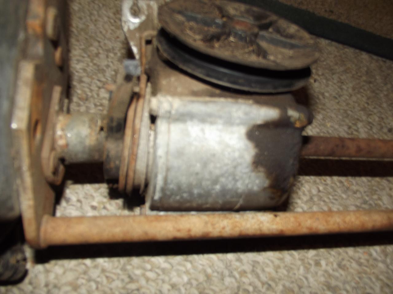

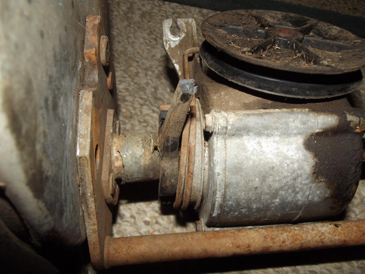

is the engagement lever always been cut like that?? do the drive dogs spin when you spin the pulley with the lever pulled forward?
(the inside of the wheels may be stripped), i haven't pulled a gearbox apart , never had to, but i have a spare, just have to make sure it's ok.
also, the belt in the top pick is not on right, check the wear on the post...

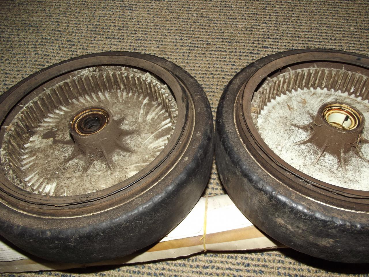

so take the wheels off and check the drive dogs, also check that the pulley is not spinning on the shaft, maybe broken roll pin?

yep drive dogs, the little wheels inside the big wheels, they fit on the end of the drive shaft , hold one of those while you spin the pulley , with the lever engaged.....to cold alright, nite sleep

it would seem that the one with the seized up cable's gearbox works, but i broke the engagement lever. got it off. worried about breaking the other one when i take it off or put it on. the drive dogs drive [Linked Image]
when i engage it and turn the pulley the drive dogs turn.
so basically i think i need to try and swap over the engagement lever and put it all back together????
