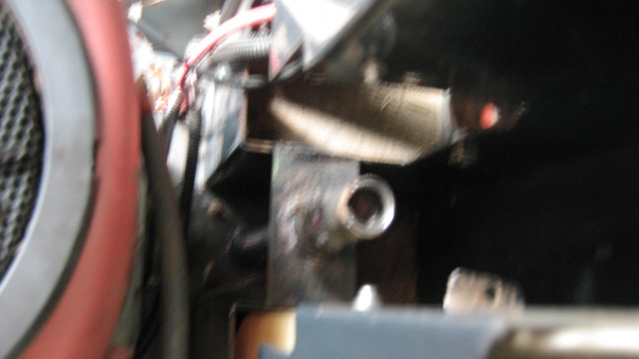

I am currently trying to repair brothers cox stockman series 3 2008-09 rideon mower any comments
or sugestions on how I can repair it .the yoke where the steering joins keeps breaking at $150 a pop
an has broken it 3 times so far.

any photos?
will help to see why & what may be altered..

Is that the one with a plastic type steering box that changes the angle from the steering wheel to the vertical shaft driving the chain

I have cut the remains of previous work done on bottom shaft .what was welded previously a universal socket which broken by the stress on steering
I have worked on white ,viking an greenfield r/mowers .all have simple steering

Damage has been done to lower steering housing at bottom from previous welding I found when manually moving wheels it was a little stiff I will check on the under side where the chain an condition .being in a confined work area where the yoke is workin on this machine is a bit hard

I have repaired cox stockman 32in cut with a socket knuckle an a bit of fancy machining making easies to replace .I told my brother it was the best I could do without using the original parts

thanks for your import I end up using a socket knuckle because of the angle involved an tight space .Its not a nice machine to work on because the fuel pump is on the same side .On the back of motor where I had to do welding Ie fuel tank an battery had to be removed as well

What sort of material is used to hold the 2 yokes together in the middle of the joint?
Maybe use a piece of old tyre? similar to the old holden steering joint.
