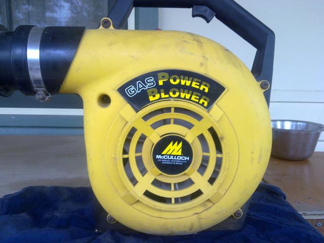

Hi all,
My neighbor gave me this Mc Culloch blower and I need a few parts for it but I can't find any model number on it.
Any ideas please.

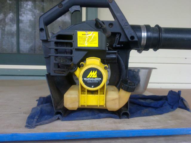

Posts: 113
Hi all, just wondering if anyone knows how to repair a plastic fuel tank. The hole that the fuel line goes through (it's on the top of the tank) is not air tight, so that when you tip the blower forward fuel runs/dribbles out. I was thinking of a rubber grommet but can't find one small enough, or a larger piece of fuel line, but then it's to big to go on the carby pipe. Thoughts?
Posts: 693
Are there two lines going to the tank, a fuel and a return? I have used a 19mm holesaw in a cordless drill to make a hole to take a standard brush cutter fuel grommet when I have had a similar problem and it worked fine.
Joined: Sep 2014
Posts: 113
No she is a golden oldie, only has the one line from the tank to the carby.
Posts: 693
So it will be like a chainsaw set up then rather than a brush cutter. Try and find a piece of fuel line that will slip neatly over the existing one and drill the hole in the tank out to be a tight fit for the larger line so that the larger line acts like a grommet.
Joined: Sep 2014
Posts: 113
Thanks aussie, that worked a treat.
