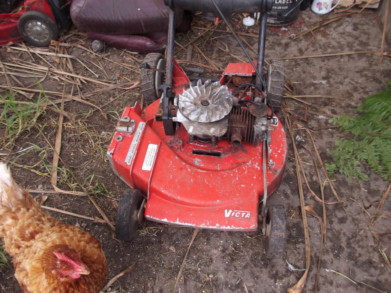

I am rebuilding one of these is there any tips.. It was siezed but moves freely now, have pulled apart and cleaned, i really want to get those back wheels turning.

Its a victa 550 full crank series 80 mk II.
motorwannabe
Yup, so that makes it an early 1980's model. The last few series of the full-crankshaft 160cc engine, with electronic ignition.
These were made from about 1980 to 1984, when the PowerTorque half-crank engine replaced the full-crank one.
That alloy deck looks like it's a 'Pro' series to me, but hopefully someone with greater late model Victa familiarity will chime in.

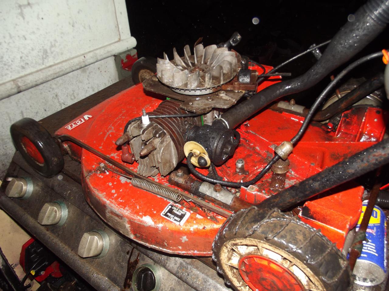

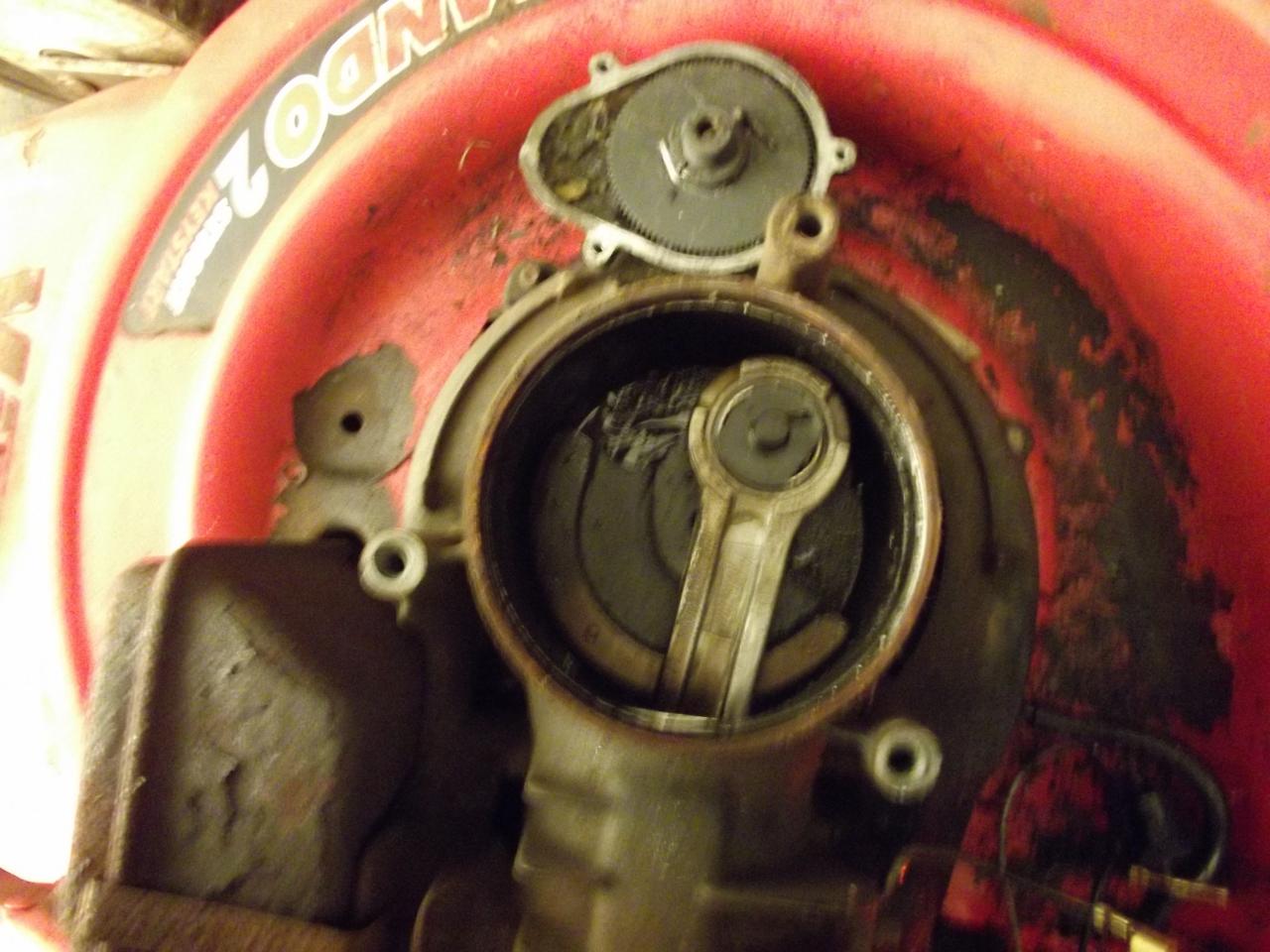

just got given this for $20 keystart commando 2. am thinking of just changing the engine with one i know works?? i think where you turn the key is stuffed.
Any ideas?? thanks

Posts: 960
Yep, there's a lot missing there. The pull starter assembly, cowl, carby, intake snorkel and most importantly the top half of the electric starter motor. It's definitely an eaasier option to replace with a known working motor than trying to get all the bits you need for that one.

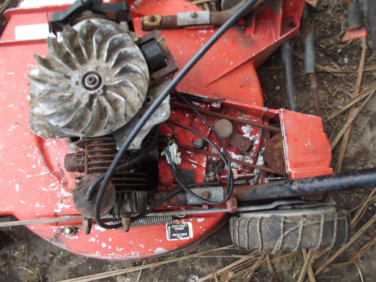

i am back to working on my series 80 rebuilt motor, has compression, dont know how the carby hooks up, has no spark, think i forgot a washer between the starter and the motor. uuummmm

one of the reasons for no spark could be the coil wire needs to go to the plug ( in front of the head) ,and not the plug you've got in the decomp hole ( the one in the top)....... two wires in the back of carb are kill switch, if their touching it wont spark, and there's no washer between the starter and motor. but they are tricky to put on if you've had it off.
