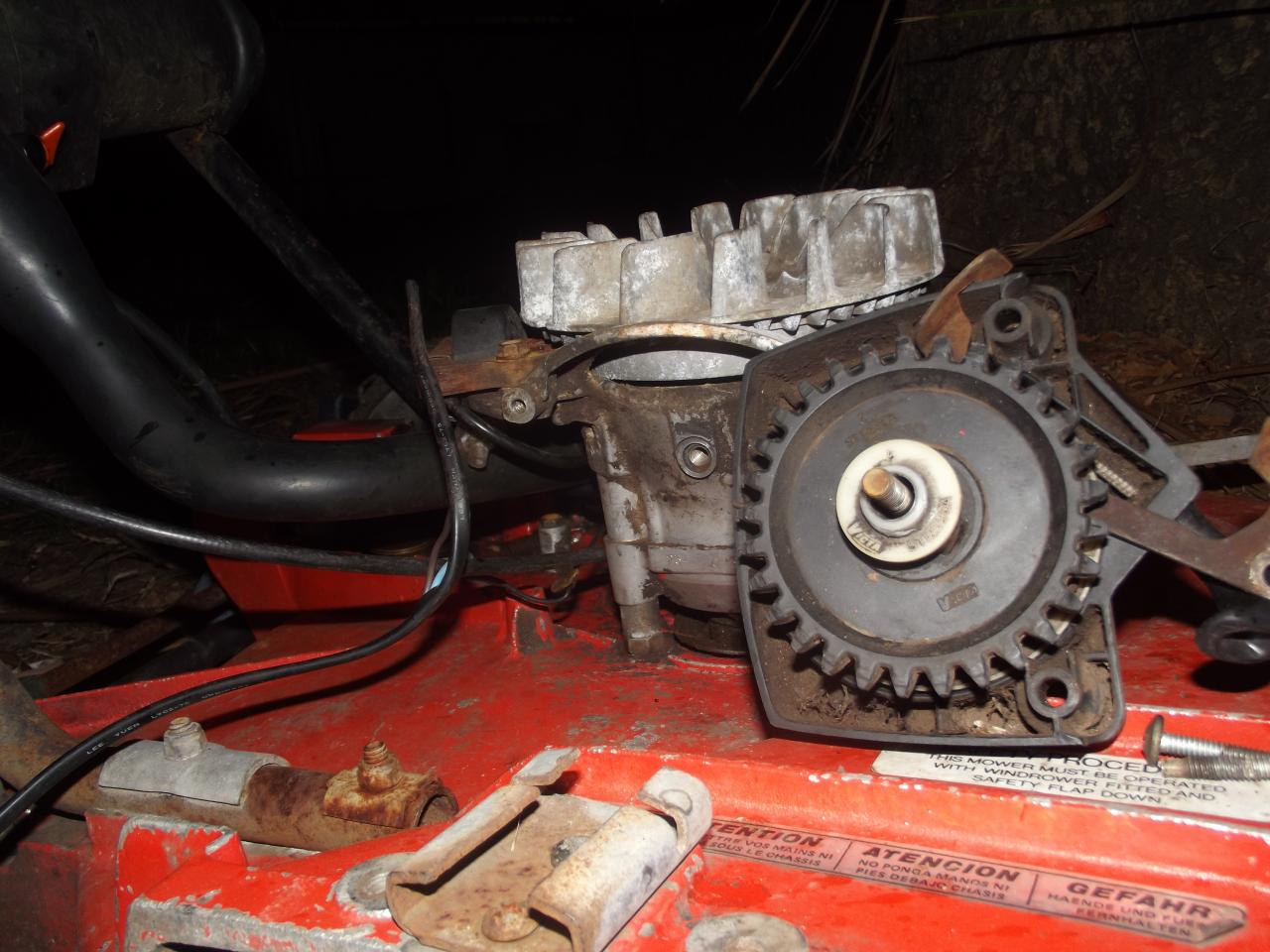

hmmm, i;m not sure how to describe the method, it goes on the reverse of taking it off, if you noticed how it was and put it back the same it should be ok, if it;s not working right then it may need explaining.

is there a washer between the plastic and the motor, where the centre bolt of the starter goes??

from memory no, you need to line up the plate on the back and put the two top screws through, fit it to the motor , making sure the spring is in the right place, then screw in the center bolt, then the top two.

i will take a pic

have to turn on my victa brain. that starter has got me. [Linked Image]
when pulled it wears the plastic
i do have all the other parts, plus more.
