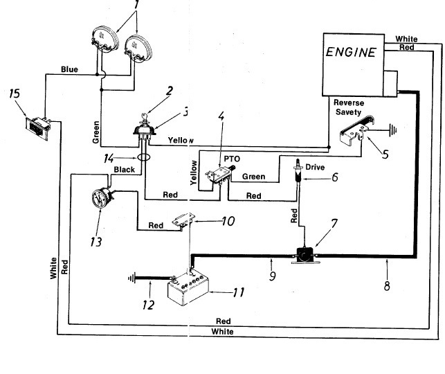

The diagrams are from a Noma_A3560 010-12HP 36inch but should give you an idea of what your looking at.

I suggest you use a resistance meter to trace the wires, comparing them with AVB's wiring diagram as you go. In Australia at least, it is very common for previous owners to have modified the wiring, often in dysfunctional ways.

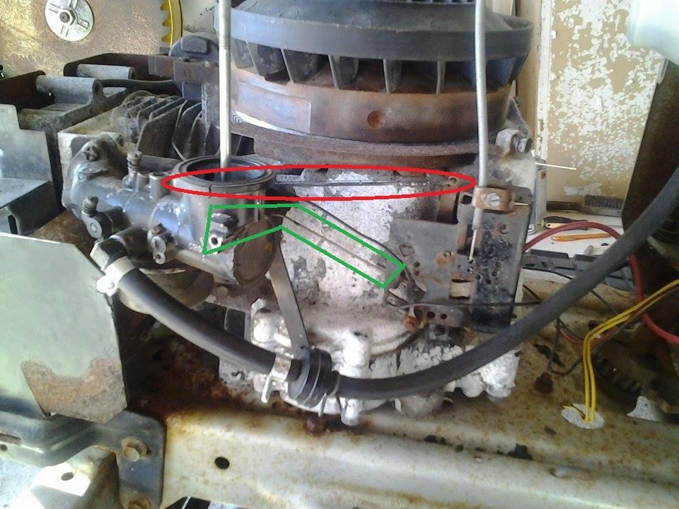

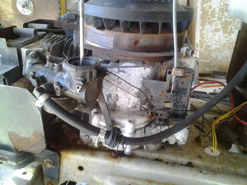

There's the photos of the throttle linkage
KimThomas #63191 02/04/15 05:17 AM
It has the standard rack-and-pinion governor plate, with wire links for throttle and choke.
The red oval shows the throttle link. The green irregular shape shows the choke link.

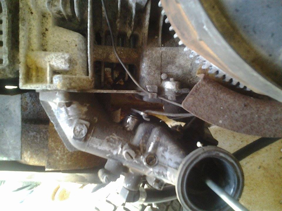

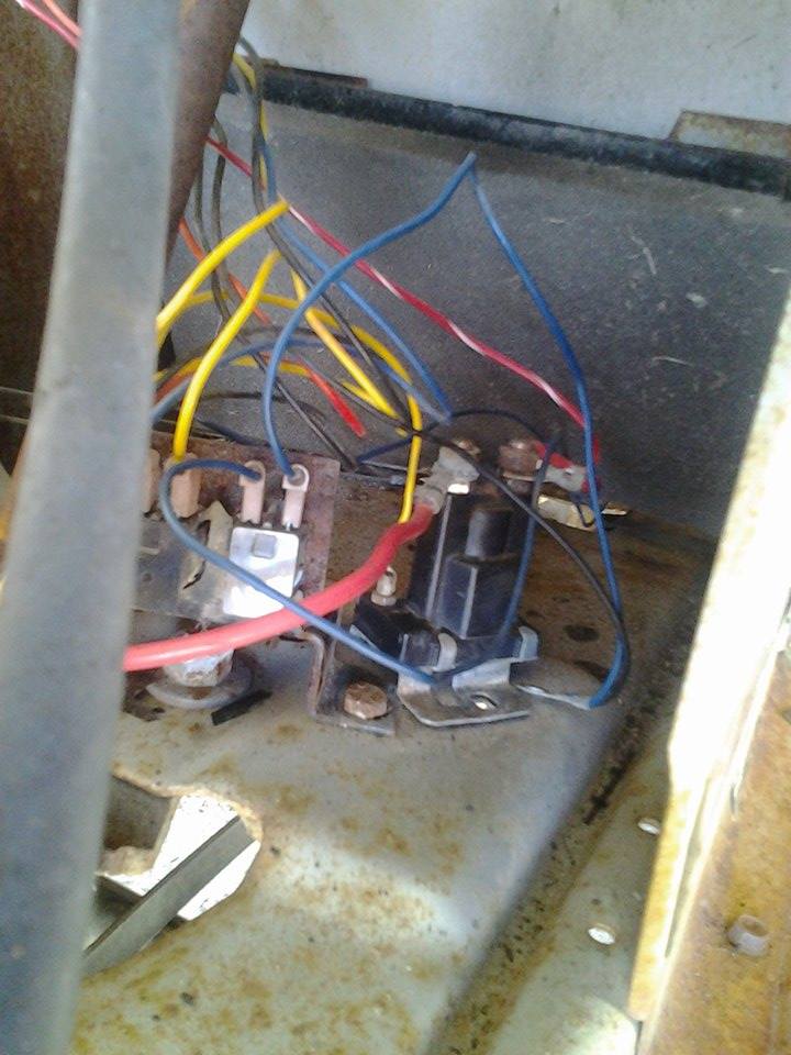

I found the discharge to stop when i took of the wire from the ammeter to the stator/magneto. So i took of the ammeter and opened it to see inside, but found nothing wrong so i put it back in and now it's not working at all.....But the drainage is gone though...
I think it might be the lead (see pic #2) that goes into the engine next to the starter motor that's the problem (is that to the alternator?) because it looks like it's been hot and changed color from red to red/black closest to the engine.
How do i find the end of it? Do i have to take off the flywheel (top of the engine) to get to the other end of it?

Both the seat switch and brake/clutch switches are "normally closed, but the PTO(?)(The right one on picture #1 with the blue wires it/out) is normally open, is that correct?
I'm so close to putting on a start button instead now, cause this is driving me crazy! :p

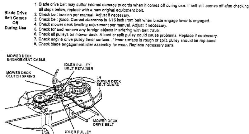

Kim, a have a feeling this deck will be close. Not a good image, but here are some reasons for the drive belt flying off.

Marc electric: you are right about that not being a good picture! But that does indeed look alot like my deck.
I found my problem to be the big bolt for the idler pulley, it has worn out the holes it goes through on the assembly making it have alot of play when engaged. Tried finding some way to fix that play, but i don't have a welder so i don't know how to fix it without bying a new assembly (which i don't have the money for).
