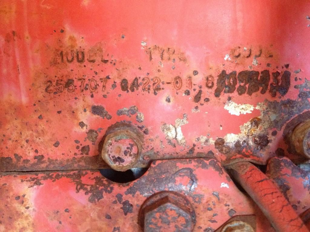

Edit - I looked up the serial on the B&S engine and nothing comes up on their website. The engine serial number is 255707-0422-01-87092431 and the chassis number is 8365 F.

Are sure it isn't 255707-0122-01?
Joined: Feb 2015
Posts: 28
Thought that myself but it certainly appears to be a 4 to me. Have a look for yourself.
[Linked Image from i1056.photobucket.com]
There is a full illustrated parts list for the Anniversary 12-32 in the Manuals section. I can't tell you how similar that is or isn't to yours, though.

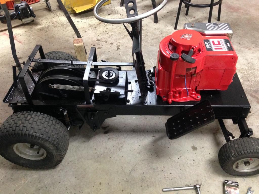

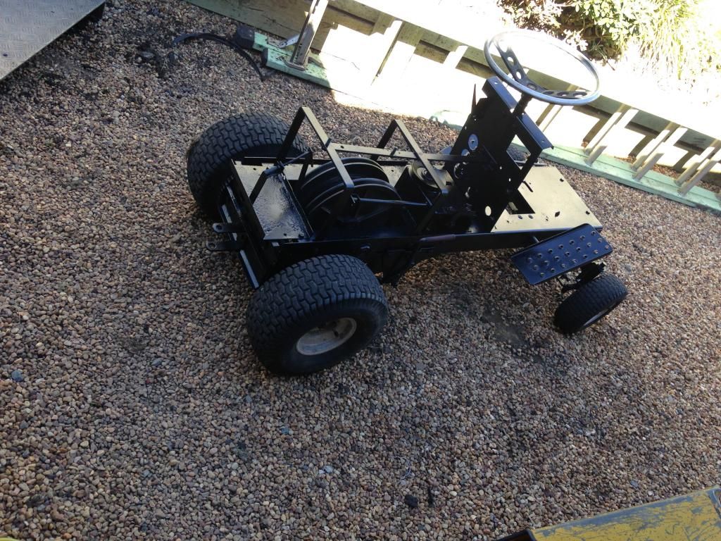

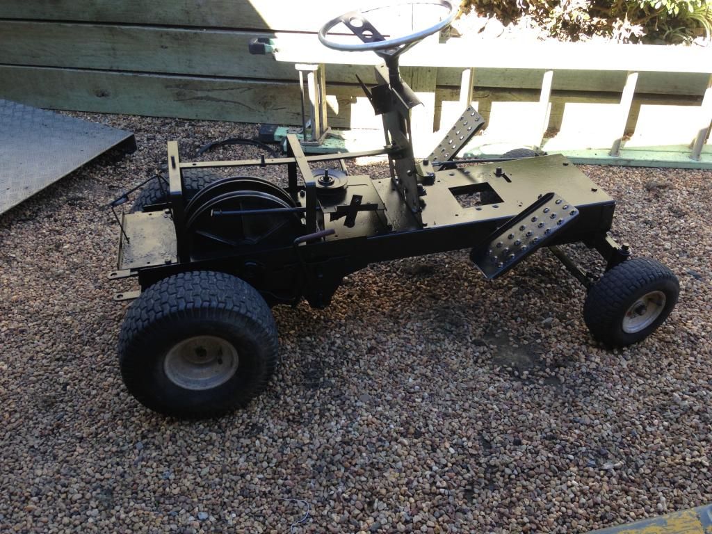

Okay so update time.
So far it's only taken me a week, and that's been purely weekends and after work in the evenings to get some work done. I've stripped the entire mower down to pieces and I mean quite literally to the very last bolt. Nothing was left assembled.
I then went through the process of working out what was stuffed and what was salvageable. All bearings were replaced as they should be on a rebuild like this so axle, clutch and all idler pulleys were either replaced or refurbed.
All components from the base chassis to pitman arms, steering rods etc were hit with a needle gun to remove as much rust as possible and all parts were painted with a red oxide coating to ensure that even after final painting any surface that is unreachable is still protected from corrosion. All bolts were cleaned, threads inspected etc and either considered good or replaced. All bushes were done with the same.
I did run into a few problems however. Seems some moron who owned or repaired this mower at some stage prior to my Inlaws owning it decided it would be in the best interests to cut, and I mean quite literally cut, the support bracket that bolts the from beam axel on, off from the reduction pulley frame. This resulted, once all back together and free moving, an extreme and I mean extreme amount of flex in the entire front end which was noticeable right through to the steering. I couldn't leave it this way so I welded it all back on.
I also found the solid bar or tie rod between both front wheels to have nearly in excess of 20mm of free play in the bushes which would allow the two steer wheels to point in almost opposite directions. Rather than make a new bar and do all the bending and slotting of the old one I just found a nut the same size as the bolts that connect the bar to the spindles, drilled it through so it was a nice slightly oversize fit for this bolt and welded it to the bar as a form of bush which has now settled the steering problem.
I've replaced the drive corks on both forwards and reverse plates, selector bearing and also shimmed to remove as much slop out of the pedal as possible. I've also adjusted the tie rod for this too so I can wind it in to adjust in future for free play. I've test run the machine and it drives great but noticed that in reverse it make a hell of a noise because the shaft wasn't fully in the right position which allowed for the drive plate to smash into the selector fork support frame when reverse was selected. I adjusted the shaft but it continued to do this so I shaved about 5mm off the upper plate to allow plenty of clearance but still do its job right. I know not necessarily the right thing to do but there was no way around this as the amount of shim that were in the clutch was the minimum I could have without the thing driving itself with no neutral.
Anyway all this work has been done, next step is to tidy up the engine and electrics, engine runs great, need to tidy up all the old grease and dirt etc and give it a lick of paint, then rebuild the cutter deck and then panel beat the guards and respray. I'm waiting to hear back from Greenfield as to wether they have a sticker set for this or any of their mowers of wether I need to get them custom made. Also if anyone wants to know I used a Dulux Red Oxide primer for all parts and the base frame was painted with Dulux Metalshield Epoxy Enamel in gloss black and I'll be using the same for the exterior and deck also. A very easy one part paint to use, I don't use thinners to spray so it went on rather thick which allowed me to get enough paint into seams and panel joins to seal up to mitigate water ingress. Very happy with the results from this enamel paint. I would normally use a 2 pac paint like Dulux Durebuild for anything that's out in the weather or submerged but for an enamel this paint is pretty [Censored] close to what I expect of the Durebuild so far.
Anyway here's some pics. I didn't quite photograph the whole venture but I'm sure you get the idea.
An interesting project Sparky, and well worth-while if you are keeping the mower for your own use.
I didn't really follow what was wrong with the drive clutch mechanism causing you to turn some of the clutch plate off to get clearance, so I can't say there was a better way, but I hope there was: that is pretty desperate stuff.

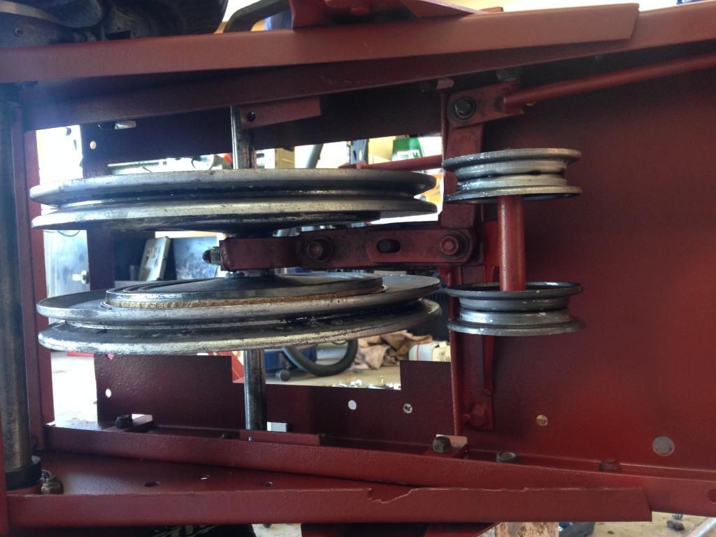

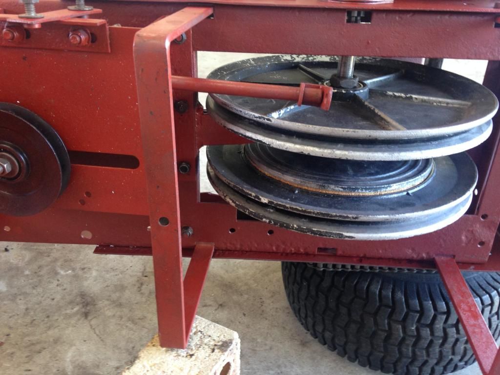

Grumpy, It was a fairly desperate move i'll tell you!! To have to take a 5" grinder to something that should never change is definately desperate!
The problem was as the drive plates slid over to engage the forwards driven plate, the reverse drive plate on the backside, so the face that is on the selector bearing side, was smashing into the support frame for the selector fork. It still drove fine but it would just make this loud smashing noise which no one would put up with. If I removed or added anymore shims to the clutch pack it would have been far too sloppy on the pedal for anyones liking and the cork liners would have been engaged almost constantly and just prematurely wear down. I could have spun the drive plates up in the lathe but I really couldn't be bothered making a mandrel to suit the square shaft!!
Hopefully this picture shows you what I cut back. It hasn't and won't affect the structural integrity of anything so i'm not overly concerned that I had to cut it back.

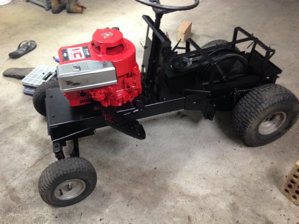

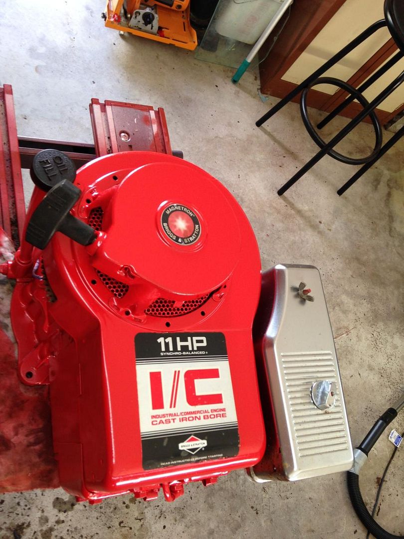

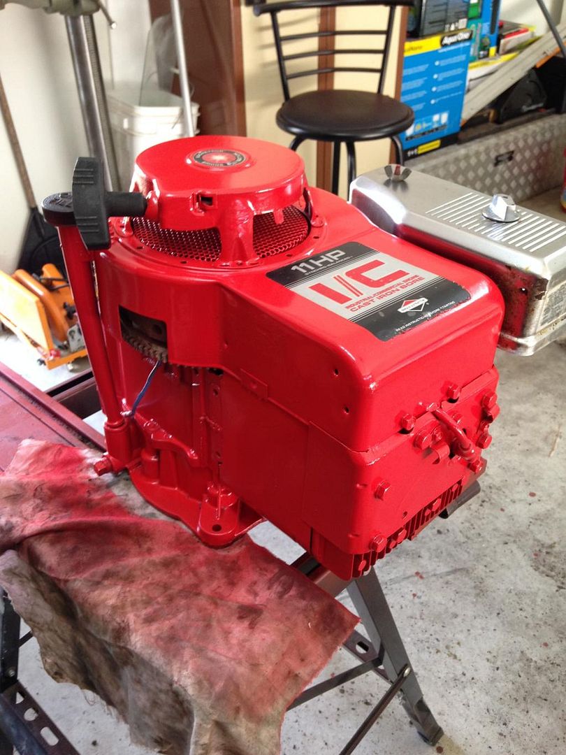

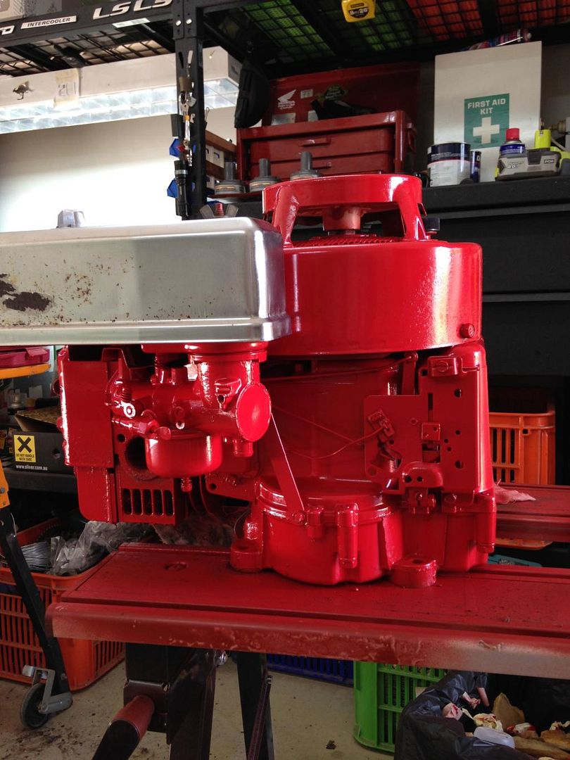

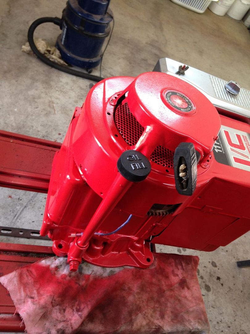

So while i'm at it i'll do another quick update. I've got the engine 90% refurbished, a decent coat of paint in Dulux Metalsheild QD enamel in Signal Red. Looked the closest to an original B&S red that I could find. Just have the fuel tank straps and the starter motor to do and the engine is done. The plastic throwout gear on the starter motor is stripped badly so i'll have to chase a new one of those. Also when I was removing the covers on the engine to remove all the old wildlife and dirt from within I noticed the positive wire from the alternator/generator had deteriorated and been shorting out on the crankcase. So I removed the flywheel and the generator and repaired the wiring, cleaned and reassembled all of it. Also gave the generator a quick coat of Isonel Clear spray varnish just to give it that bit of extra protection on the coils.
I've now got the engine bolted back down onto the chassis and thats the last time it comes off!! Unless it fails or whatever. Fixed my handbrake after I found a few pics of some machines on here to see what was required. So hopefully tomorrow i'll attack some of the guards and get some new paint on those. I've stuck with the Dulux Metalshield Epoxy Enamel for the body and chosen Golden Yellow for the color. Seems to be the closest I can find to original color in that range. I emailed Greenfield to see if they had any stickers available at all to replace the important ones such as cutter in/out, E Brake etc but got given a rather rude response and told very bluntly no theres nothing. So i'll take photos of the ones that are left and see if I can get them made somewhere.
Anyway heres some photos. Enjoy.
I agree that if you haven't taken much off, it should do no harm, but it must be the result of wear or a missing part along that clutch axle, between the two disks.
That machine is coming along nicely: congratulations.

Fully agree with you Grumpy, you should never have to cut material off to allow things to clear. I did look into what parts had too much wear etc but couldnt easily track it down.
At this point I don't see why you couldn't just put spacers between the disks and the clutch thrust bearing, then back off the nuts on the ends of the shaft to suit. I don't see why that would affect size of the correct shim stacks, since it allows both plates of each clutch to move outward. No doubt Gadge will sort me out if I'm full of prunes on this.

True, but I'd exhausted all my shims taking up the slack.
I also believe that this support bracket for the drive idler pullers and the selector fork has also been repaired at some stage. So whoever repaired it welded on a price of steel larger than the original thus reducing the amount of clearance. I believe this is more the case than any sort of misalignment because the plate was actually welded on crooked not straight.
I noticed the crooked welding - it was the main reason I didn't feel badly about you grinding the sides of the bracket.

All good grumpy, good to throw other ideas out there as to what may have been the cause, makes me think about looking at other components but once I noticed the average crooked weld I knew what was wrong. I'm no expert welder but I can weld fairly straight so lead me to believe that it was a novice or a repair shop that didn't want to spend much time on it. The mower was originally bought by my I laws second hand for $800 from an agricultural dealership and I've seen this particular stores repair work first hand so I'm fairly certain they fixed it.

The nuts pull the inner races in the clutch pulley bearings hard against the drive shaft shoulders I think, grumpy. So it wouldn't just be a matter of backing the nuts off; shims between the shoulders and races would be needed. I'd say equal shim thickness on both sides would be necessary, too. Then the clutch discs would need to be shimmed, to suit the wider pulley spacing.
I think he feels he has his shim stacks right at this point Gadge, he just had the inner faces of both clutches hitting the clutch thrust bearing bracket on both sides. He ground away the bracket, which should be fine (it looks as if it had been modified, which seems to have caused the problem) but I'd suggested as an alternative, he could have left the shim stacks as they were, put spacers between the clutch thrust bearing and the clutch hubs on both sides, and just clamped up the nuts on that entire stack. The clutches would have been further away from each other, due to the spacers, but there should have been no change in the clutch clearances I think, because the shim stacks would not have been changed.
Yep, another 'previous tenant improvement' there. And the grinder was the appropriate solution. cool
