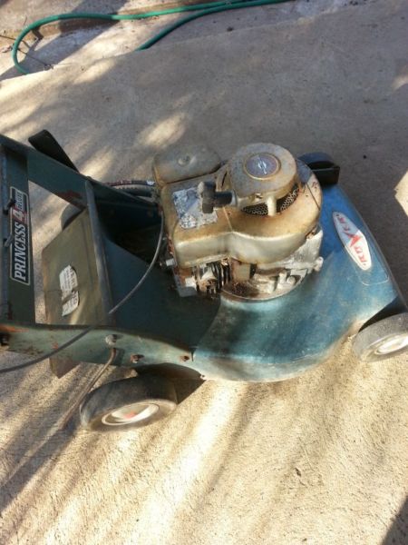

Here' a Rover Princess I found
A princess, cool...looks pretty early. See if you can pick up an auto drive too...How much is this one?
Not necessarily, was just a suggestion for preservation really. Cost to the right person if the cap is correct auto 50-80$... not millions, more a case of some love originality. Things are slow now but ive seen good caps go as high as 80$, at the moment unless they are mint they run around 30-50$. Your cap should be Victa marked Black, so to sell the cap for something you need is an option, just see what they are selling for after January.

Posts: 83
he wants $90 hasnt ran 4 a few years he says
going to check it out tomorrow arvo with any luck ill bring it home then will hunt for the vortex
