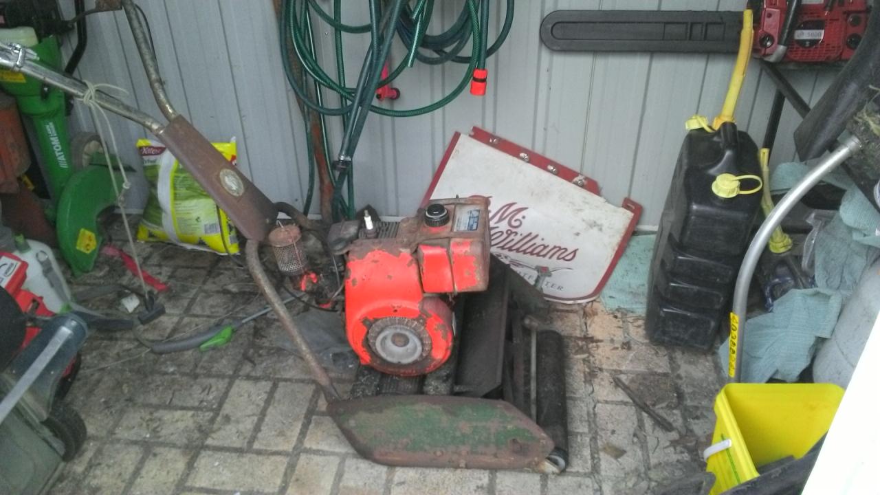

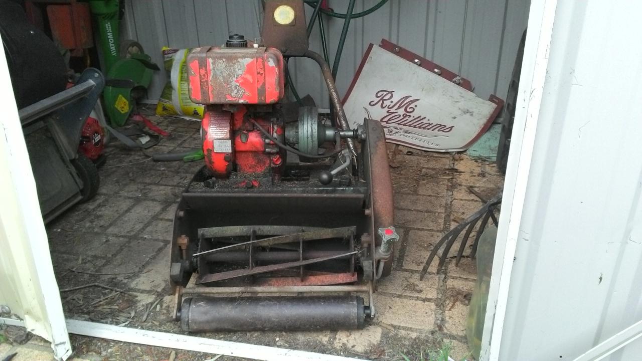

I recently picked this model 45 up for next to nothing with original purchase receipts from 1964!. This is one of the first I've played with that has a Kirby motor on it.
I'd love to know how anyone has gone getting parts for the motors.
The reel is in perfect nick, doesn't cut too bad. Hopefully it will get a full resto once I have a shed to do it in.
Cheers smile
Sorry if I posted in the wrong spot

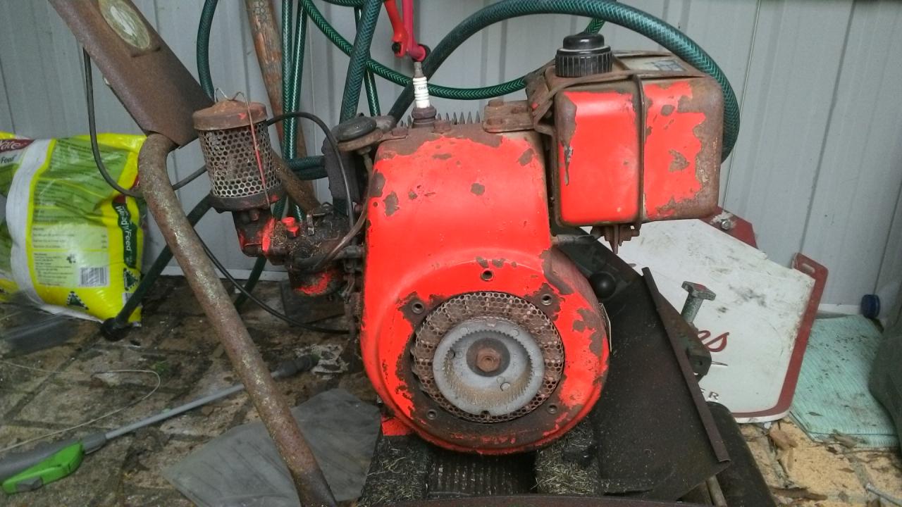

Hi Gizmo, and great to see you back at OutdoorKing mate. grin
What you have there is a Series 2 (twin rail) engine deck machine ( that is erected after December 1975) and is a 14" cutting width, with the Kirby Lauson (Tecumseh) engine fitted.
As you would know, Tecumseh has gone down the gurgler, and parts for the Kirby's are very thin on the ground...but, some members have been having success getting parts from USA...they aren't cheap with the exchange rate of the Aussie dollar...but it all depends on what parts you are chasing and how much you are prepared to spend on the restoration. wink
Gizmo, you have posted in the correct area, as you intend to restore the machine. grin

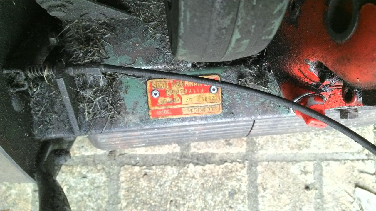

But that's still not correct as the twin railers didn't come off the line until December 1975 and your machine is definitely a twin railer, so either someone's made a blue on the receipt with the date or it's still not for that machine. Check the number on the ID plate and see if it matches the one on the receipt as this is somewhat confusing.
BB

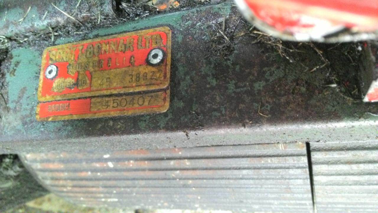

Hi BB, both Jack and I came to the same conclusion, we need a good clear close-up pic of the fitted ID Plate to this machine and compare the serial numbers....

Heres some pictures of the id plate. This might thin out the plot a bit maybe! [Linked Image]
Hi Jack, DeeJay and Gizmo along with all ODK members interested in this one,
Well That's really tossed 5 cats in with the 2 pigeons !
Either there has been a blatant mistake made on that receipt or our idea of twin railers coming in around December 1975 has to be re-investigated as that twin brass plate indicates that its a very early twin railer.
I personally always thought that single decks went out before 1975, but DeeJay has spent countless hours on working out the date estimation. The only thing I might propose is that twin railers were first introduced in the 14 inch machines and later carried over to the larger units.

Well as they say in the classics...I'll be buttered on both sides....Here is the proof that proves that the twin railer machines were produced as early as 1973....
I have been researching Scott Bonnar history, trying to make sense of the Serial numbers and Model numbers, since 2005...almost 10 years, and this is the first time that I have be shown absolute proof of a date earlier than December 1975 of a twin railer...albeit a 14" machine which seem to have a history all of their own....eg. they started life as a solid decker with a 2.5HP Briggs (Silver/Grey Colour) and then reverted to KirbyLauson/Tecumseh engines....My question is ...WHY?
As BB has suggested, were the 14" machines the very first twin railers, maybe as a prototype, for the 17" and 20" twin railers to come in December 1975???
My world has now gone a little topsy turvey because of this revelation,,,,but, I love been proven wrong, because this is how we gain knowledge and learn new things on this wonderful forum, OutdoorKing.
I can't believe that in 10 years...someone, until Gizmo came along with this exciting find;...could not have said..."You are out by 2 years" on your date of the introduction of the twin rail Scotty.....It beggars belief!
