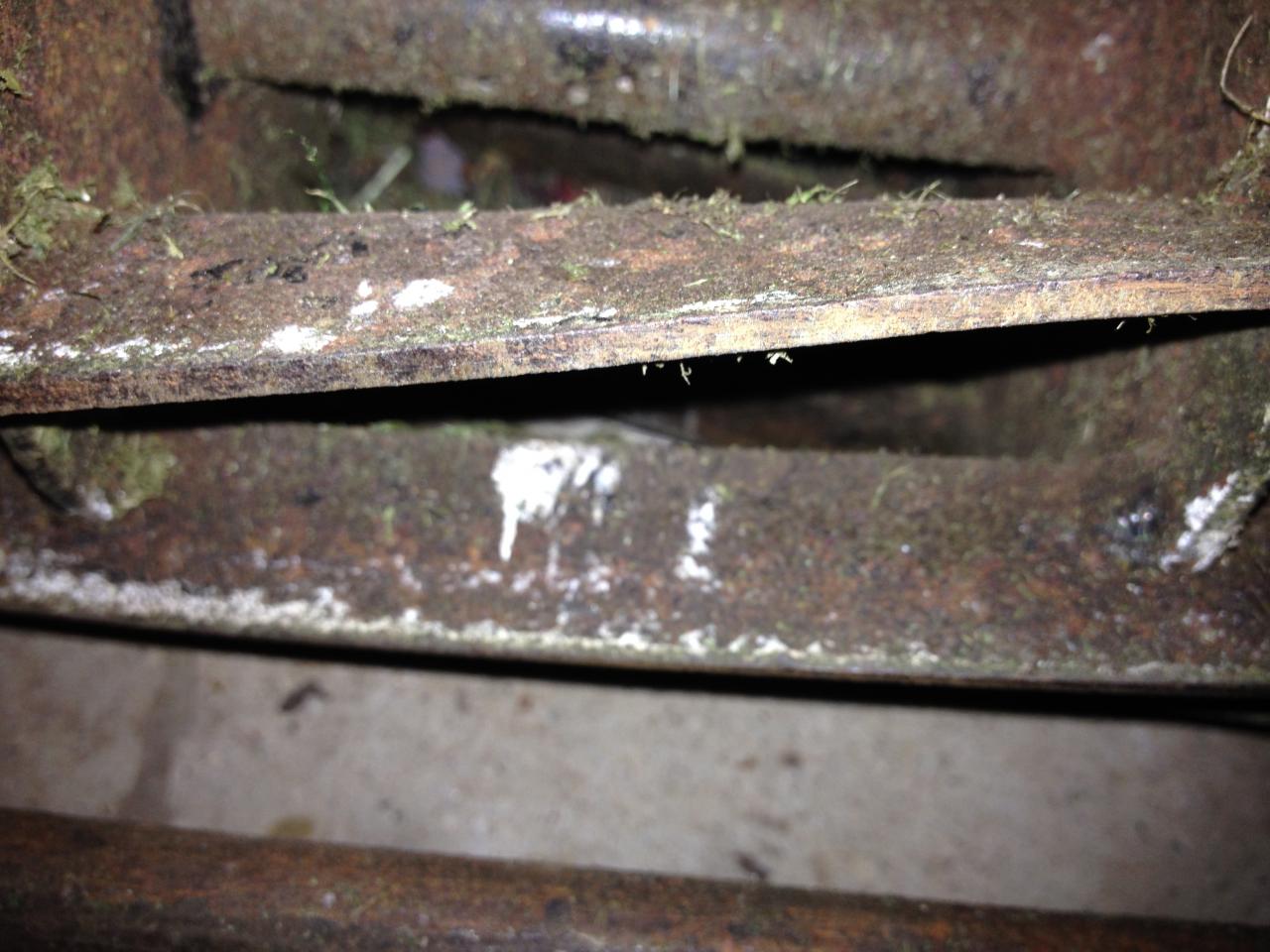

Now firstly you say that the reel was sharpened around a year ago,
well I guess we need to know and this is not about laying blame, but more so to get an understanding of what has been done before we proceed with giving any advice.
1, was the whole job done by a lawn mower shop and was the bed knife replaced and sharpened at the same time, if so then I feel you just might have an adjustment issue which will be easily rectified as having two thicknesses of paper between the reel and bottom blade is not desirable.
The adjustment should be done in such a way that the reel is initially just touching the bottom blade and then backed off so that the reel just and I mean just clears the bed knife without touching it at all.

As far as the reel clearance is concerned I would first try to close up the gap between the reel and bed knife and see what result you get from that. It looks like the bed knife was changed not too long ago but whether it was machined prior to fitment I can't see at that angle of your photo. See if you can provide us with a photo looking at the top leading edge of the bed knife and we'll get a better idea.

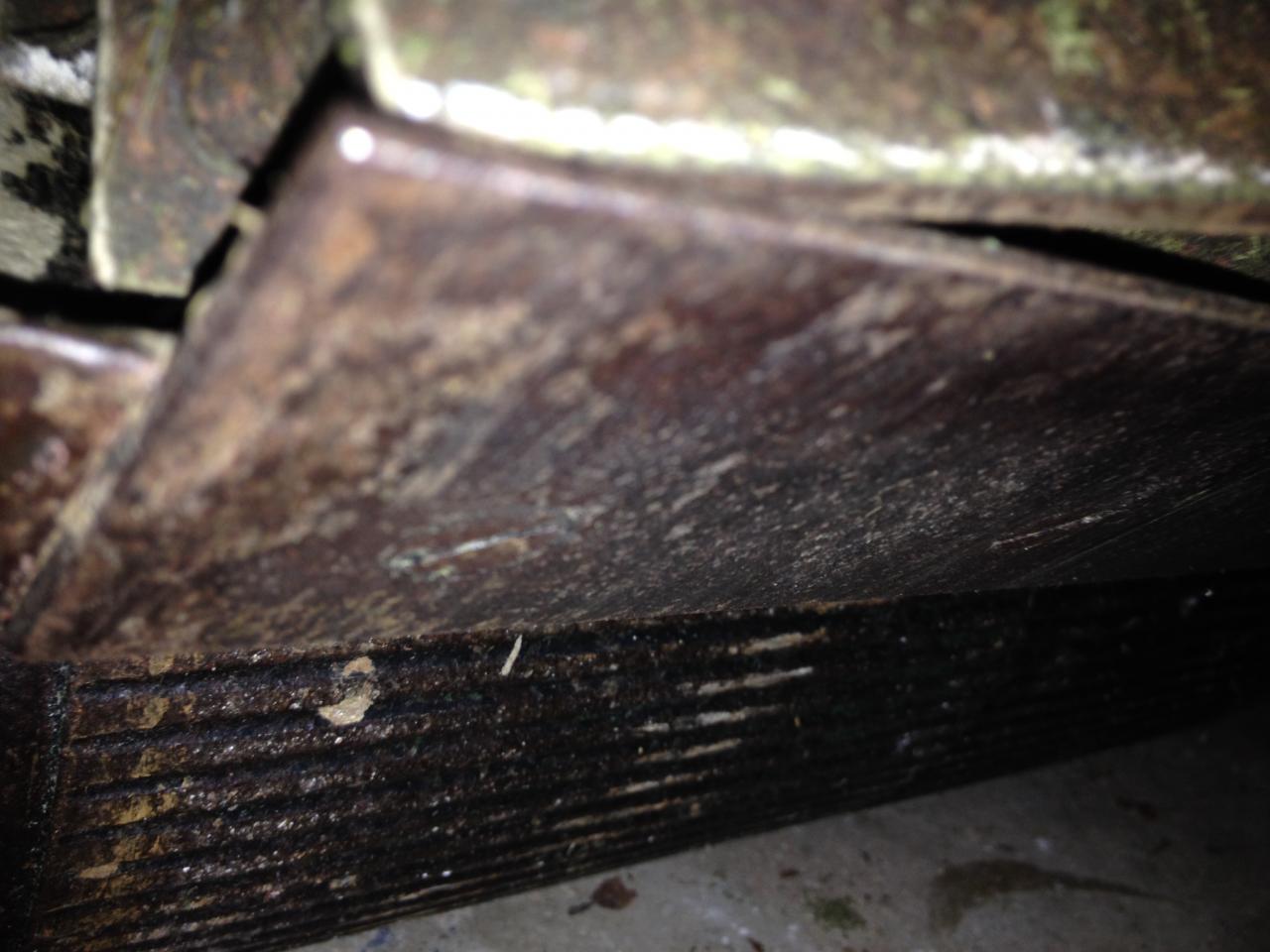

I have tried to take a photo of the top leading edge of the bedknife, but not easy to get at.

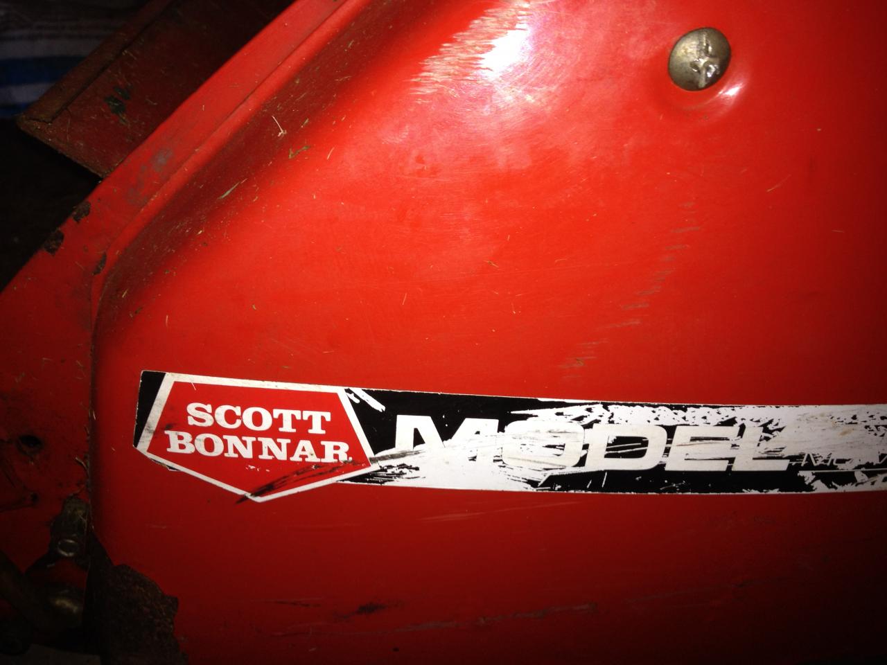

It came with Scott Bonnar stickers, how can you tell it is a Rover?

From what I can see I think that the shop has merely just put a new bottom blade on without machining it, thus it doesn't mate up correctly with the blades on the reel. They have therefore adjusted the reel to not touch the bed knife and in places that clearance will be more than in other spots as the sole plate will more than likely have a slight bow in it. Common cop out by bad shops just taking money for nothing.

I'm just wondering who's done the previous resto on this machine as Rovers came out in Rover Red and Kermit Green and Scott Bonnars were all Hammertone Green.
If you could show us the ID plate on the LHS of the chassis this will clear up what machine chassis this might be.

Hi Tim62A, and a warm welcome to the forum.It's great to have another SB/Rover 45 owner on board, as we all like to learn new things and tinker here. grin
I must agree with BB here, this machine, without any evidence to the contrary, presents as a Rover 45, with its powder-coated Rover Red chassis. But, as we have seen here before, it could be a "wolf in sheep's clothing" and in fact maybe a genuine Scotty Model 45 tizzied up to resemble a Rover 45 by a previous tenant...
The ID tag (if fitted, or holes in the rear chassis rail) will give us a clear ID of what it is.
One can easily attach by nut and bolt the catcher rubbers, and repro decals are easily had, but we will get to the bottom of it for you. wink
If it is a Rover, the handle bar shield plate should be painted Rover red as well....you could, (if necessary), check underneath the decal, to see what colour is present. wink
