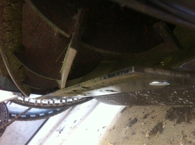

Hi again. Had my 14 inch sharpened a couple if weeks ago at a local mower shop. At the same time they replaced the bottom blade.
In my opinion the roller doesn't seem to be very sharp. How sharp should it be? Should it be capable of cutting my finger like a knife would?
Should the bottom blade have any sort of edge ground on it ?
Cheers Tony. [Linked Image]

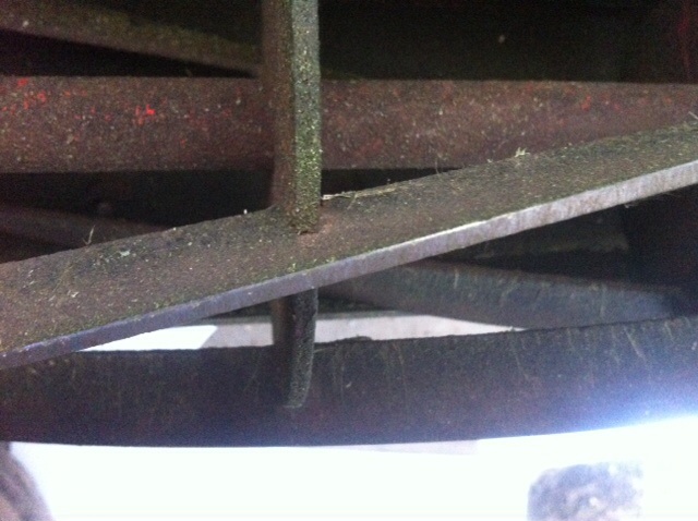

Not to keen to run my finger over the blade to test it just in case but I still suspect it is not as sharp as it should be. Just finished mowing the lawn and it seems to be tearing rather than cutting. I'm really quite disappointed considering how much it all cost to get sharpened. Think I'll give the mower shop a call and see what they say.

After having another look at you photo of the bed knife and the reel it looks like there's a bit of a gap between the two parts due to the dark shadow I can see where the coming together of the two components meet. I think that the reel should be a tad closer to the bed knife. I would adjust it until the two make contact then back it off just enough until the reel no longer touches the bed knife.

Thank you very much for your input. Very interesting and informative. You have certainly helped to increase my knowledge. The shop that sharpened my blades is happy to have another look at the mower and now I feel more confident talking to them thanks to you.
It appears that the new bottom blade needs some work. The reel is touching the blade at each end but clearing it in the middle. My straight edge also indicates it has a hump in it.

Just a quick one on this subject, I'm wondering if the blade was sharpened off the sole plate then fitted back onto to it, thus this would most certainly explain the bow in the blade.
The Bedknife should always be sharpened while firmly mounted on to the soleplate assembly, then fitted back into the mower.

I don't think the bottom blade was sharpened at all. Just put straight on to the soleplate which no doubt is not straight anymore. Anyway I dropped it back at the mower shop yesterday. Hopefully they will get it right this time. I'll let you know how I get on.

From what I can see the cylinder reel does not look like it has been sharpened at all...the new bottom blade (bedknife) still has new paint on it and has not been faced and ground...and the new bedknife screws have not been counter-sunk correctly and are sitting proud of the bedknife which is unacceptable...all round, very shoddy work mate.
We can help you get it sorted, without taking it to a workshop, if you wish....you can do it yourself with our help.
