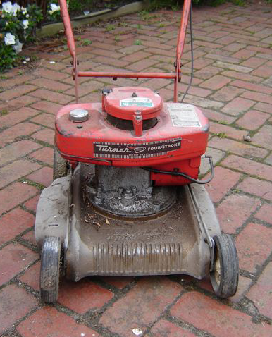

Hey guys,
Usually you cant shut me up,But right this minute I have just one word...HELLLLLP!
The Minister For War" (Wifey) Has charged me with the restoration of her Grandfathers mower...Sighs* Erm...I mean YAY!
Basically she wants to restore it for her mother at her fathers request,because she has very little of her father,who passed many years back. She used to follow him around mowing when she was younger and it was passed to her when she moved into her first home...yup there first mower.
Anyways all the mods you see in the images are the grandfathers handywork...custom tank early b&s engine,a cowl ive never seen,unknown front wheels and notched sure start cup for easy rope starting lols.
Anyways they want it restored as is...Gulps. As it was her Gfs handy work....
So ill get some decent front wheels and restore the rest. The b&s ive no idea of,ive heard of a 1300 but parts? the rest is easy.
So I have 2 options repair restore this engine or find a Vk30,which im sure will be different and they want to use the same cowl set up.....
The correct Model
So i guess what im asking is what can be done with the engine? and what are everyones thoughts as an alternative using the same parts as you see them now.
its a model f62 turner engine no is B 1300 230726.
HT6 #55160 17/04/14 08:39 PM
Hi Mal,
Are you sure that is a Briggs engine, it looks suspiciously like a Kirby Lauson. wink
HT6 #55161 17/04/14 08:54 PM
Certainly does, in fact the whole mower looks just like one I used to have (and hate). Seems as if someone carefully sandblasted the entire engine specification off the Kirby Lauson ID plate on the front, probably to avoid the embarrassment of having it identified. Personally I felt more inclined to apply a lighted match to the fuel tank of mine.
Seems like Mal has found a genuinely appropriate use for it, though. Make it a static exhibit for nostalgic display purposes only. Yay! Wish I'd thought of that when I had mine. I could have sat there every evening throwing food at it.
HT6 #55162 17/04/14 09:49 PM
HT6
Offline
Yep your right Deejay and grumpy....And no I wasnt sure,hence my reason for sucking you both into my Nightmare! Mwaaahaaaa....I had seen reference to B1300 somewhere ages ago and thought it said it was for an early briggs. I found the original engine in the boat load of parts that came with it. its a kirby Lauson LAV 30. What threw me was the cowl,Its clearly not from this mower and looks very suspiciously like a pace fittment,but who cares,as it appears correct now. The original engine is plain silver/alloy,not red is the only diff. There are also new rings,a tin full of gaskets,engine and carby and a starter and cowl assy off a Victa Corvette 4 Vk30,so i can pinch the starter from it. Ok so I guess im all set to Put a bomb under it! Yay!!!!
Thanks guys,problem pretty much solved...now where to get 2 new front wheels and a correct cowl assy? If of course they want it back to original specs,and it will be accurate.
When I look at the original model image It might actually be a 2 piece system with my cowl being the under and the Tank/cowl assy in the image may actually sit on top, as the rear of my cowl has a plate with 2 holes that the uper cowl might bolt to..hmmmm.......

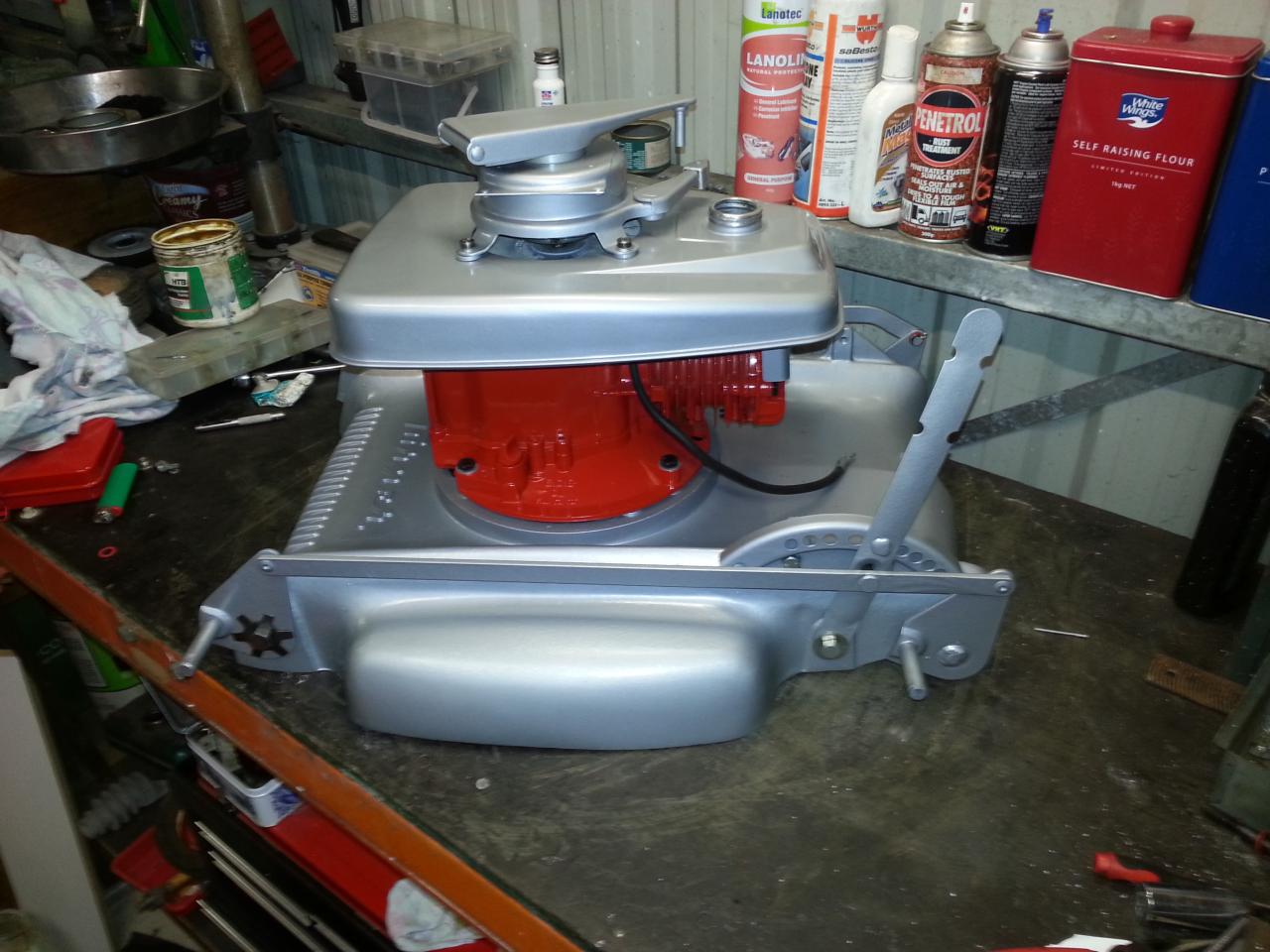

HT6 #58923 31/10/14 03:25 AM
HT6
Offline

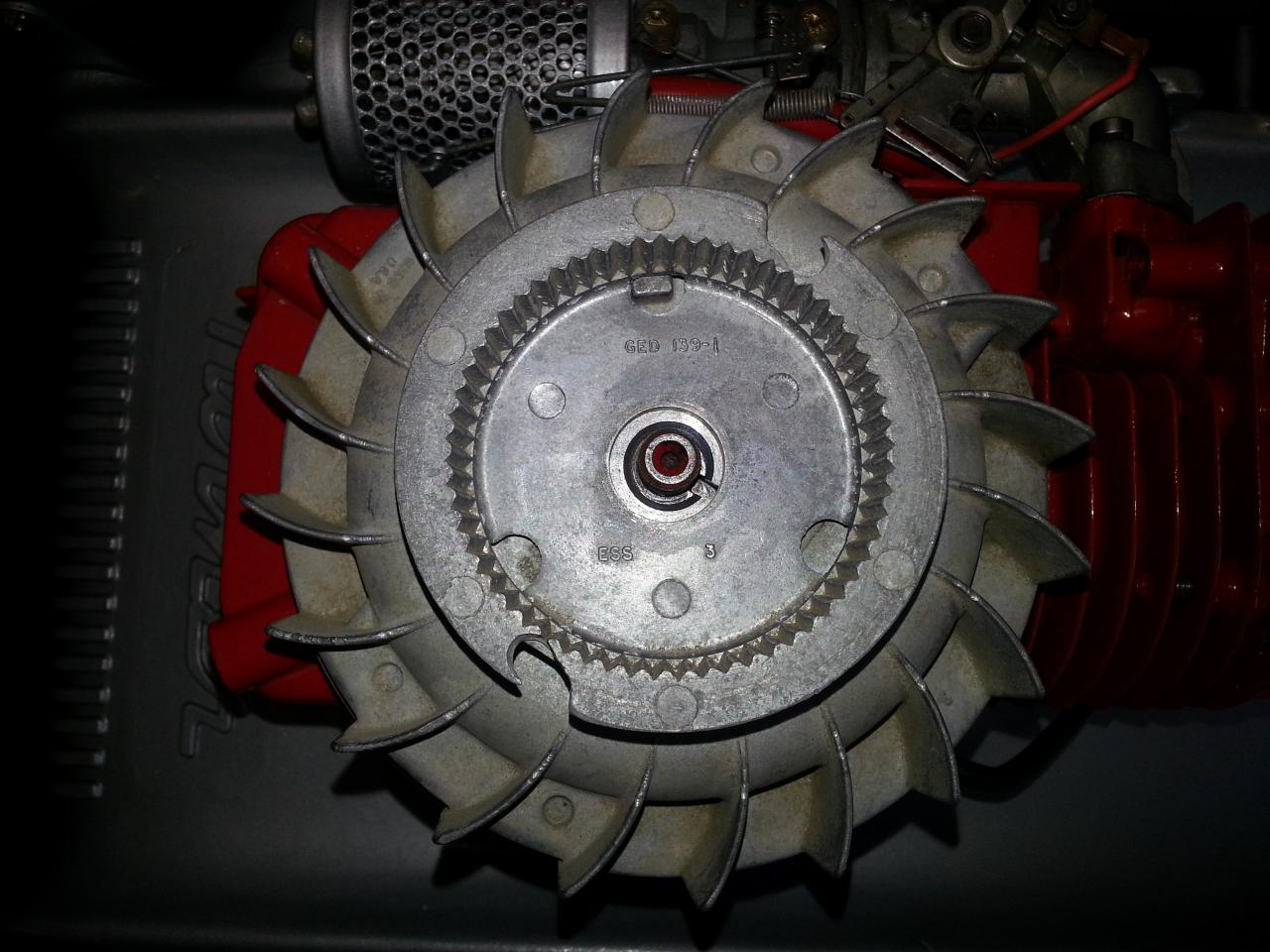

Some progress pics of Frankenturner" Or the mower from hell! What began as a simple resto turned quickly into a timeless parts hunt...Anyways its for a good cause so its been worth the effort.
Reassembling now and not far of completion. Still need 2 front wheels and a starter cup. An origonal cowl could not be sourced nor have I ever seen one. Ive opted for a victa corvette with the header removed as its closest to original styling. So its now become Victurner" all other parts are original Turner".
If Anyone has any decent wheels or std victa impulse starter cup please let me know as I need this finished for grands bday. [Linked Image]
These are images front and rear off the wheels im after and starter cup I require.

Looking good awesome work, the Victa cowl does not look out of place..May have some wheels your looking for just have to get hold of you on the ph.
HT6 #58932 31/10/14 07:49 AM
Likes: 323
Hi Bluegmhtmonaro and ODK members,
This is another stunning restoration.
I have come upon this one late, but I do understand the Frankenstein ref.
Of course, Frankenstein was the doctor - not the monster ... so that's a good sign crazy
Mal, could you tell me the width of cut of this machine?
I say this because it is possible that this machine is a F61,
assuming that the short motor is the original red.
[This would mean that the cowl would be easy to find].
If you're going for the trip-release starter, then the drum in the pic. would be incorrect.
You would require the drum with less teeth.
May I also say that this is not an un-hansome machine. It's no monster ... now.
You have, like a fine surgeon, brought this machine back to life.
A few more bits and it will be ALIVE![no electrical storm needed].
p.s. this base is a very good one. I love the twin crank arms connecting
the head to the torso. on the height adjuster. A very close version of this base
was used on the very rare Australian Qualcast rotary of this period.
Qualcast didn't copy Turner: they both used the same supplier.
Great Work Mal. Or is it ... Herr Doktor [insert lightning here].
All very monstrous.
JACK.

Thanks Guys,
And yes it was Frankensteins monster I was refering to,but Frankensteinsmonsterturner just doesnt work.
Yes Jack your right:) in my decision to steer away from the Original Sure Start 12d,due to insufficient parts,Id neglected to note the cup,it never crossed my mind until you mentioned it...Thanks I have the correct cup in spares.
What must be kept in mind is the availability of parts for early Turner.
Yes it is definitely an F62. If you read the post I had to use 3 engines to make a viable unit. The original engine is grey as per F62 but the red version had the best block overall. The grey needing helicoiling and a terminal bore.
As for the cowl being an easy find...Id have to disagree. The engine cowl on the first image is actually original. The F61 and 62 used this cowl then the sure start 12d then over the top was fitted a secondary cowl assy which held the tank. This upper cowl is what I referred to as an impossible find. Unlike most mowers that run a single tank/cowl assy,rhis is all but unique in the fact it has 2. Ive never seen another Turner of this model let alone parts. So...all this led to the decision to use a modified Victa corvette cowl assy,which also arent all to common in 4 stroke form.
So ive made the best of whats available while trying to keep the Turner Styling".
Thanks guys for the info and imput
Regards Mal.

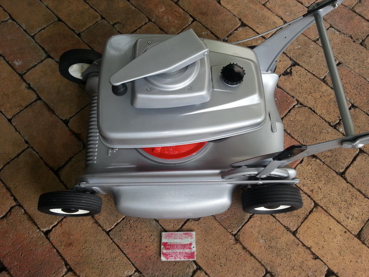

HT6 #59675 25/11/14 10:56 PM
HT6
Offline

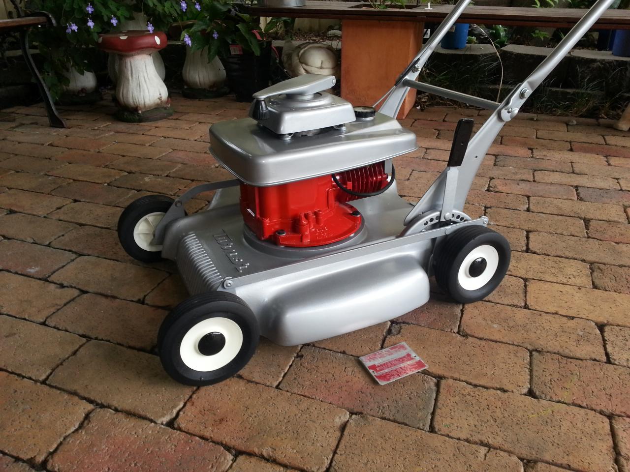

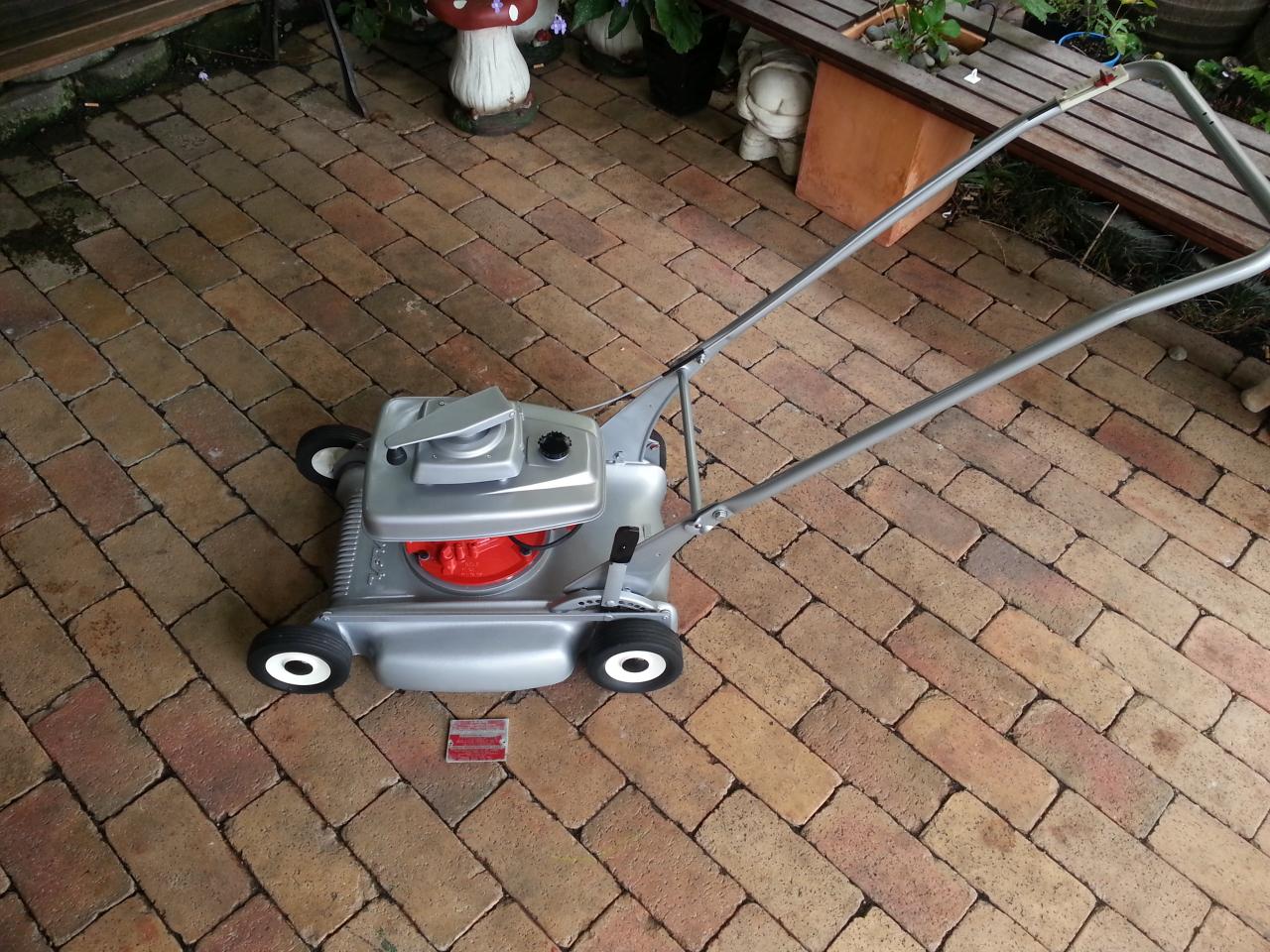

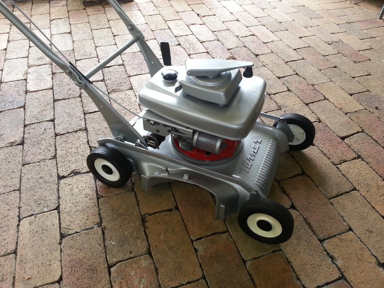

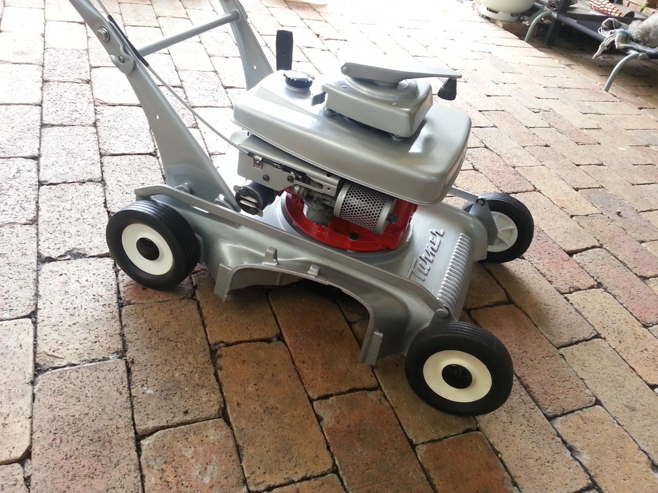

Finally able to log in long enough to post some Images...
Frankenturner is All complete and ready to run.
Need to clamp the fuel line and get a metal cap.
End result is an F62 Turner Deluxe 4 running a victa Corvette cowl and starter assy. All other parts for reference are Correct for this model.
A big thanks to ODK member Chris125 for supplying the correct front wheels to finalise the restoration,And Forum Hist Cyberjack for factual historical info relating to its origins.
Please note; For archival and historical reasearch,this machine is partly innacurrate due to unobtainablity of some parts...Ie the cap cowl starter assy being Victa. The rest is accurate as per release. These parts may be added if they become available.
Enjoy....

HT6 #59692 26/11/14 08:29 AM
Likes: 323
Hi Bluegmhtmonaro, ODK members and guests,
Yes, thanks Mal.
I think 'The Minister for War' should be very pleased with your creation.
It looks absolutely awesome mate!
I think the Frankenturner story has been very much appreciated here at ODK.
What started as a horror movie right there on my TV has become the romance of the year. blush
My people have told me that Steven King is VERY interested.
All very cinematic.
JACK.
