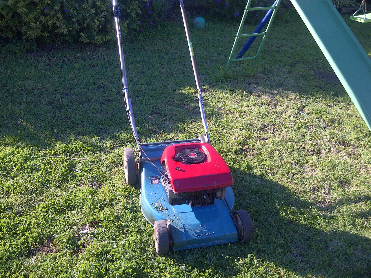

Hi folks.
A brand new member here with some questions about a mower.
This Masport mower came to me from a recently deceased friend. I would like to return her to glory, and was wondering about a few things to do with her.
At present she doesn't start, but has compression and the fuel is not fouled with water/oil but it is at least 5 years since it ran. Oil is low but within range and the throttle knob appears to be connected.
Let's start with some identification, and for that I have photos- hopefully attached to this post.
The code on the cowling reads:
110908 0336-01 76031004

Hi Julian, the engine is an 11 cubic inch (about 184 cc) side valve Briggs and Stratton engine of the first design generation, with a vertical crankshaft, a Pulsa-Jet carburetor, and a vertical-pull starter. I can't tell you when it was made because I think there is an error in the Code you posted (the last block of numbers). Without the correct Code I also can't tell you what kind of ignition it has.
http://bsintek.basco.com/BriggsDocumentDisplay/Z6lnsHVJ1DajI.pdf
http://bsintek.basco.com/BriggsDocumentDisplay/msowGK-K_ny7tH217FzoPu.pdf
Engines of that generation are sometimes overhauled if they do not need much in the way of new parts. They are not valuable, overhauled or not, and only someone with a sentimental attachment to one would spend a lot of time or money on it. Nevertheless it is often possible to get them running well for very little cost, and they can be very satisfactory mower engines.
Yep, I would have dated it as an early-mid 1970's 'Premier 4', about the last of Masport's steel catcher models.
The engine was made on 10th March 1976 then, which is at the latter end of that range, so I'd say it's original to the mower. To add to grumpy's info, it has mechanical contact point ignition.

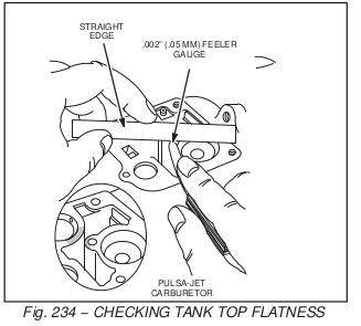

That sounds as if your Pulsa-Jet carburetor had been fitted with a service fix to overcome the effects of a bowed carburetor body or fuel tank top, which unless dealt with, causes extremely rich mixture in that model of carburetor. It would have been a small roll pin dropped into a hole in the fuel tank top right near the center. It would have had a small transparent Teflon washer around it, maybe about 6 mm diameter - difficult to see, and if lost, impossible to find. The purpose of the roll pin was to hold the washer in place. If you can't find the transparent Teflon washer, the roll pin is no use to you.
The Briggs part number for the kit is 391413. They are commonly sold in ten-packs. Here is a picture of what they look like:
http://www.equipatron.com/briggs-stratton-4184-10-to-pack-of-391413-overhaul-kit.html
I suggest you check whether the tank top or carburetor bottom is bowed a couple of thousandths of an inch in the center.

Here's a diagram of the carby pin and washer in the right position, from the Briggs Service Manual for that model:
And here's the critical part of the tank top that has to be checked for flatness, shown as the shaded bits in the close-up:
If the feeler gauge will fit under the straightedge, the tank is out of spec. It usually can be repaired as grumpy describes.

Errggh. That's the curly question. The 391413 repair kits are readily available in the US, but generally only under B&S P/No 4184, which is a 'workshop pack' of 10 sets. Not that dear [can be got for <US$8], but postage will cost more than the parts! jackssmallengines.com is one US parts mob who will accept international orders, but it's necessary to go right through their checkout process to see the postage cost.
Have you redone that flatness check, with the feeler gauge, as in the above diagram? That will tell us if the washer is actually required here, although it looks like it is.
If you're accustomed to using hand tools, grumpy's method of draw filing the tank top back to flat is worth considering. We can find an online technique how-to, if needed, I'm sure.
