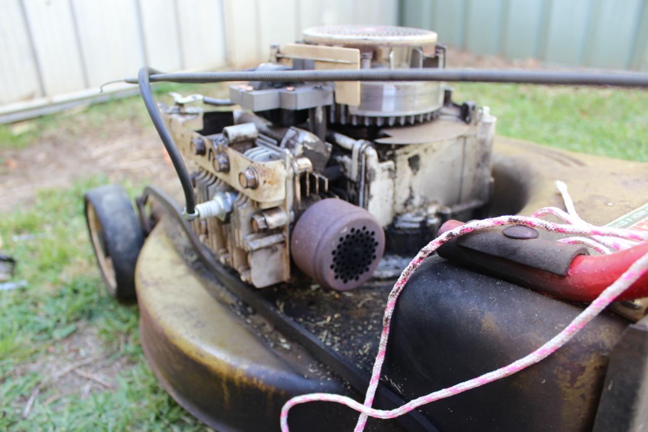

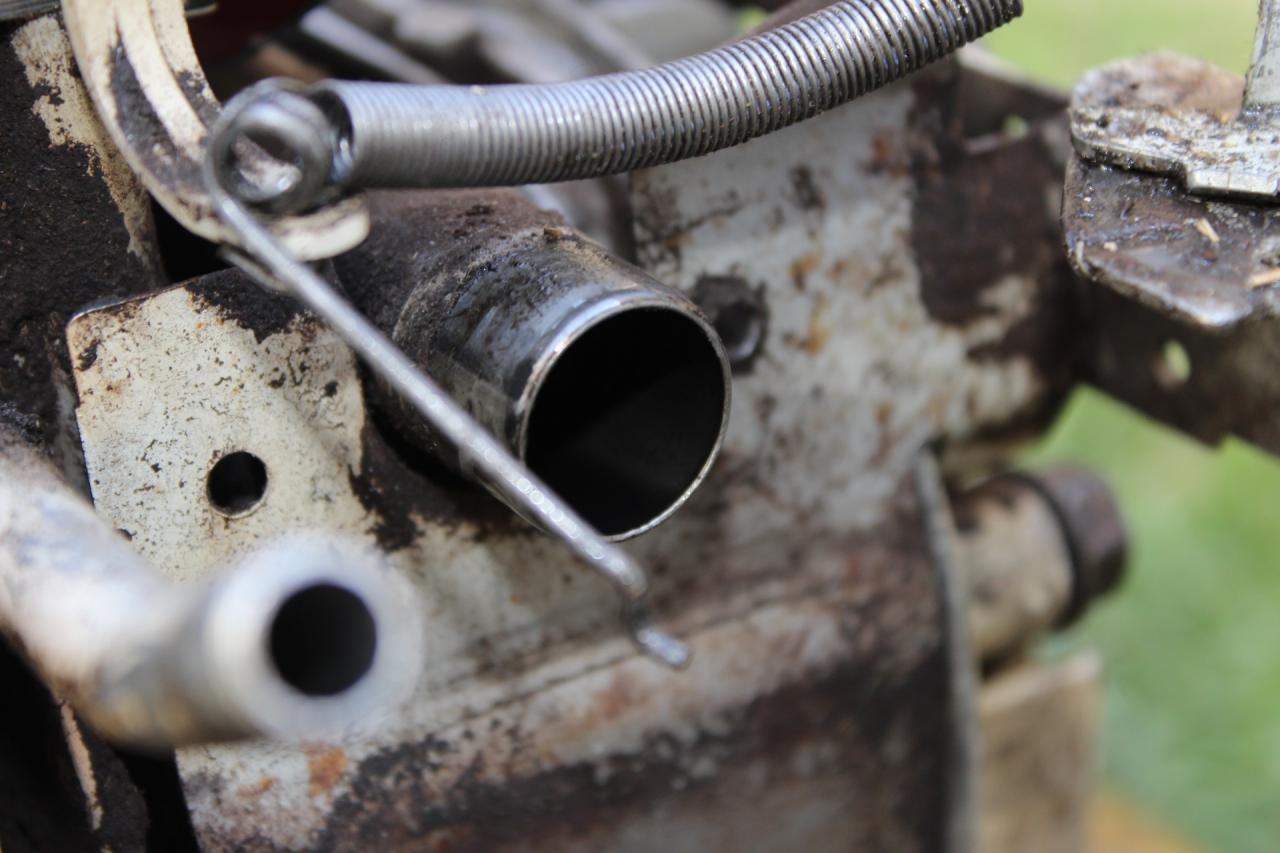

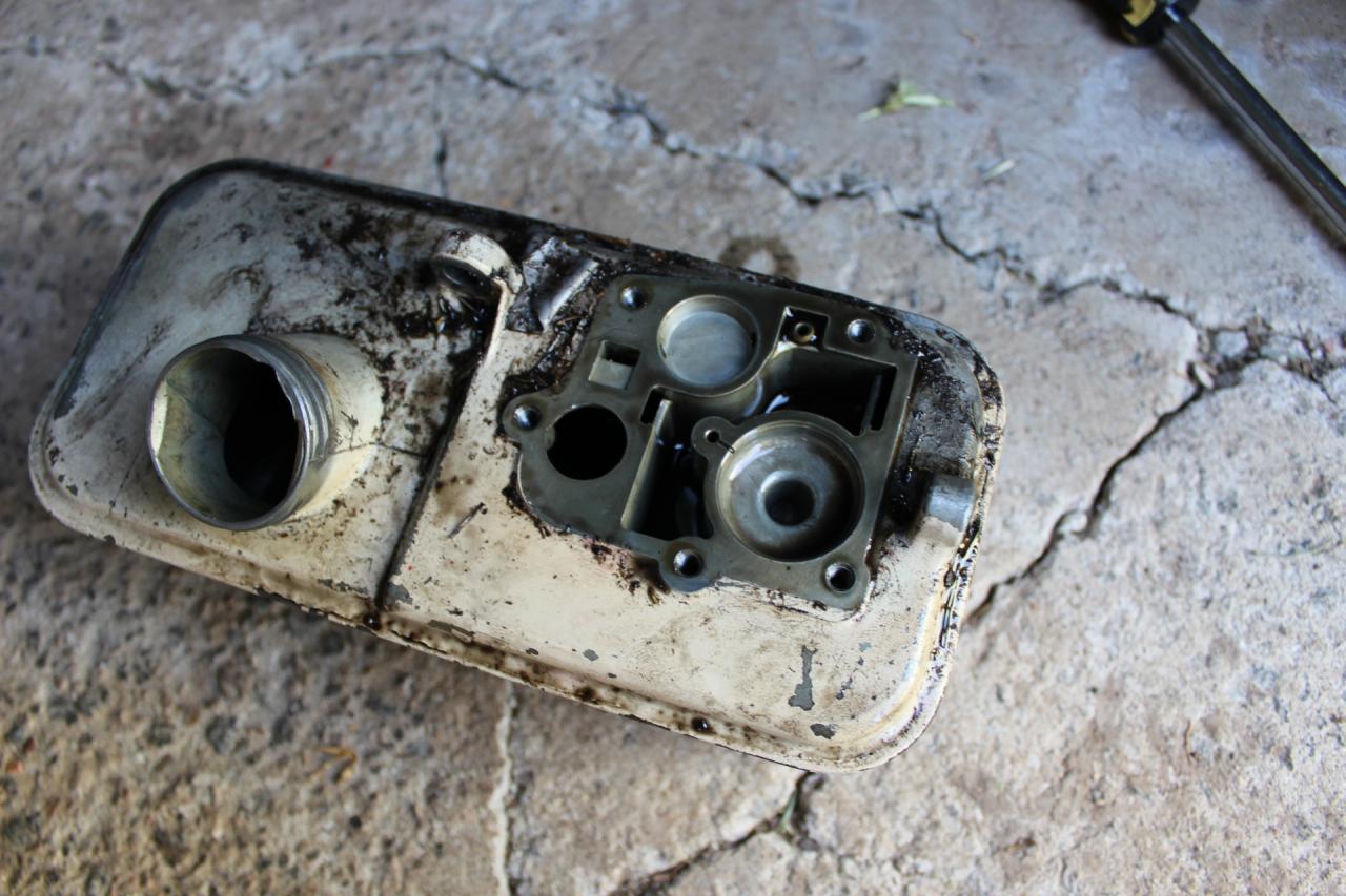

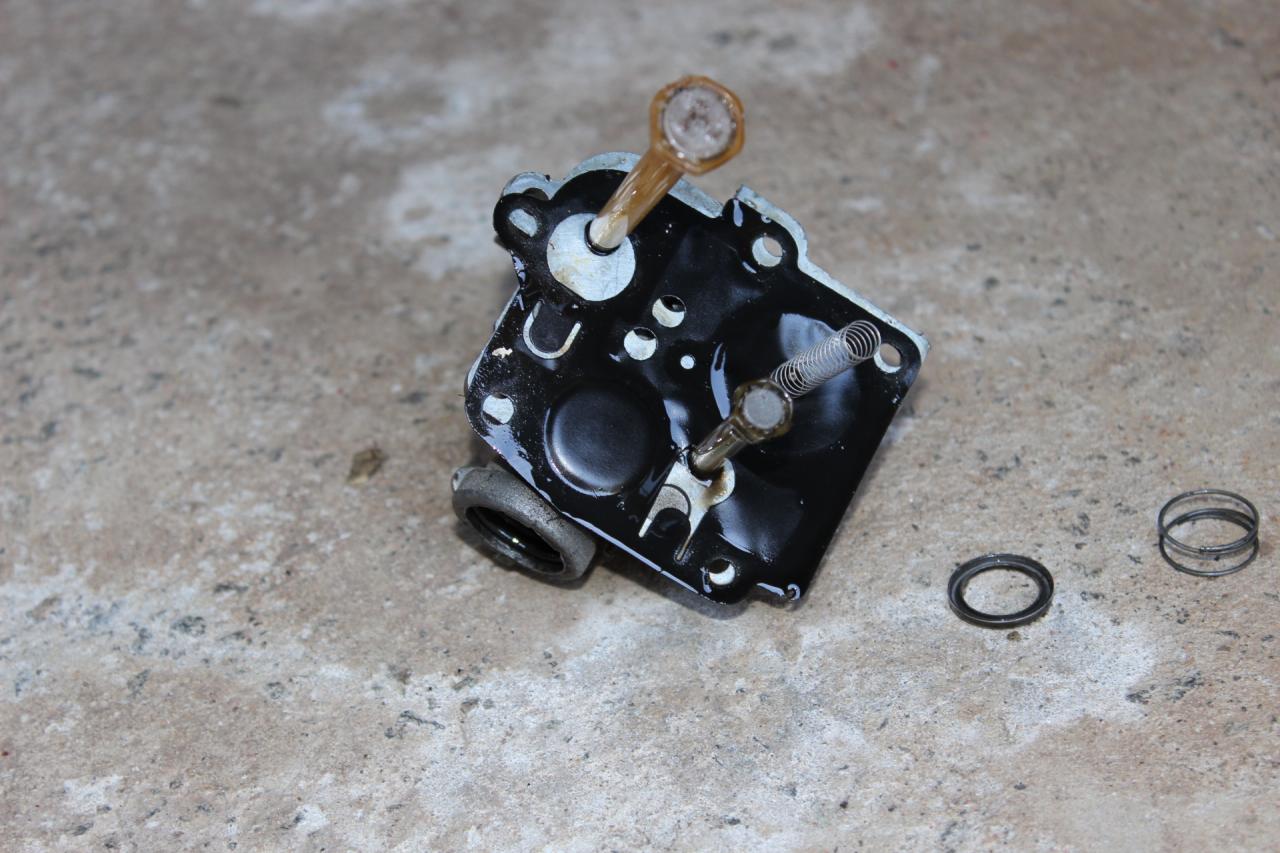

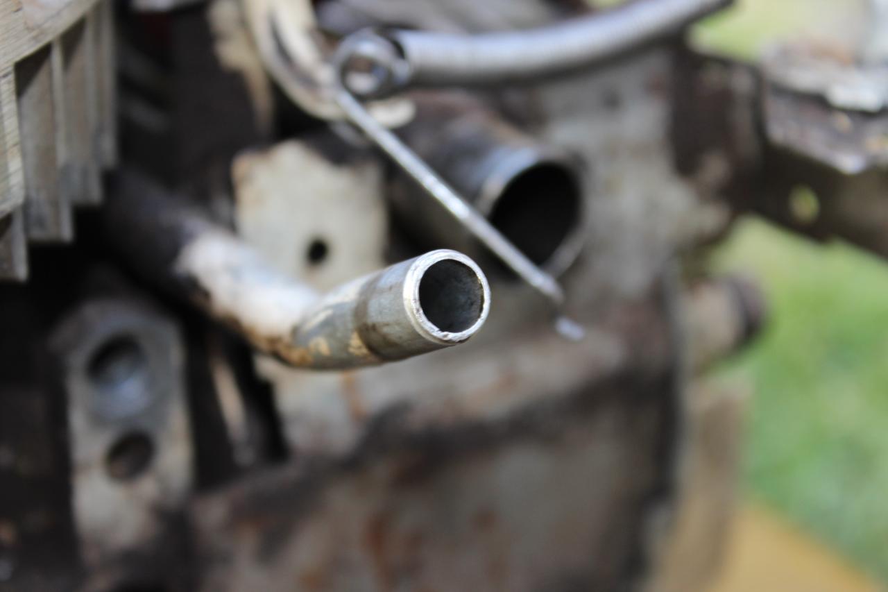

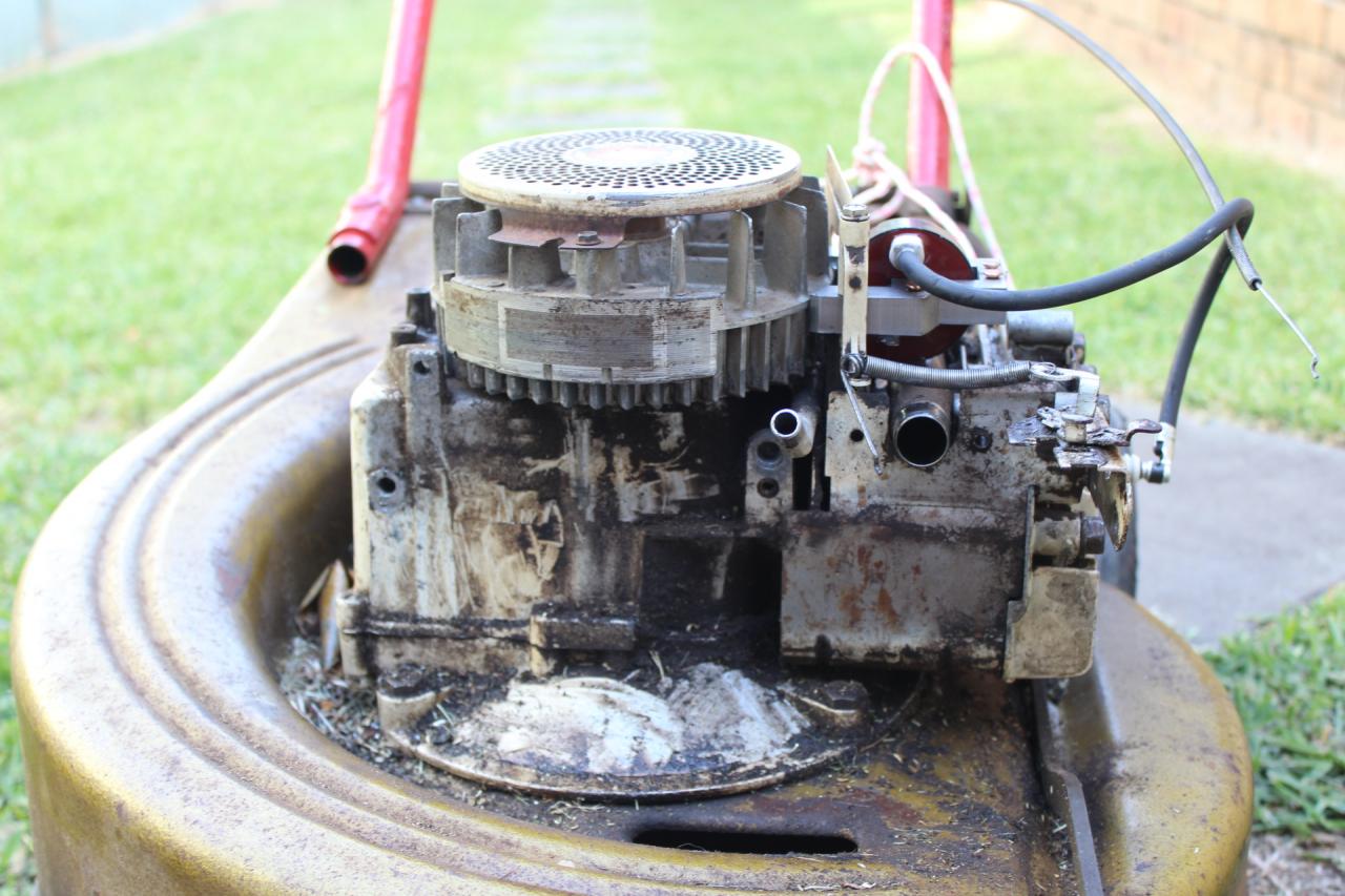

Here are the images of my mower, tell me if you want anymore photos.
[img]https://www.outdoorking-forum.com.au/forum/uploads/usergals/2014/11/full-8567-18398-img_4426.jpg[/img]
Also I noticed that the intake tube was a bit wobbly when I took the carb off it. By the way the oil getting into the cylinder only happened yesterday.

There is an O ring that sits in a groove in the carburetor, where it slides over the intake port. A small amount of movement between the carburetor and port is normal, to allow alignment when the fuel tank is secured to the engine: that is what the O ring is for. As long as that O ring is intact, it should seal adequately against intake air leaks.
Your fuel intake screens seem to be reasonably clear, and are not the cause of your problem. You should clean the screen on the long tube with carburetor cleaner now that you have it dismantled, and you should clean and inspect the mixture adjustment needle and the metering holes behind it at the same time.
Then I suggest you concentrate on assembling the carburetor to the fuel tank correctly. It will be very difficult to do this by using the post-1984 manual, so I suggest you just read from an on-screen version of the pre-1984 manual, starting with the right-hand column on this page:

I screwed in the mixture screw and it was 1.5 turns out from fully in. Then I undid the mixture screw and sprayed carb cleaner in, but I cannot see more than one hole in the hole for the screw. Anyway the carb cleaner came out of the intake for the cylinder and out the bottom of the carb.
I cannot check the flatness because I don't have a feeler gauge.
Thank you in advance
1.5 turns is the standard setting, so nobody has been messing about with that adjustment previously.
I'm slightly confused at the moment because those Pulsa-Jets normally have a screw-out fitting the mixture screw goes through - see red circle:
When you screw out the hexagonal fitting, a large space becomes visible, with the two metering holes at the bottom. Sounds as if you have some kind of Mark II version there. If there is only one hole, and it passes carb cleaner freely, all is well.
You can tell whether you can see daylight between your straight edge and either the carburetor and fuel tank top. With that model Pulsa-Jet, if there is any space there worth mentioning (that is, more than 0.002") the carburetor will flood continuously.
When you have checked the flatness, I think it will be time to reassemble the carburetor in line with the instruction manual.
