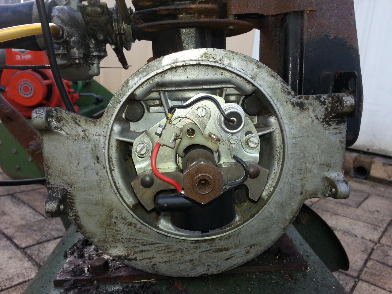

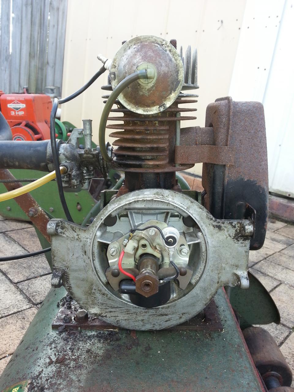

Assisting my son with a 2 stroke Victa Imperial 16. Pretty old mower sat for many years, compression is ok, carbie cleaned out, but can't get spark. Haven't had much to do with 2 strokes. here are some picks, has been pulled apart, any assistance would be appreciated.

Sorry about that, didn't take the photo with the points open. Will look at the material you attached. Thanks
Joined: Feb 2014
Posts: 12
Took the points and condenser off, points a bit rough, will replace both this week.
Joined: Feb 2014
Posts: 12

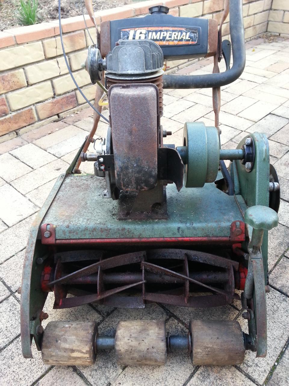

New points and condenser worked like a charm, starts first pull. Where can I get info on how to adjust the blades, bit different to a SB 45.
Hello Lotusmob, Gizmo and ODK members,
Lotusmob, You have asked a question about blade adjustment.
I'm not one of the technical guys here, but I can answer that.
The Victa Imperial is, in essence, a New Zealand Morrison design.
The Morrison design was, in essence, a British Ransomes design.
All these machines had a clever reel-to-blade adjustment, simpler than a SB45.
The bolts each side of the real (inboard) are the adjusters.
Turn each bolt clockwise to decrease the reel/bottom blade gap.
Turn each bolt counter-clockwise to increase the gap.
It's as simple as that!
All very adjustable.
