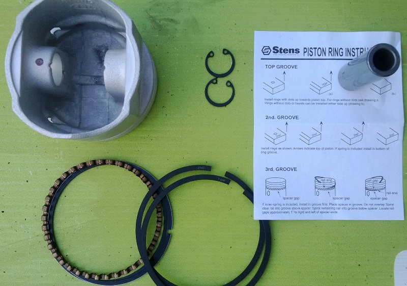

Originally Posted by grumpy
If Briggs used different piston ring groove dimensions with the chromed rings, it sounds as if they specifically didn't want people to fit them interchangeably with the plain cast iron rings. This may perhaps have been because they wanted to be fairly sure nobody would fit chromed rings, or steel rail oil rings, to an engine with an aluminium bore. I've certainly never been prepared to do so myself.
Looking through the factory parts list, it seems that there was a change in piston design, during this model's production run.
Both 'Standard' and 'Standard, Chrome' ring sets were available for the earlier type, used 'Before Code Date 01060700'.
But the Chrome ring set wasn't offered for the later piston, used after that date.
So it would appear that the supplier is correct in this case, if they are supplying the late type piston.
If the original piston was re-used, chrome rings could be used too.
The chrome ring sets Briggs supplied were somewhat a 'field expedient' really. Used to get a bit more use, without excessive oil consumption, from a tired engine that wasn't worth the cost of reboring/honing out and oversize parts. They do work in the aluminium bore engines too, and were available for most of them.
But with labour costs these days, these rings wouldn't be in much demand, in the US at least. Not much more money to fit a new engine over there, compared to an overhaul.
From the Briggs #270962 Repair Manual:
NOTE: Chrome ring sets are available for some engine models. See Service Bulletin #479 or Illustrated Parts List.
Chrome rings are used to control oil consumption in bores worn up to .005� (.13 mm) over standard. The
cylinder bore receiving chrome rings does not need glaze breaking or cross hatch.
Thanks Gadge, in those days at least, Briggs' engineers knew what they were doing, so it appears that the chrome plated rings can be used in aluminium bores. Did the chrome plated ring sets come with chrome plated steel rail oil rings? I don't know how the ring pressure from those steel rail rings with expander, compares with the pressure from cast iron one piece oil rings. If the pressure is the same, it should work.
Joined: Feb 2011
Posts: 510
I will definitely keep the chrome rings in mind, as an option down the track.
They just didn't work out for me this time.
It is a great tip for getting a bit more from an old engine.
I have also learnt to now look at the parts lists more closely.
When the bits get here I will continue this thread.
Yep, they have the 3-piece oil rings, and as I recall it the rails were chrome plated.
It appears that the standard ringset oil ring type for this model is a two-piece cast iron, with the internal spring expander.
Yep, so long as the ring tension is appropriate to the design, both will function equally well.

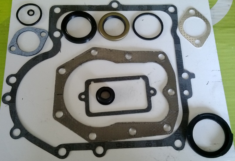

Bits have arrived. Piston and rings are marked well.

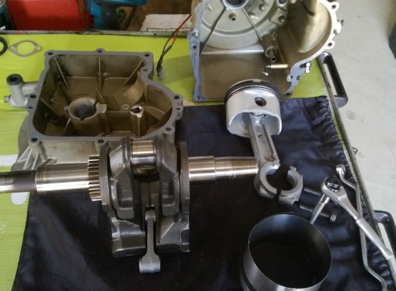

This engine is pretty much back together, here are some progress shots.
Just have to make up a heat shield for the muffler, add oil, connect up a fuel tank, mount the engine for a bench test.
