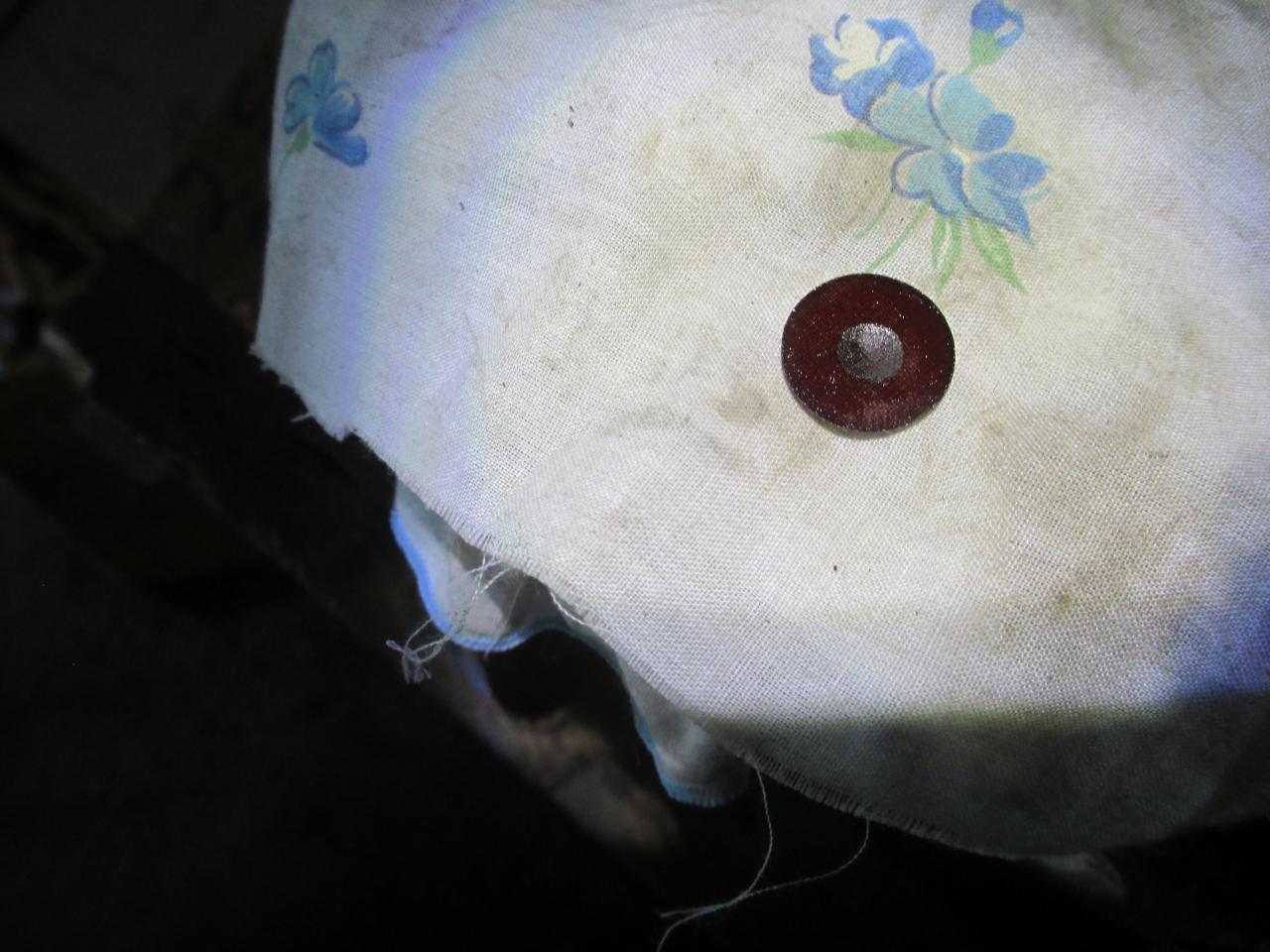

Is the PCV disk (see brown disk in yellow circle, in the picture below) in good condition? Be sure it is not stuck either open or closed, and it is not worn right through in the center:
If the disk valve is working properly, it sounds as if you may have to check the piston ring gaps.

Hi Grumpy have sent a quick photo showing disk valve. (In the second photo the divot in the valve isnt as big as it seems, its the way the photo came out.) It came off easy, didnt feel as if was stuck. Seems to be in good order. How can you tell if its stuck open or closed without taking plate off. What would be involved in checking the piston ring gaps.

If the disk valve were stuck closed, high pressures would eventually (depending on how worn the piston rings were) develop in the crankcase, and most likely oil would be forced past one or more of the crankcase gaskets, possibly blowing the gasket while doing so. If the valve were stuck open, there would be more oil than normal in the PCV valve compartment all the time, and this would result in there always being some oil in the breather hose. Your symptoms seem to be a decent fit for a stuck-open PCV valve, which is why I suggested you check for that.
The amount of wear on your valve disk is normal for a Honda that has just about worn out its piston rings.
