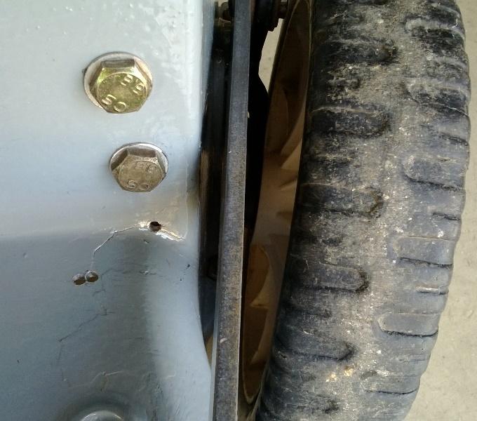

What can you tell us about your process for repairing base cracks, Mark? I've reported elsewhere on a very serious one I repaired once in an HRU195 base:
https://www.outdoorking-forum.com.au/forum/ubbthreads.php?ubb=showflat&Number=35850#Post35850
However that was a structural problem. I still have the mower, and use it every winter because my HR194 is unsatisfactory then due to the wet grass clogging the grass chute. The crack has not shown any signs of movement, but that was a lot of work and the result was unsightly. At present I am biased toward thinking that actual fatigue cracks like that one can only be repaired permanently by welding, or by massive reinforcement combined with anti-propagation tricks, as on my HRU195. Perhaps in a few cases propagation can be delayed by those tricks (drilling holes at the ends of the crack, and at any points along its length where it looks as if it might breed offspring) but those would have to be short cracks in unusual areas, I think.

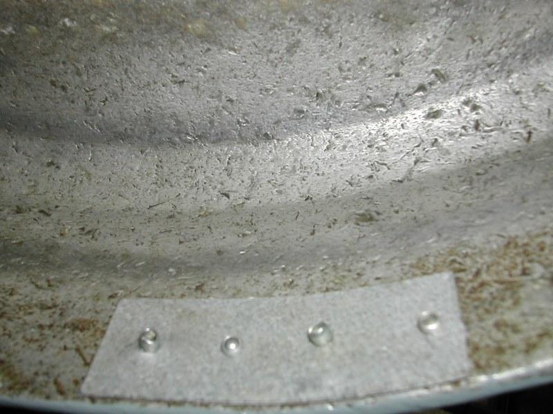

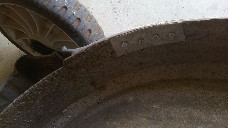

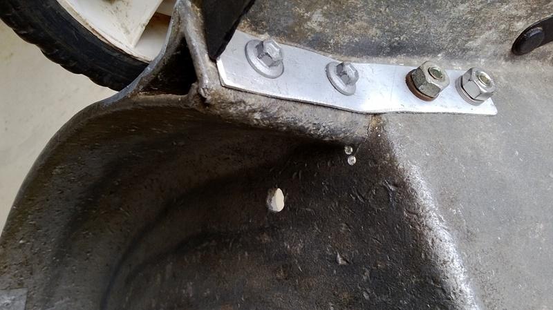

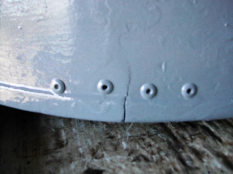

G'day Grumpy, these are the worst cracks.
I just riveted a piece of gal sheet to support the one below. (should I drill a hole at the end of it? Like when they repair cracks in car wind screens.

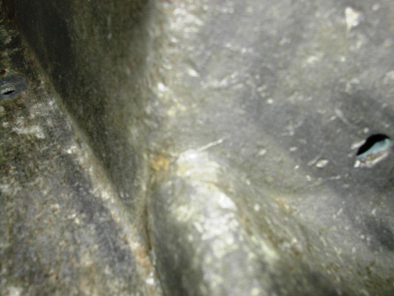

The crack below is similar to yours. Haven't done anything about this one yet.

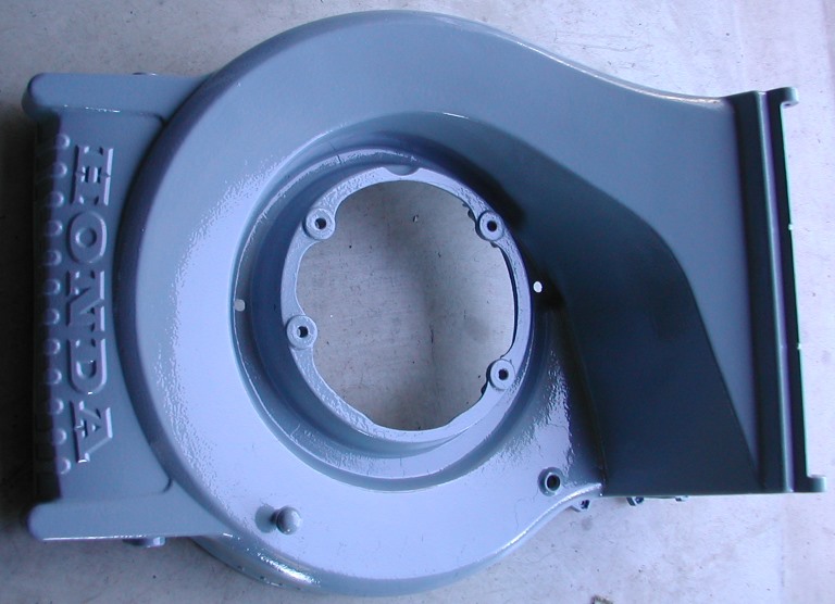

I have got this spare base together now.
Mark, because the base is much thicker than the aluminium patch you have used, and the pop rivets do not provide a very rigid joint, the cracked base will still be carrying part of the load despite the patch, and the crack will therefore continue to propagate. Even if you were able to make the patch and joints much more rigid, the sharp end of the crack creates such a profound stress concentration that it would propagate. I suggest you make a habit of always drilling the end of cracks. This is not just a matter of drilling a hole, though. In the crack on my HRU195 base as reported in the other thread, I found I had to drill one of the end holes half an inch further along than what initially appeared to be the end of the crack. You'll know whether you've found the end after you drill the hole, if you study the perimeter of the hole carefully: there is often a line visible in the cylindrical inside surface of the hole, indicating that the crack continues further. On that base I also had to drill two additional holes along the length of the crack, where cracks had started to radiate in other directions. With all the holes you end up with, you have to examine the edges carefully, and use a small rat-tail file to expand and extend them until the whole perimeter is clear of anything that might turn into a crack.
Now you can see why I put those large angle-iron braces across that crack: I had to ensure that the braces, and their attaching bolts, provided much more rigidity than the base itself did.
Thanks for reporting that crack you found at the rear of your base, where the grass chute runs out, in the same place as the massive one I had. I had no evidence before that mine wasn't an unusual failure mode. As you can see from the way mine had progressed, that crack in your base will destroy the base if you don't do something very effective to prevent it.

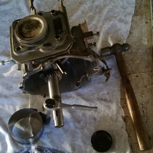

I have been chipping away at this this morning.

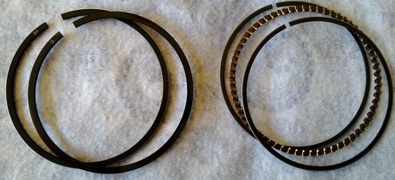

Installed rings. Normally use my fingers but I used the device shown on the Hondas I have done to date.
Spaced the gaps 120 Deg apart, also spaced the oil rings 20mm apart.
I ensured the markings on the rings where facing up towards the crown.

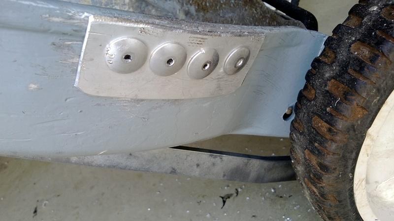

This is what I ended up with for the cracks in the base.
I used 5mm pops and Araldite to sandwich the plates together, also drilled the end of the crack. Had to be mindful of the blades hit the repair on the inside. This is just what I have done with what I have at hand here.
I put this brace here as I wanted it clear of the grass chute.
I'll keep moving, cheers.
How you fix cracks is a personal thing, but it is very desirable to keep track of your repairs after you make them so you can verify how well they work.
