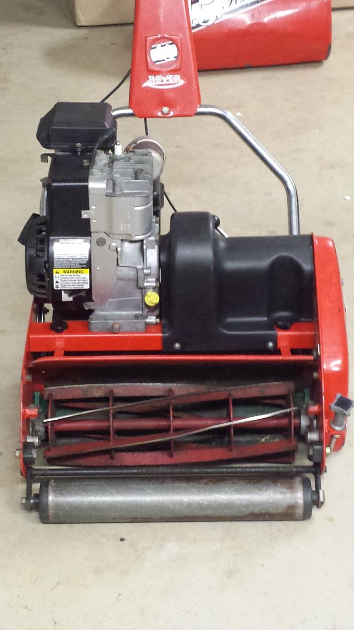

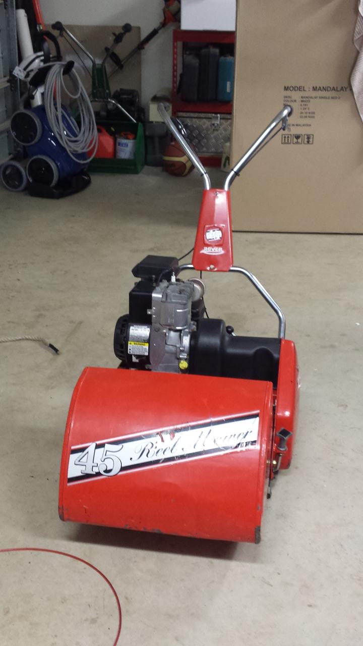

Hi Guys,
New to the forum - recently bought a second hand rover and was hoping i could get some information from you guys as i am new to the game. Images of the mower i purchased are attached.
Model: 91202
Type: 1371E1
Code: 0203133A
if you guys could provide me with any information that would be great.
Thanks
Dejan

Hi Dejan87, and a warm welcome to the forum.It's great to have another Rover 45 owner on board, as we all like to learn new things and tinker here. grin
Your machine is in brilliant (almost NOS) condition, with no obvious damage at all, correct colour scheme and fittings, with what appears to be an 8 blade (could be 10...its hard to tell from the pic) cylinder reel. wink
Your machine was manufactured in the Rover factory in Eagle Farm, Brisbane, QLD sometime after June 2002 (allowing for freight time of your engine which was made in the USA in March of that year)
Carefully maintained, this machine should last you a lifetime and give you years of mowing pleasure.
Well done, and my congrats on a great score there!
good1

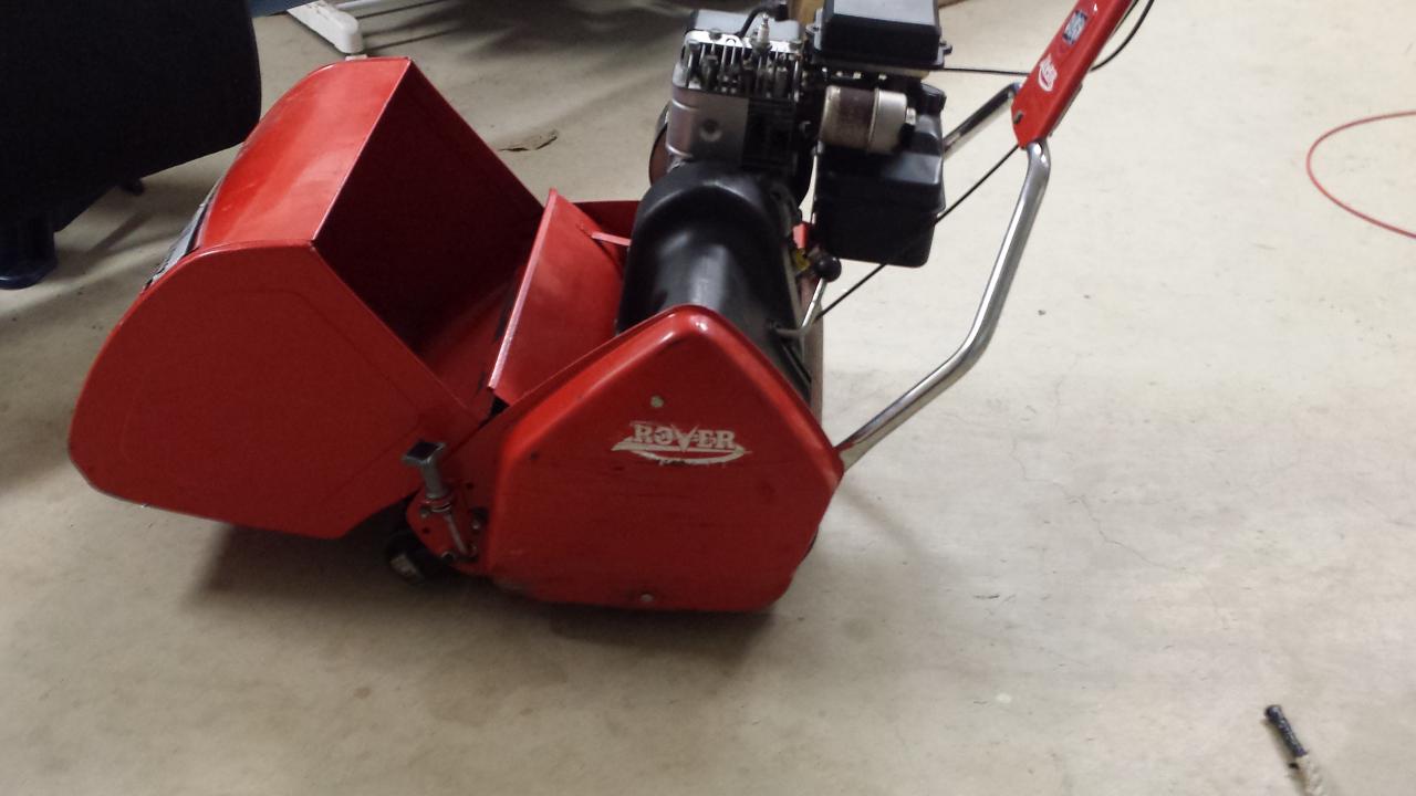

adeas #58055 21/09/14 06:56 PM
Hi again Alistair,
Thanks for posting the pics of your machine. This mower appears to be of earlier manufacturing date than Dejan87's machine even though your engine was manufactured a day later. Allowing for freight time from the USA of your engine, I would hazard a guess, June 2002.
I base this on a small detail and that is the black plastic knobs for adjustment of your grass deflector. These are of the same type as the Series 2 Scott Bonnar Model 45's and the large screw type were favoured by Rover on the last machines they produced (and are now available as spare parts)
Just out of interest, they were also used on the early Scotties (solid engine deck) first introduced in 1968. wink
It seems to have had plenty of use, and has the usual dings on the catcher and also seems to have had the cylinder reel painted red (or been swapped with one from a Scotty 45) as they were originally painted black.
It has the standard 6 blade reel.
It looks to be in good condition for its age, and is a great buy at that price....and once your engine probs have been addressed and the machine carefully maintained, it should last you a lifetime and give you years of mowing pleasure. grin

Thanks for your reply. Good to hear about the machine as I paid 900 for it. The reel has 8 blades. Did these machines come out with 8 blades or is this a replacement?
The other day moving the mower around I managed to scratch the chain guard which left me very upset with my self. What's the best way to fix this and getting it looking like new again.
Also k's there any place I can buy new decals?

Dejan87 #58078 22/09/14 07:21 PM
Hi Dejan87,
The 8 blade reel was an optional extra as far as I know...maybe the reason for the extra decal on the catcher that says "select model"...but the standard cylinder reel was a 6 blade, at that time.
With the scratch on the chain case cover, just take the cover off the machine and take it to a automotive paint supplier to get the colour matched....or take it to a panel beater/spray painter and get him to repair it. wink
As for the decals, please send ODK member 'willing worker' a PM HERE Grant may be able to help you there. grin

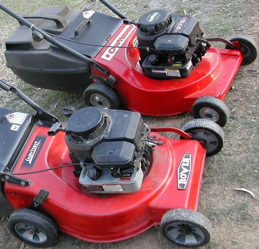

Joined: Feb 2011
Posts: 510
Hey Dejan,
I use that paint, the colour is called Delicious Red
The rear mower I have painted with it.
Front mower is original paint, faded a bit I guess.
mark electric #58118 24/09/14 06:29 PM
Hi Mark, I must admit that colour looks close...I have used that product myself on various projects and looks great. wink
