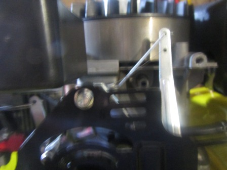

I have included a picture of back of the carby where I am talking about lining up the hole in the gasket. Just incase this might be the reason.[Linked Image]

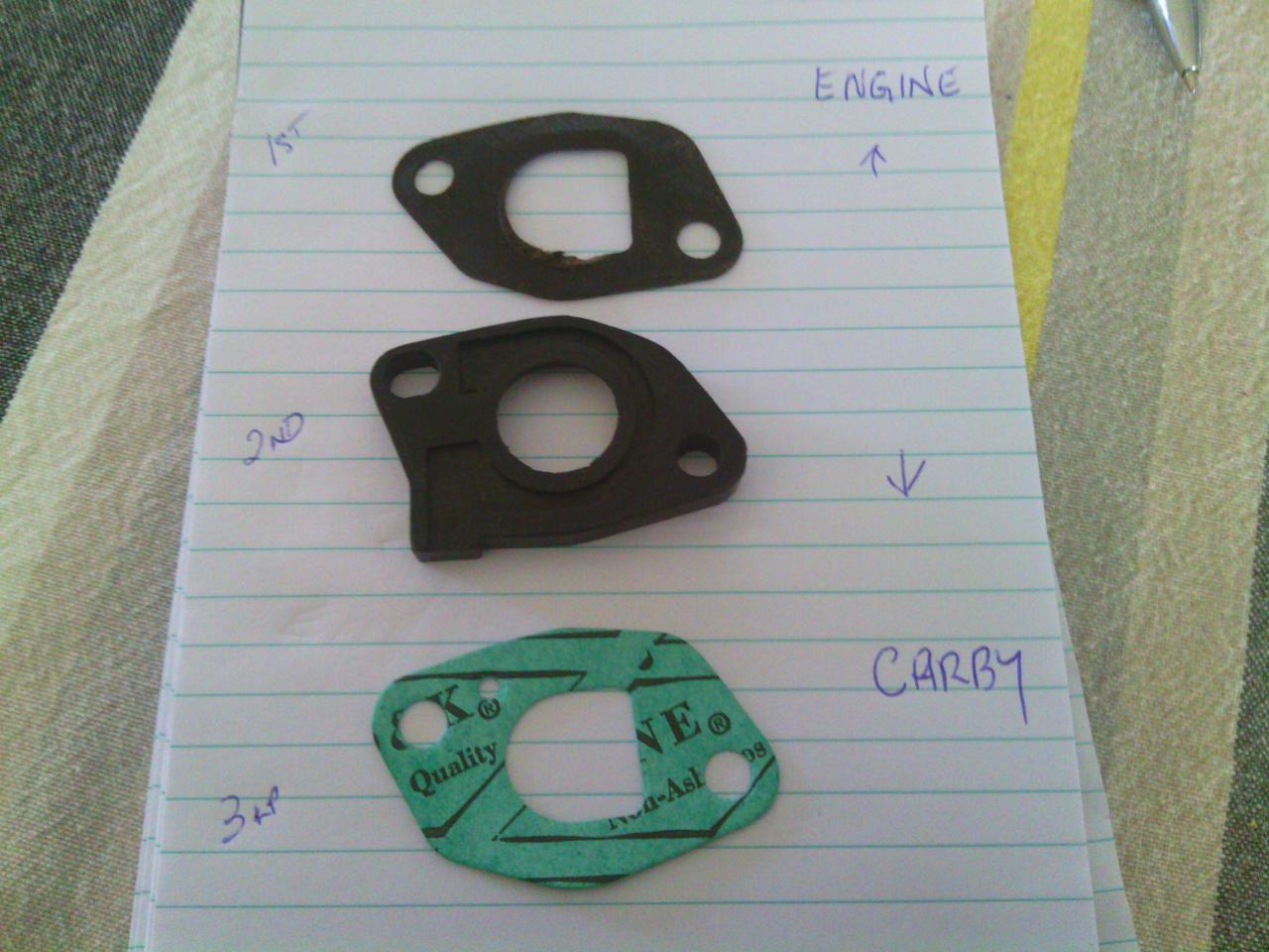

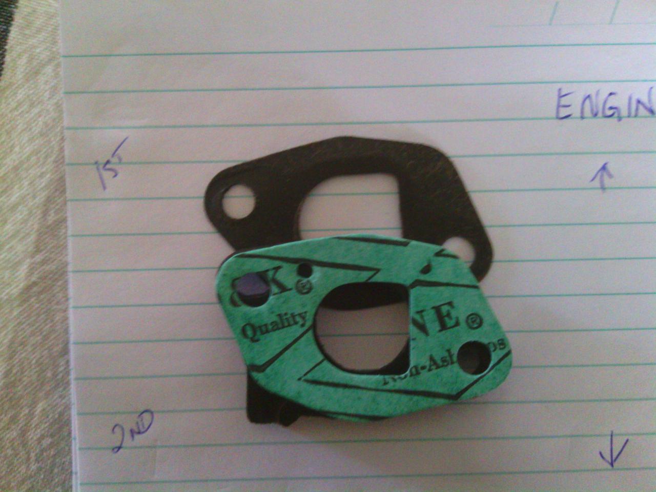

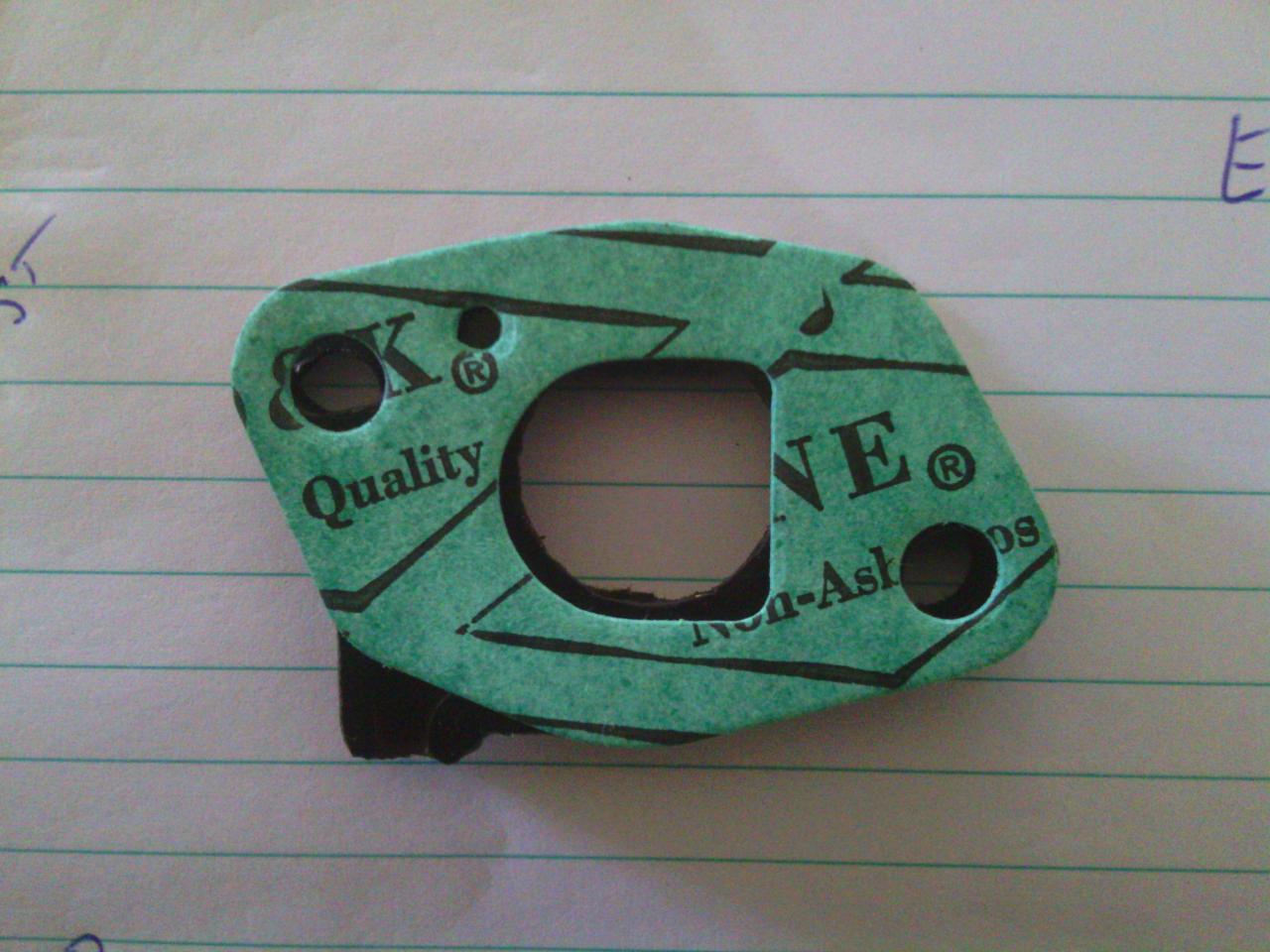

Going back to your last photo Jaffa the hole in the gasketis not supposed to line up with the hole in the carby and in your previous photo to that of your gasket and spacer is wrong or it is different to mine.
Joined: Apr 2013
Posts: 336

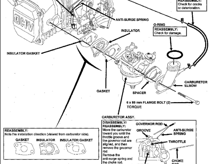

This is how they should look all lined up ,all three with the hole on the left . This is what you should see just before you mount the carby. Ignore the square edge on the green one as ,pretend it's round.
This is the assembly instruction drawing for those parts.

Hi Jaffa, i've been following the thread and you've got the pros on your team on this one. I will add/re-confirm one thing though; The 2 gaskets and the spacer play a huge part in that machine running right. The first gasket, which goes on the engine side, and the insulator are pretty straight forward. The final gasket is the one that will definitely give you grief if not put on in the right position. The little hole must be on top and off to the left a little when installed, exactly as set out in Roebucks pictures. I noticed in your photos you have it on wrong. Once installed correctly the bottom of all 3 gaskets will line up flat along the bottom edge.
Bassic deductive reasoning tells us it was running ok prior to the carby clean. So either the gaskets are all jumbled up and incorrectly placed or the carby is stuffed, which i doubt as it runs sweet when the air filter cover is removed.

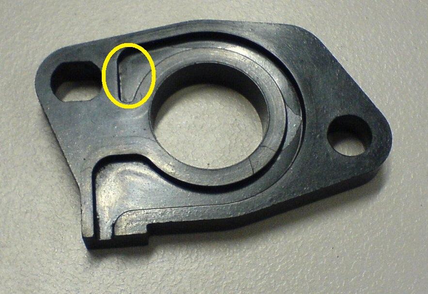

The GXV140 has a D-shaped intake port, which shows you which way to put on the gasket on the port side of the insulator. Then you put the insulator on with the air passage positioned away from the engine, toward the carburetor, and with the entry port for the air passage facing downward so it won't collect dirt, and the matching port in the carburetor in the same position when you install it:
Note the yellow oval on that picture. Put the hole in the second insulator gasket over the top of that yellow oval, so that it communicates with the clean end of the air passage in the insulator.
Then there is only one way you can put the carburetor on, unless you want to have the float bowl upside down:

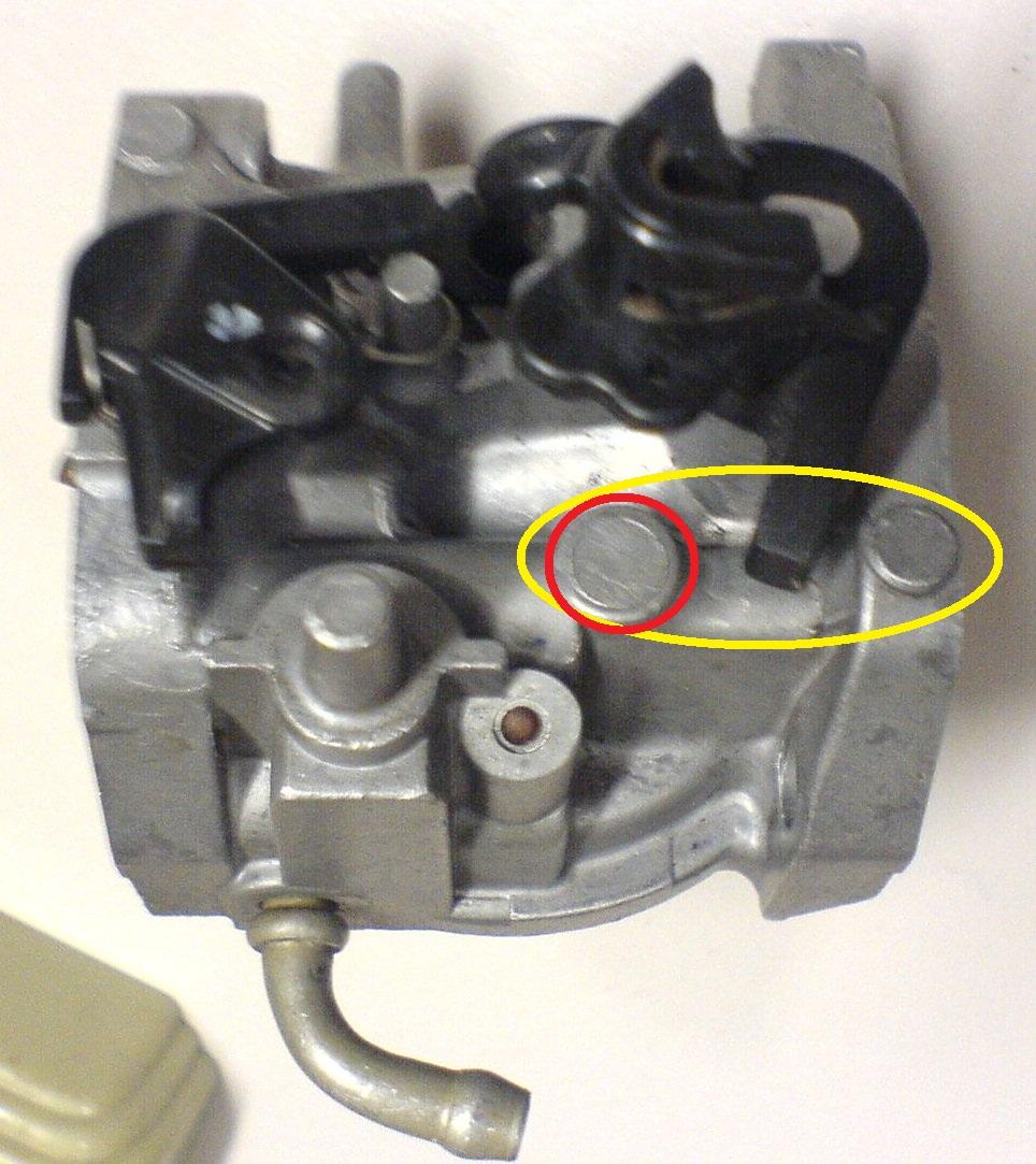

The carburetor appears to have been designed for that system to be the float bowl vent. Here is a top view of the carburetor:
The yellow oval shows the path of the horizontal passage in the carburetor, of which the port we have been looking at is the end point at the right hand end. The red circle shows a vertical passage down to the float bowl compartment, matching that horizontal passage.

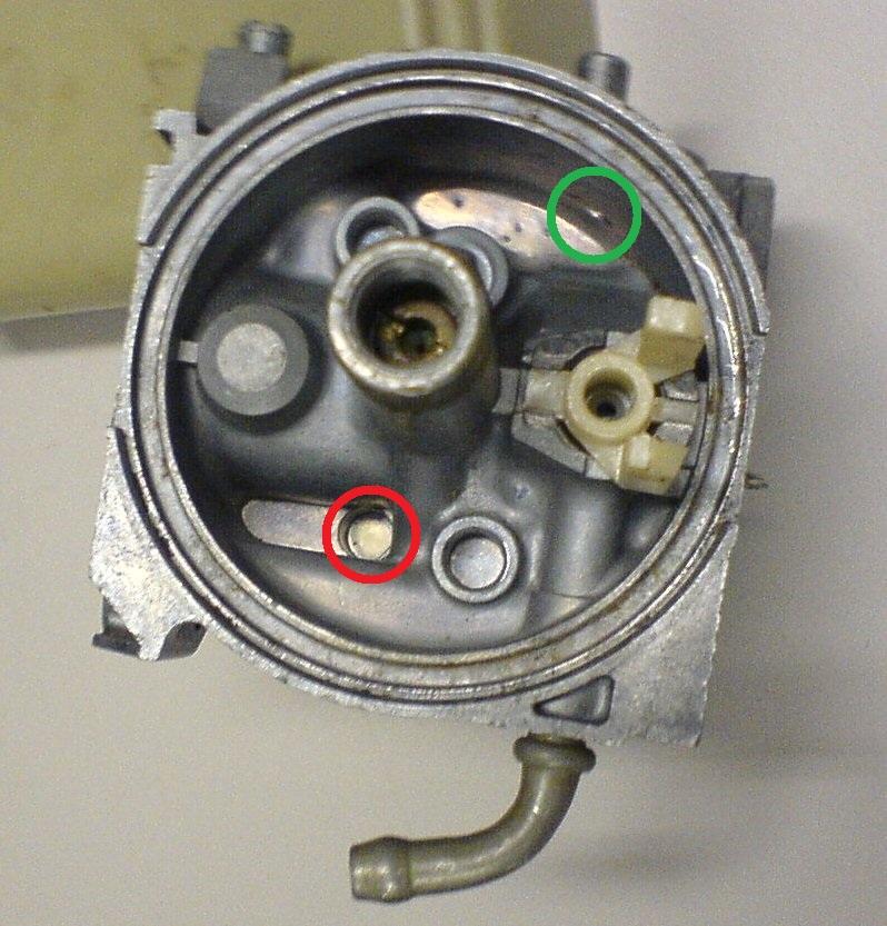

Now let's look at the underside of the carburetor, above the float bowl:
The red circle shows the underside of that vertical passage that we've just examined from the other end. If you look at it very closely, you'll see that there is no lateral port at the bottom of it, heading off to the left, toward the port in the carburetor's mounting flange. I've verified this by probing the passages: the passage from the flange to the vertical passage is blanked off. After providing elaborate tooling in the insulator and the carburetor mounting flange, plus the horizontal and vertical passages in the carburetor, Honda decided not to use them, probably because of the possibility of dirt entering the float bowl through that system. Hence it seems it makes no difference whether you misassemble that system or not, since it isn't being used.
So how is the float bowl vented, I hear you cry? Check the green circle. This is the actual float bowl vent, which communicates with the air cleaner, and thus does not allow dirt to enter the float bowl. Note that all this does make it important to put the air cleaner mounting parts together the right way around.
I must confess I didn't know until I did this check this morning, that the air passages in the insulator and flange are dummies - so the exercise has been interesting, and perhaps useful.

I now have the gasket, insulator and insulator gasket positioned exactly as per Roebucks photo and grumpy�s schematic.

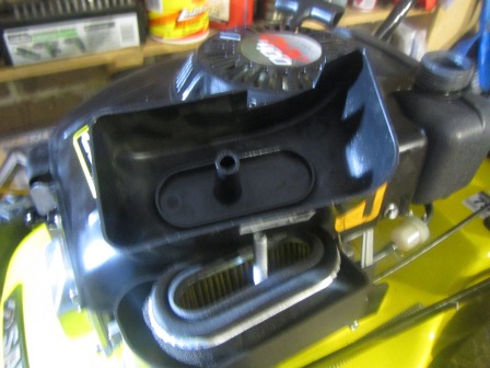

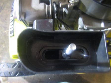

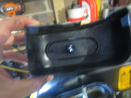

I have also attached some additional photos of the air box assembly to check for any abnormalities when compared to Rob�s photos.
I personally cannot see an incorrect way to install the air box however I have attached some additional photo�s grumpy as you requested.
The first photo shows were I have removed the breather hose to check for blockages � nothing found. I also check the joining arm to the airbox which is quite small and it wasn�t blocked.
The second photo shows the airbox mounted with the breather hose removed.
The third photo is the top view of the airbox.
The fourth is the underside of the airbox cover.
The fifth photo shows me about to re-install the cover.
The air passage I can assure you is 100% clear.
