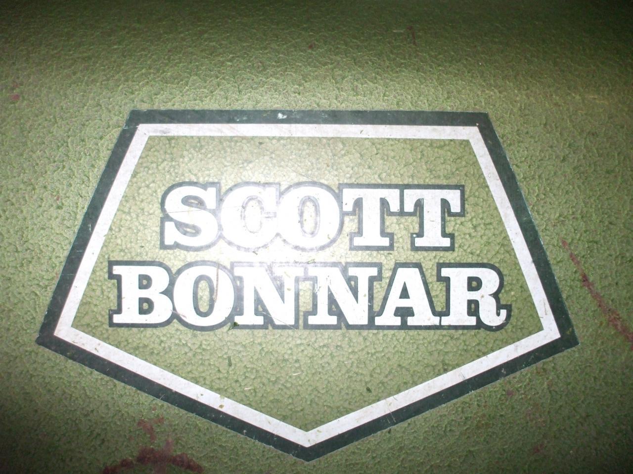

Darryl, would you happen to have a good quality pic of the chain cover decal (and also the exact dimensions)? Is the Scott Bonnar written in individual cut out white letters, or is it printed onto a clear background like the catcher?
Hi Michael, my chain-case decal has been ruined by running close to edges over the years and paint is also missing, but it was the white letters on a clear background. wink
I will replace it with a catcher decal if I have to, mate.

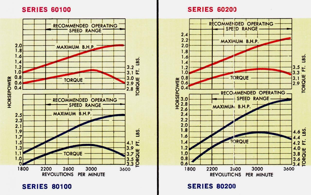

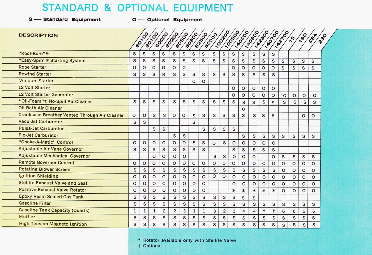

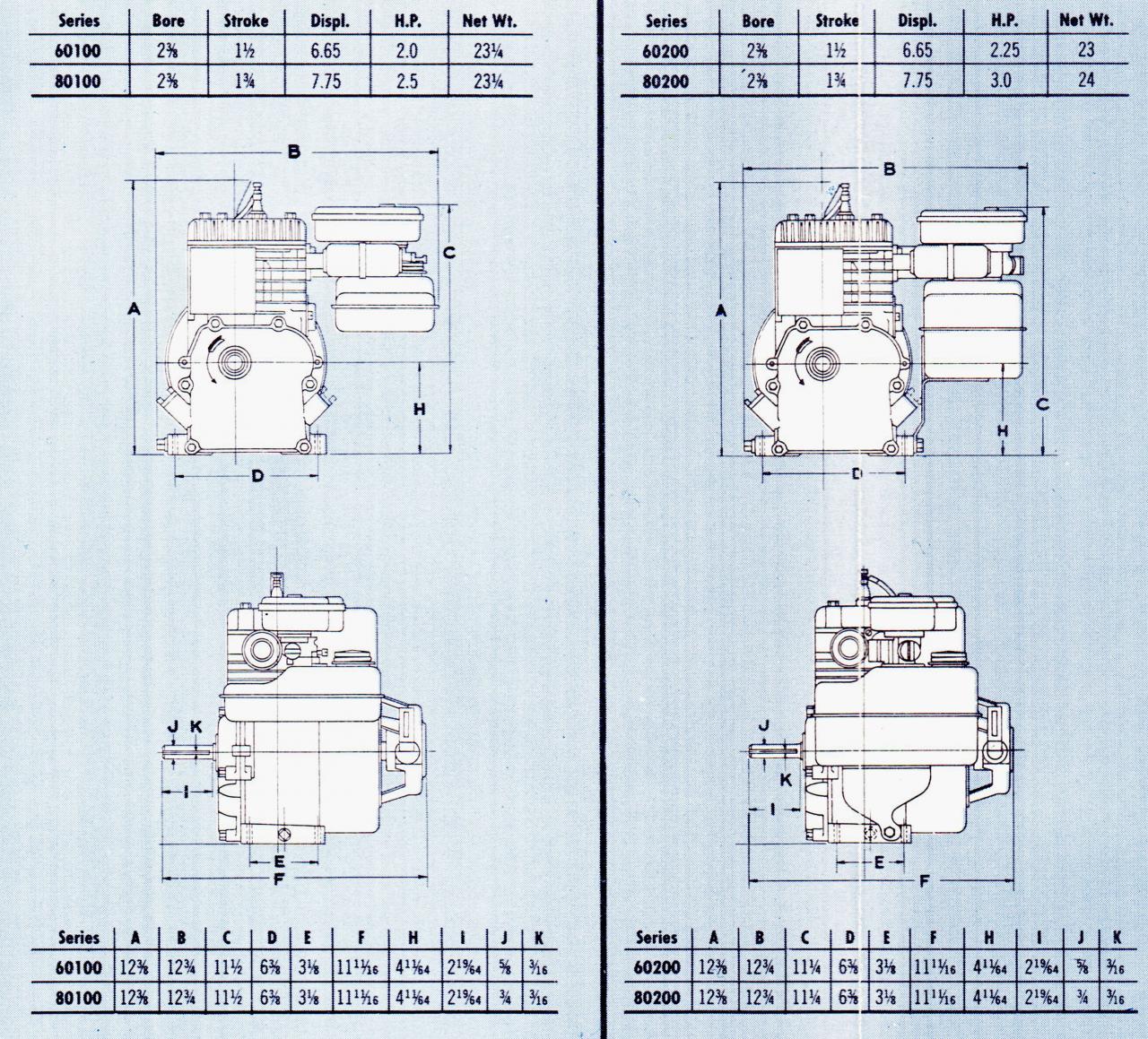

Some more info on Briggs engines fitted to early 45's.
