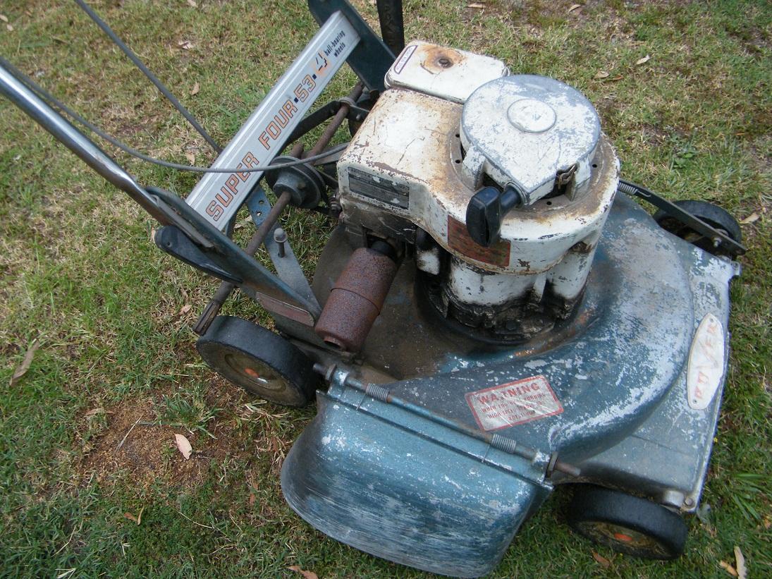

G'day guy's....Ive been on the lookout for a mower to do up thats a bit more a challenge and not very common,to what Ive done before..Finally got one this old Rover....I got it from the tip so far it's a good start as it runs fine..Well it should be a challenge and an interesting restoration...Cheers.

I cant find much on the net about it I think its 5.5hp?...I plan to use it to mow with when done as I do with all my mowers...

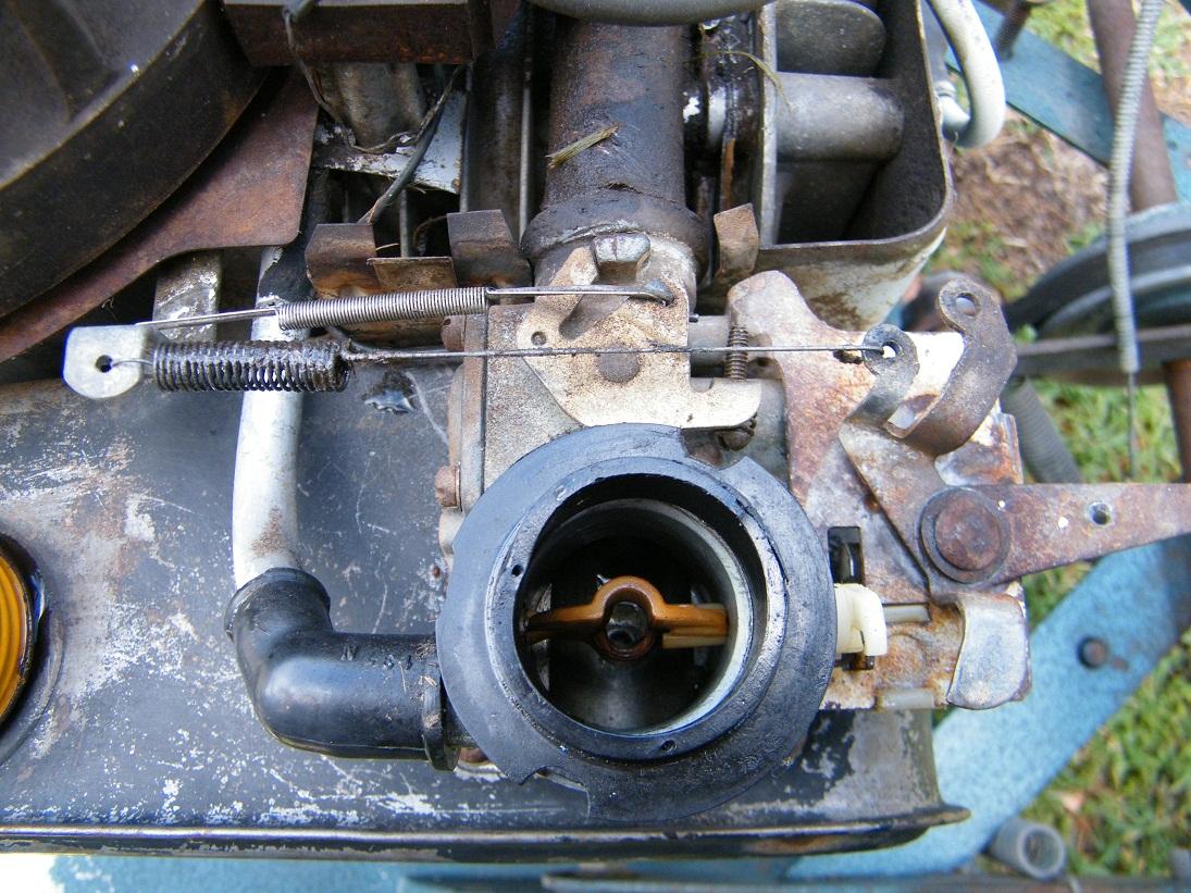

After a quick clean to see what I have on my hands,its not to bad..The base needs a repair at the front and that's about it as far as damage goes but should be an easy fix....[Linked Image]

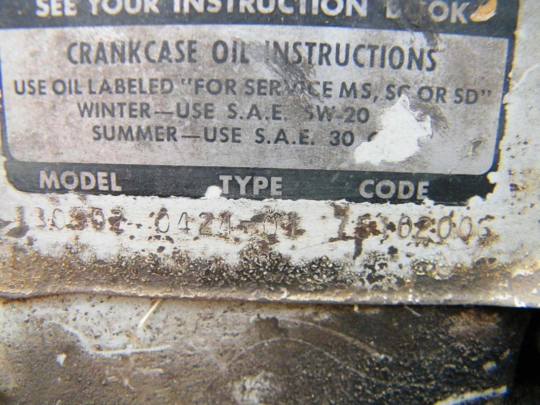

As far as I can read it from the picture, that is a model 130902, type 0424-01, code 75102006. If that is right, here is the Illustrated Parts List:
http://bsintek.basco.com/BriggsDocumentDisplay/Z6kpuBVJ1DajI.pdf
http://bsintek.basco.com/BriggsDocumentDisplay/msotJO-K_ny7tH217FzoPu.pdf
It was made on 20 October, 1975 in the Murray, Kentucky engine plant.

Thank's heaps grumpy for the info and yep numbers are right so 1975 briggs,bugger me thats getting on...And Joe any chance you could get some pics of the one you have? I only have like 4 pics I found on the net of this kind of mower....I pulled the carby off to give it a good going over,but one thing I will say is the 1st thing I do is take a pic of how the springs and linkages go its a good start even if wrong, and I never remember how they go back on! haha... Talking of carbies here is a good link on Carburetors I found ,thats if its ok to post? well here is the link http://outdoorpowerinfo.com/repairs/ [Linked Image]

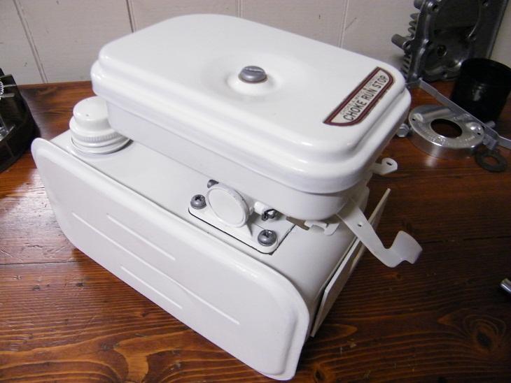

Done some work on the tank and carb side of things,am happy with how its looking so far.....

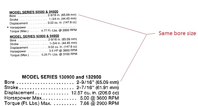

I noticed the bore size is the same for the 3.5HP engine, like on your orange rover, just a larger stroke giving 206cc compared to 147.8cc.
Could be the same piston, I haven't looked at the part numbers to compare yet.

Thanks guy's and yeah I think it will look the goods when done as well..And mark I did not know that so its 206cc with same size bore as the 3.5hp engine interesting indeed... Im yet to pull the engine in half will know more when I do....Here is a pic of a test run of the blue hammertone paint Im going to use and it looks ok to me so think I will go with it...[Linked Image]

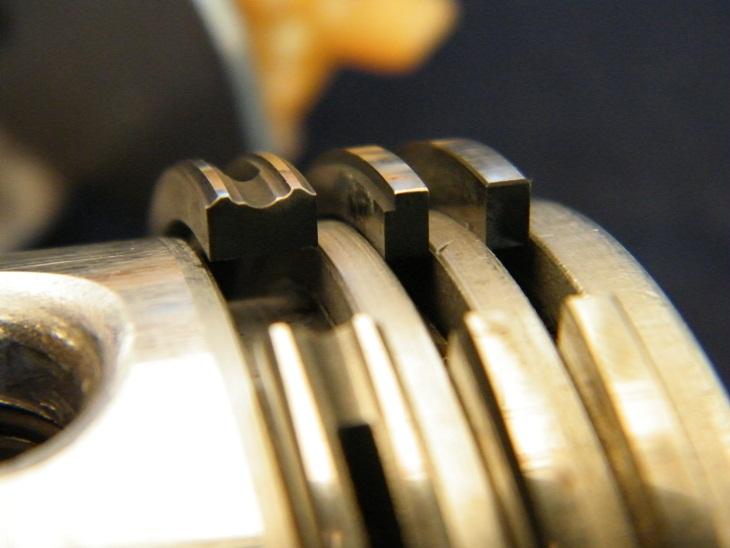

Hi guys looks like i've got a winner with the engine, seems to be in great shape for a 35+ year old engine it may not be perfect there is wear here and there but it will be a runner...It must have had new rings as they seem like new to me. And a question for grumpy is the 2nd ring in the right way? Ive not pulled them off the piston that's how I found them...Cheers [Linked Image]

Chris, that is a somewhat unusual but not rare, scraper-type second ring design. It is called a Napier ring, probably meaning it was pioneered by the Napier cars of the very early 1900s. Yours is installed the right way up.
