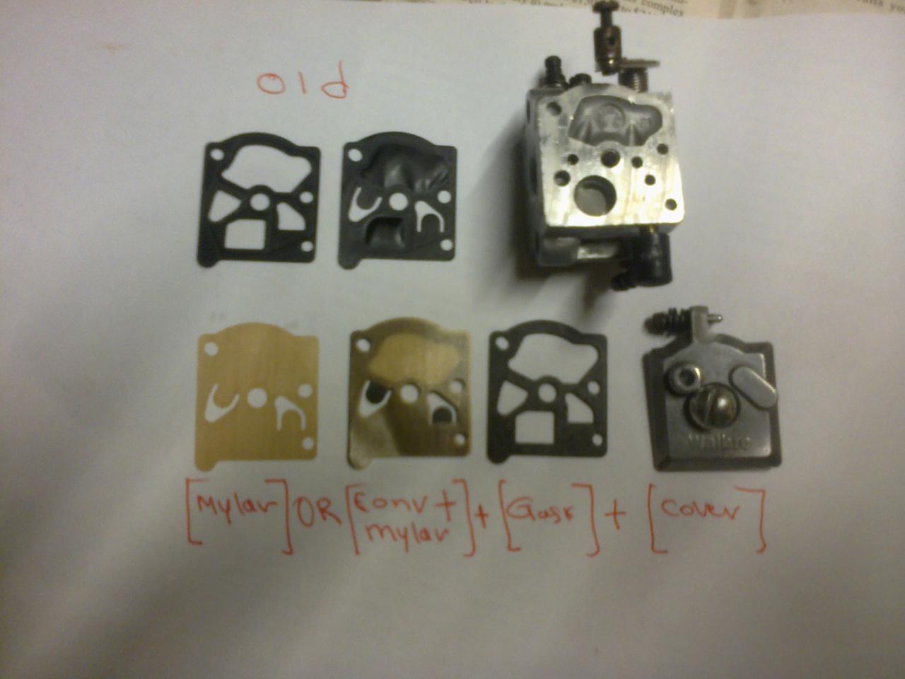

yeah, getting there. Thanks for your help. I will try the mylar alone next. However just to clarify I did not use the the two diaphragms with flaps. Only the conventional has flaps. The mylar part I used is the one at the bottom right in the photo. That one on top of the conventional one gives me the shape of the mylar diaphragm with the tick (which I haven't used yet) in the picture. The problem the cutter must have had to do with the leak, The metering diaphragm was broken and a bit stiff. I replaced it and the leak has gone. I was able to use the cutter for 20 minutes. The pump diaphragm is not broken but is is stiff and not good as you say.
So you used the conventional one second from the top of the center column (with the cross on it) together with the mylar one at the bottom of the right column? Which one was in contact with the carburetor body? Remember that the flap valves can only work if they are right up against the flat metal carburetor body. If you put anything in between, such as the gasket or the mylar diaphragm, the flap valves can't work. So, the conventional item second from the top of the middle column needed to be directly in contact with the carburetor body, and the mylar diaphragm needed to be in between that item and the gasket, which would have been against the pumping chamber cover.

Yes, I had used those two in the correct order: the conventional first(in contact with the carburetor body, then the mylar then gasket and then cover lid but it wasn't working.

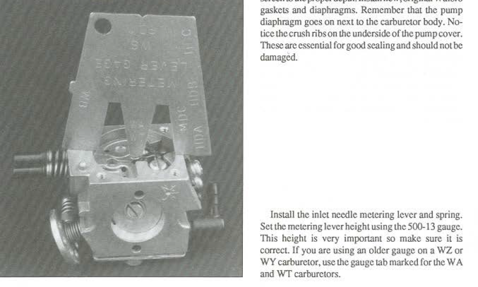

I made (sort of) the gauge and measured as in the photo ( middle bar resting on the lever) It is quite close. Close enough I would think.

Here is the one from the WT manual, which you will notice applies also to the WA:
The measuring tool you made is supposed to be the same as the one in the WT manual: it spans all the way across the end of the carburetor. What you may be saying is that the dimension I gave you (1.65 mm) is incorrect.

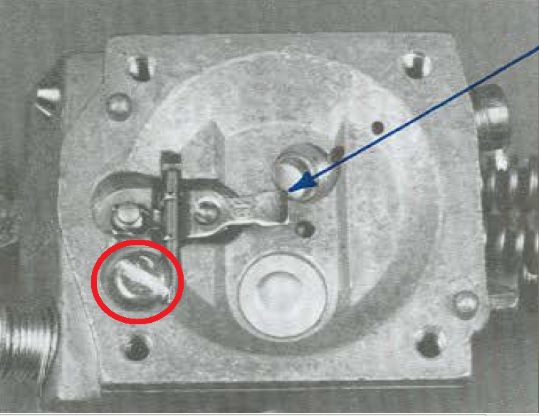

I found this:
Apparently there are two types of WT: Circuit Plate Type and Welch Plug Type. The first one doesn't need the tool, the second one does.
I am not sure what this all means but from the diagram above and photo below (taken from outdoorpowerinfo.com) my carb seems to be a Welch Plug Type. So it may need the tool after all.
However, there seems to be on line speculation that when you use the tool, the height of the lever arm comes to be flush with (if not very close to) the internal flat part of the carb around the lever. My carb has that flat section. I haven't yet tested this.

Had to edit to add this last pict showing the position of the straightedge for the WA WT WTA Welch Plug Type one. [Linked Image]
