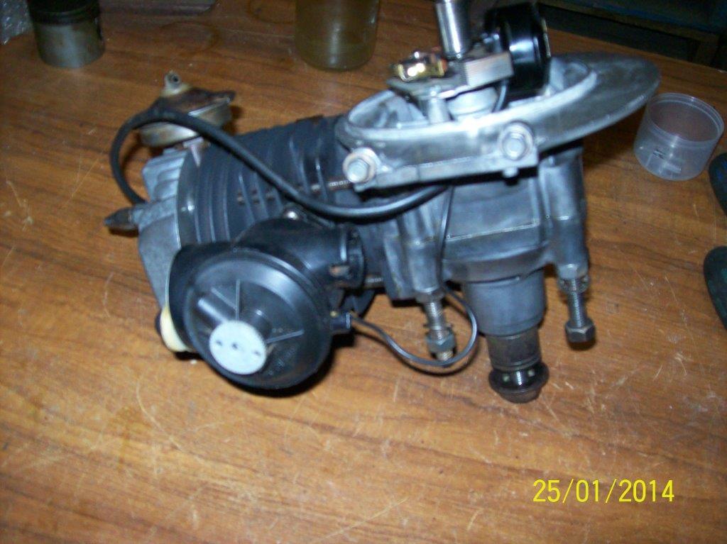

Crank is like the one pictured here.I guess there called a full crank as where the conrod connects there is a balance weight top and bottom and the top connects to the flyweel and the bottom connects to the cutting disc.
A powertoroque engine does not have that,are not know as full crank engines.Sorry don't have a picture of that.
Engine number is on the bottom part of the crankcase opposite of the cylinder,like this.
Post your engine number up if you like and I'll try and date it for you.
Here is some other pictures of what the engine looks like.

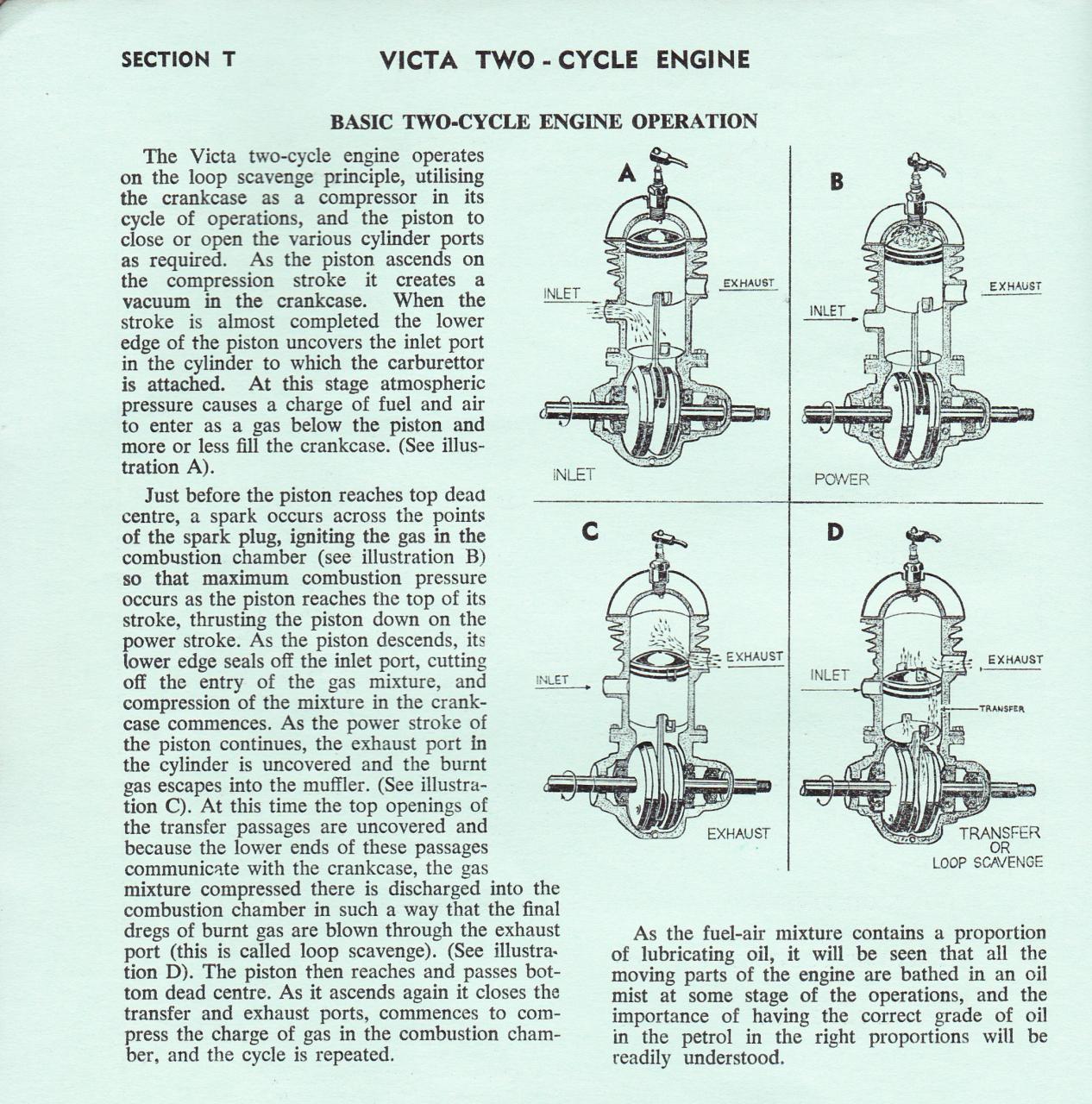

Ok, I'm showing my ignorance but how does the crank bearings get lubricated if the oil is only in the fuel mix?
Or have I never changed the crank case oil in 30+ years... lol
Cheers, Bert
Bert #56899 09/07/14 05:37 AM
No Bert that is a great question and if you'd never looked at it before and or told you'd never know.
The best way really to explain is via a scan of a document I have here.

Thanks, well that just answered a life long question!
Castrol GTX has been a good choice even tho I never realised the significance.
