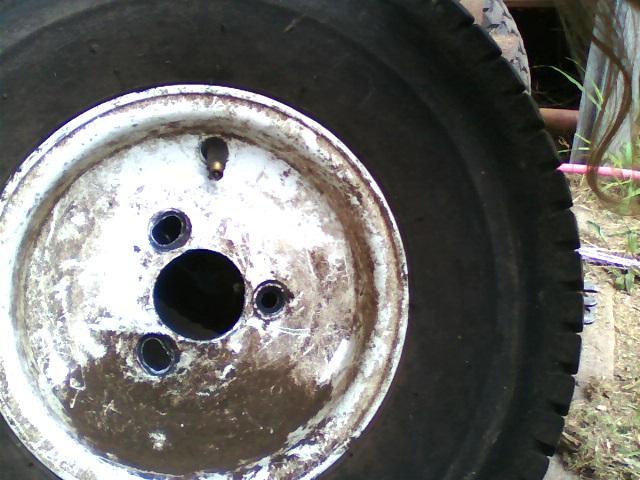

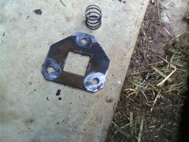

One of my back weels came of. Its hanging on 3 points where 1 broke of. All the nuts are gone. And i think i lost a bit that is made to lock the differential. I`v never used the difflock and its behind my catcher.
I made some pics and i hope that there will be someone who can explain to me what to do and what bits i miss.
thanks in advance!
Steffan [Linked Image]
It looks like the holes in the wheel are so worn out that i need a new wheel? Any tips??

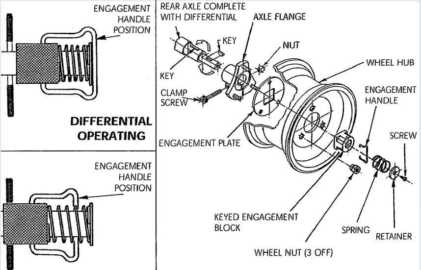

You do need a new (or at least better) wheel, and you need to push out the stump of the broken wheel stud and fit a new one. They can usually be removed easily with a hammer and pin-punch. However it is best to remove the hub before you do that, so you won't be hammering against the differential in the center of the axle.
Here is an illustration of a hub and diff. lock that looks fairly similar to yours:

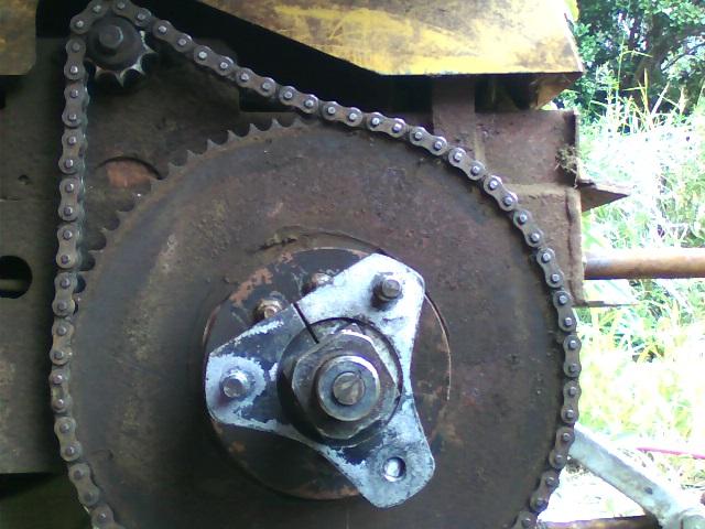

Hi steffan, I would recommend that you check the chain and sprockets, the top one is very pointy and looks to have reached the end of its service life. wink

Thanks so much, i first deal with the wheel and then I will have a look at the chain and sprockets.
Thanks for pointing out to me.

Do you mean the wheel stud on the axle flange? The axle flange only comes of with an Oversize allankey.
The wheelhub ( as in the picture) is already of.
I go to the shed and give it a go.

wheel stud is out. Now i need:
1 wheel
1 wheel stud
1 retainer
3 nuts(for on the wheelstuds)
1 engagement handle.
1 wheel.
Any idea if i can get this sort of stuff online? I am 1 hour from the nearest mowershop and they only sell original greenfield. Are there cheaper options? Thanks
