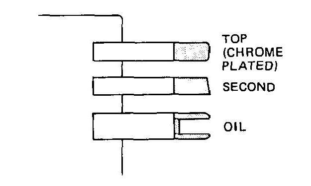

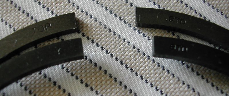

The rings are marked (top STD, Y STD)
You probably know this Mark, but the rows of tiny holes in the emulsifier should be checked individually. My way to do that is, after treating with carb cleaner and blowing out with compressed air, I push the correct size of jet drill bit through every hole in turn. I do the same thing with the main jet of course, and the idle jet ("Pilot Jet" - black plastic item, directly under the idle speed screw). I don't necessarily remove the idle mixture screw ("Pilot Screw"), if carb cleaner squirts out from the tiny hole near the throttle butterfly.

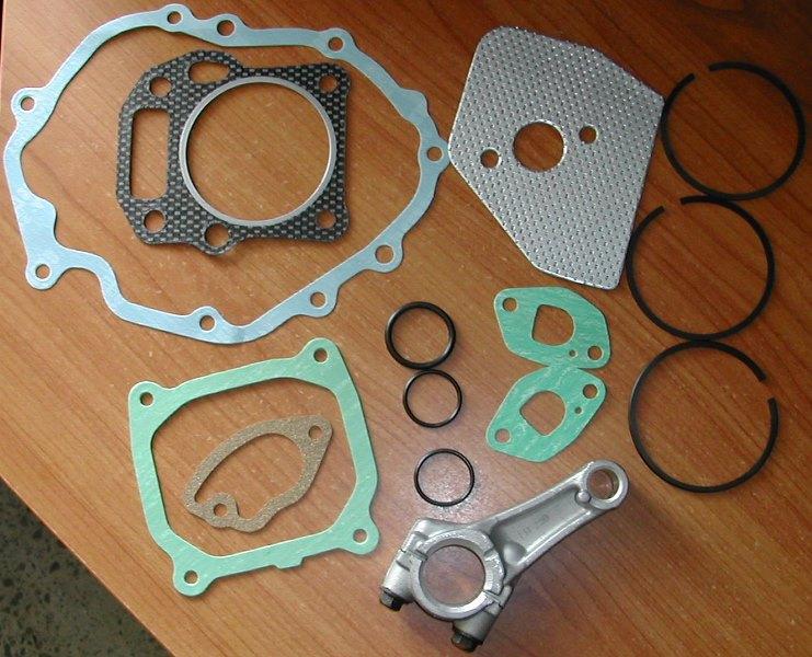

If that set you have is the rings-and-gaskets kit from Thailand, I don't think the rings will be chromed. I've used the Thailand unchromed rings (which probably come from China) and they worked fine, but after 6 hours use I replaced them with chromed ones just so I'd feel better about the repair job. The unchromed ones should last about as long as they do in a side valve Briggs, which would satisfy nearly all private users. (Original Honda GX/GXV engines have chromed top rings, though only the late production ones had chromed, steel rail oil rings. The older ones have plain cast iron oil rings, which wear out after say, 3 years of contractor service. Chromed steel rail oil rings should last considerably longer.)

The kit I got was from Thailand.

Things I have done: fitted rings, oil ring is obvious, the ring marked (Y) I put as the second ring, the ring marked (T) I put as the top compression ring. All marking facing up as you look at the crown. I spaced the gaps 120 deg apart.

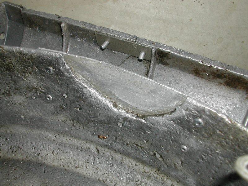

I made sure not to forget the black plastic pipe (not sure of its role, drain or pickup?)

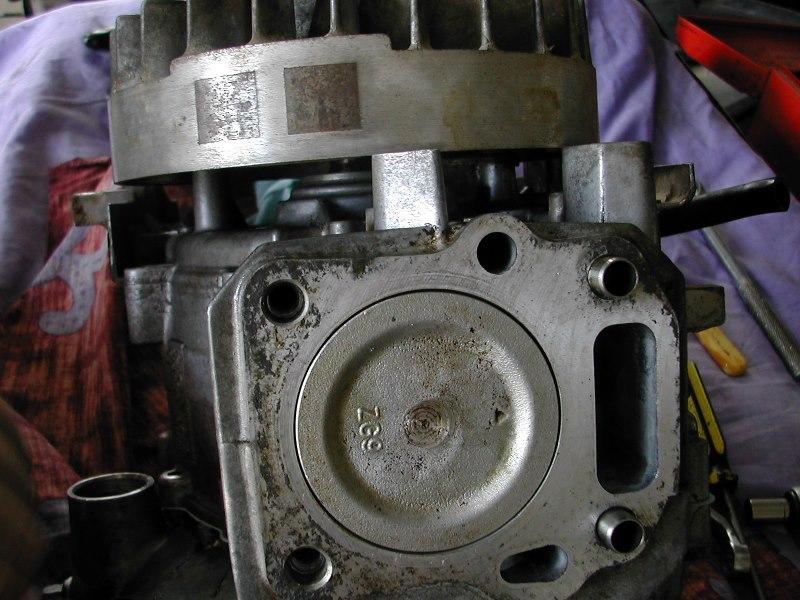

The arrow on the piston crown is facing the push rods.

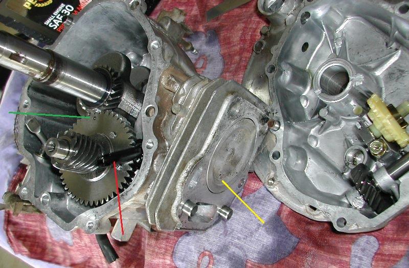

also aligned the timing mark on the camshaft with my scribed mark on the crankshaft gear.

Not sure what the o rings in the gasket kit are for?

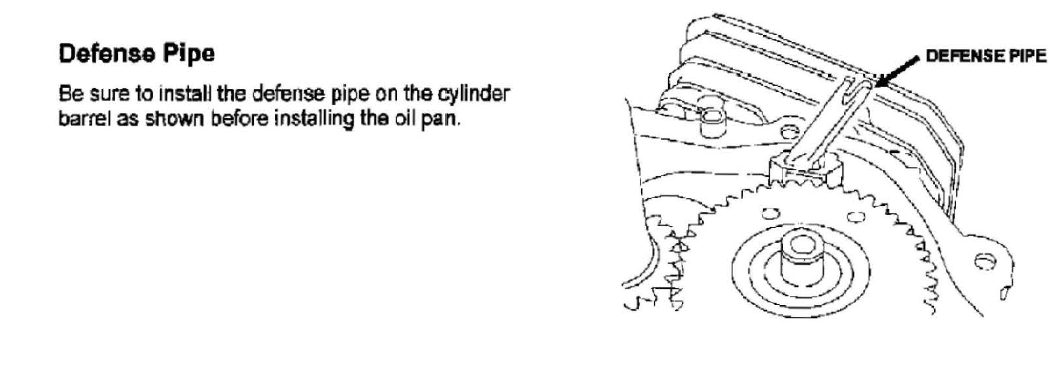

That black plastic pipe in the crankcase is called the "oil defense pipe":
Its purpose is to keep oil slung off by the rotating parts, from going into the breather drain hole (which is after the PCV valve, so it would end up going through the rubber breather hose into the air cleaner). Don't put it on facing the wrong way, or it will pick up oil instead of draining it.
I tend to bump that pipe occasionally, and actually knocked one off once, but it clipped right back on, undamaged. It is soft plastic.
I haven't used a gasket kit, and I'm not aware of what the O rings are for either.

I don't recall the second ring having a Y on top, I thought I recalled it had a T like the top ring. The T means top of the ring, not top ring. You can identify the second ring if you look at it carefully, it is tapered to act as an oil scraper:

The pipe makes sense now, I found that mine only fits one way.
The con rod is the right way, with the larger side inline with the arrow on the piston.
I measured both rings with the micrometre, width and height and also compared them with the old ones.
I found the one marked (T), slightly larger the one marked (Y).
So it is installed as the compression ring.
I looked for the taper, I didn't notice it, both looked square to me.

I haven't tried to fit the oil defense pipe backwards, I just carefully install it the right way around. I agree the offset connecting rod installs so that you put the cap on from the left side.

One of the rings is actually marked TOP not T. My over sight.
They are also different colours, the TOP ring is light grey. Don't know if you can pick that up in this image.
The old top ring is chromed and unmarked.
The old second ring is marked O.
None of these rings seem to be tapered.

I'm glad you checked those circlips - having one pop out is a very nasty failure mode, and I like to double or triple check them.
Honda's top ring is radiused on both top and bottom edges, it doesn't have a top. IIRC, I haven't seen a top marking on their original equipment rings. The "TOP" on the lighter coloured replacement ring might signify that it is the top ring. I don't like that ring: it seems to have burrs on the top and bottom surfaces at the ring gap. That isn't the kind of finish you get from Honda. If it were me, and I could feel the burrs with a finger-tip, I'd remove them carefully with a light touch of a needle file, then clean the swarf off. However you must hold the needle file flat along the top and bottom surfaces of the ring - don't just file it or you'll chamfer the edges rather than remove the burrs. They should clean up with one stroke, just a few centimetres of total movement of the file, with light fingertip contact pressure. There shouldn't be noticeable file marks on the top and bottom surfaces, just a sort of dull look, except where the burr has been.

Just wanted to check the timing before going any further.
I have some images at TDC.
Magnets just passing magneto, piston at TDC.

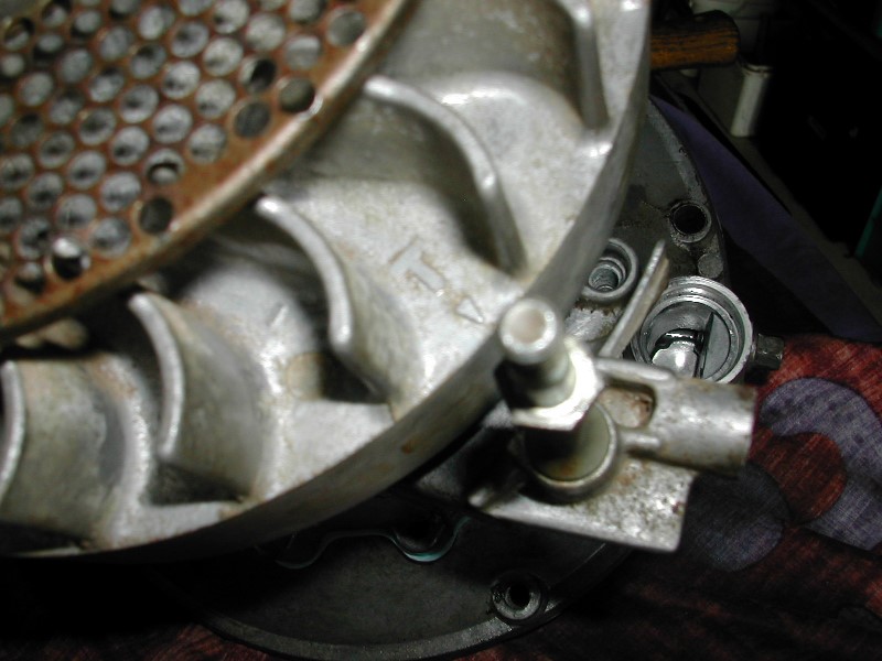

Mark on the flywheel is inline with the rear post, I thought this mark should line up with one of the magneto posts?
I can find it, I will keep looking.
Joined: Feb 2011
Posts: 510
I have found it, I was getting the mark on the flywheel mixed up with the starter cup mark, this is what I was trying to remember from when I pulled it apart.
I can't see how you can mess up the ignition timing on that engine Mark - if you've found a way I'd be interested. It seems to me that if you put the flywheel on the key, and bolt on the ignition unit in the only place it will fit, the timing is correct.
There is a reason to have the TDC mark. Because Honda does not use a timing mark on the crankshaft timing gear, to reassemble the engine without making a timing mark, you have to put the engine on TDC, then slide the camshaft timing gear into position so that its timing mark is at the closest possible point to the hub of the crankshaft timing gear. Because the timing gears are helical, of course you have to lead it a bit so that by the time it rotates as it slides down into place, it is as close as possible to the crankshaft. Kind of reminds me of duck shooting.

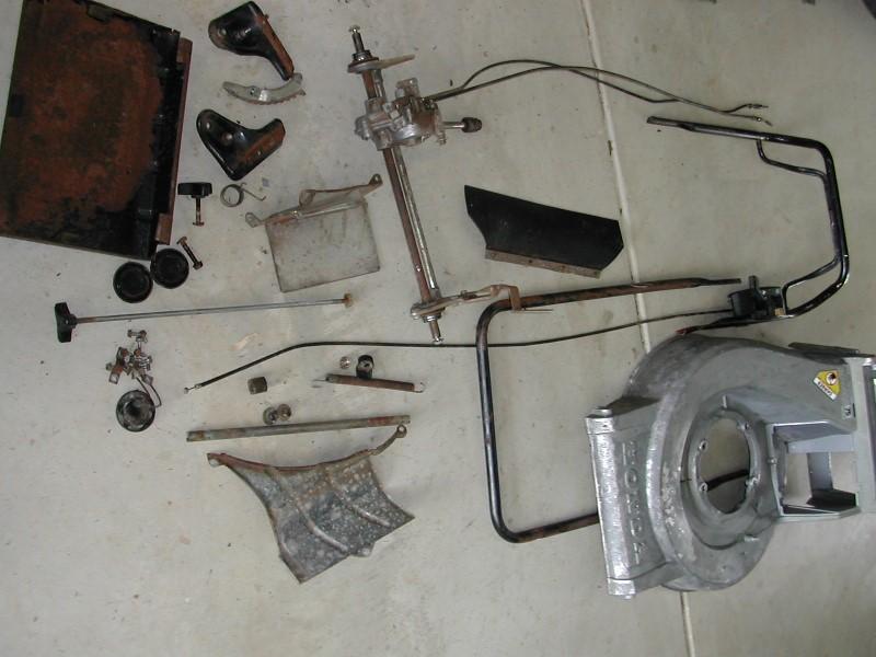

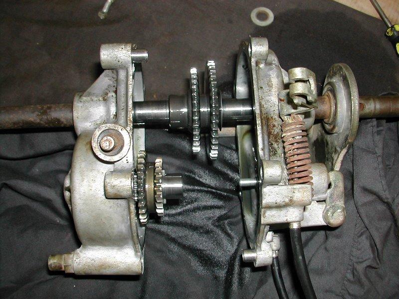

All 3 cables were seized up, speed select, stop run cable and SP cable. I snapped the stop run cable, the inner core was rusted solid to the outer, You might notice where I silver soldered it in one of my images just so I could test the motor.
I cant free up the SP speed select cable, the SP cable moving but I will replace it.
I operated the self propelled and it didn't work. I thought the worst - faulty gearbox or cable not set right, then I noticed the rear axle spinning but not the wheels. I ended up having the drive ratchets on the wrong wheels.
The one on the left side in the image goes on the right wheel. obvious now looking at the pawls.
