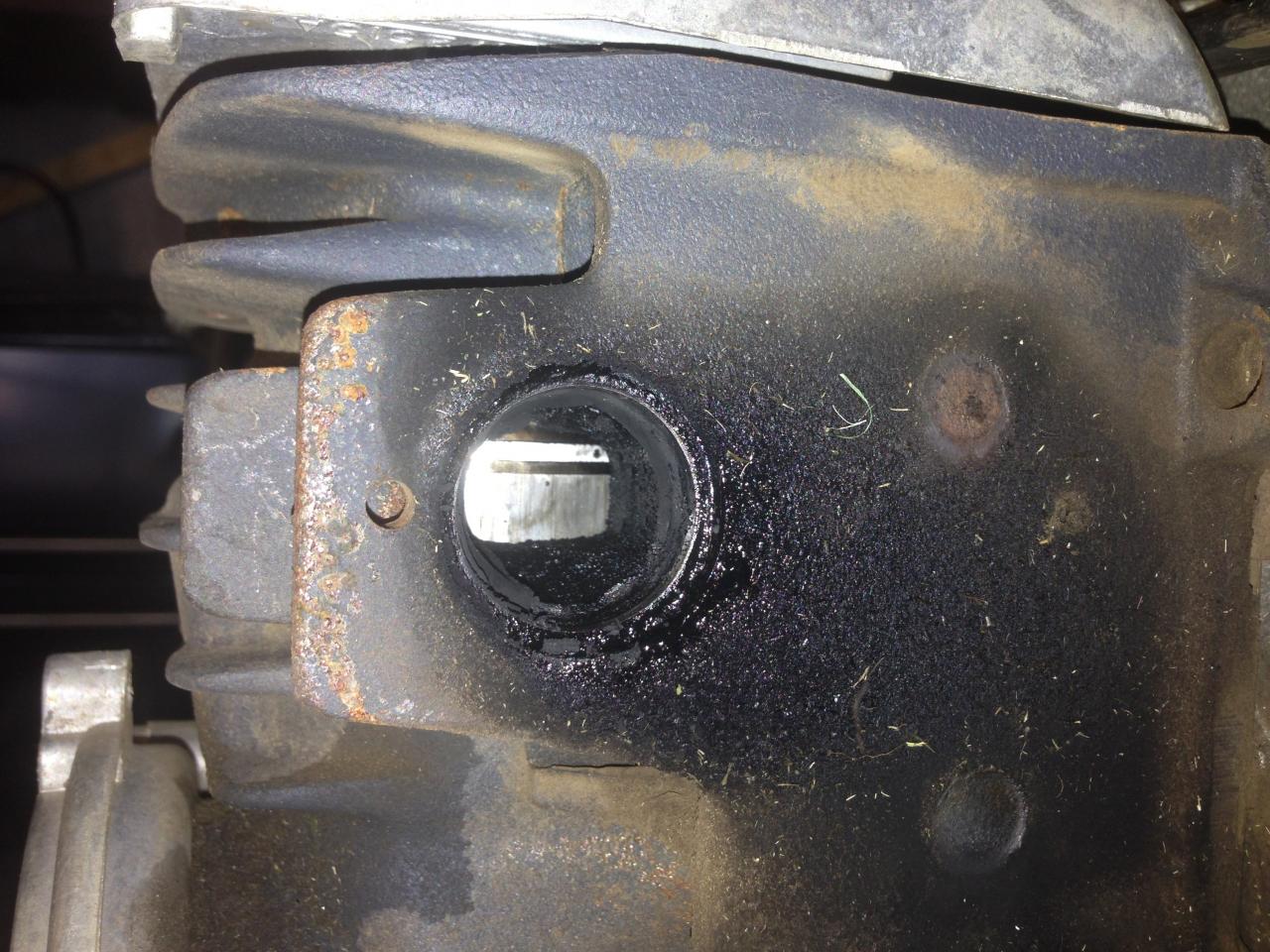

This is the exhaust port with muffler removed, not sure how bad that is?
It's fine, but there is oil build up.
How are the ports on the muffler?

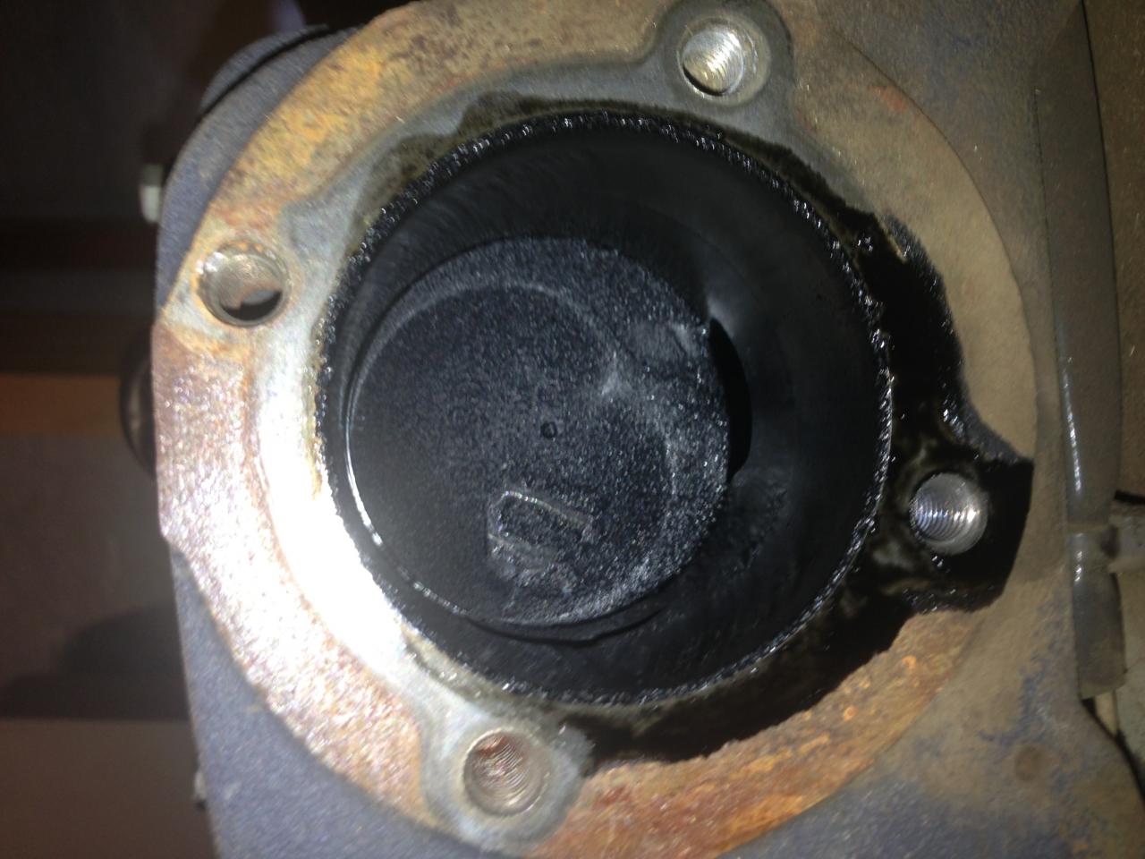

Muffler was not restricted, can blow through it, was carbon on exit port of it
Top of piston i can see is saturated with gunk, will remove head n clean now[Linked Image]

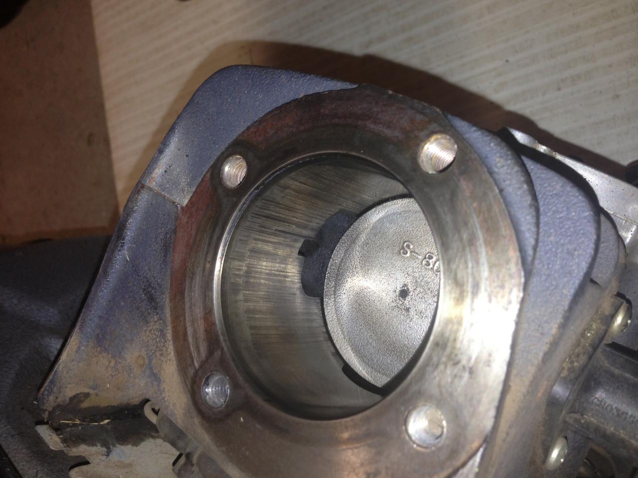

Looks like there is some scoring near the exhaust port inside the cylinder?

Bump, any opinions on cylinder condition?
Hmm, I would hone it, and see how it's looking after that.

Suprised no one said the evidence looks like a leaking head gasket?
To me, it looks more like run out when it was opened
