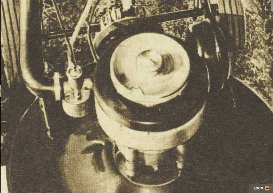

I have also heard the Automatic had the red "tickler" on the carby? can anyone confirm this?
Posts: 6,938 Likes: 322

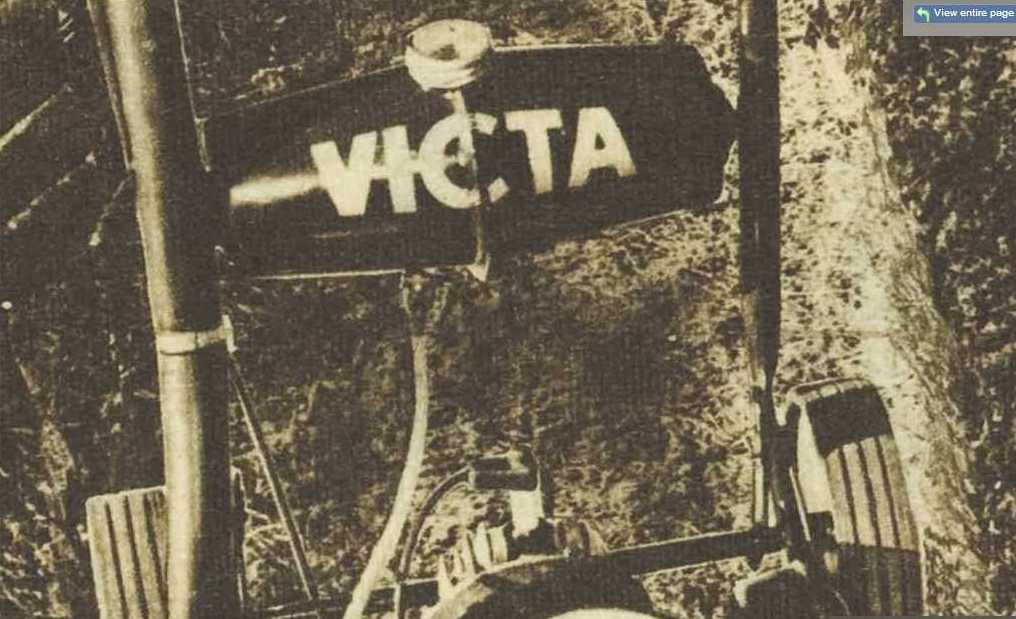

Hi ODK members, The Red Tickler is confirmed:- ![[Linked Image]](https://www.outdoorking-forum.com.au/forum/uploads/usergals/2013/12/full-7392-13984-victa_automatic_page_3.jpg)
Posts: 539 Likes: 2
Thanks Jack, that would have been were I seen it, I just could not remember, this info needs to go into the Automatic thread also for later reference, cheers
