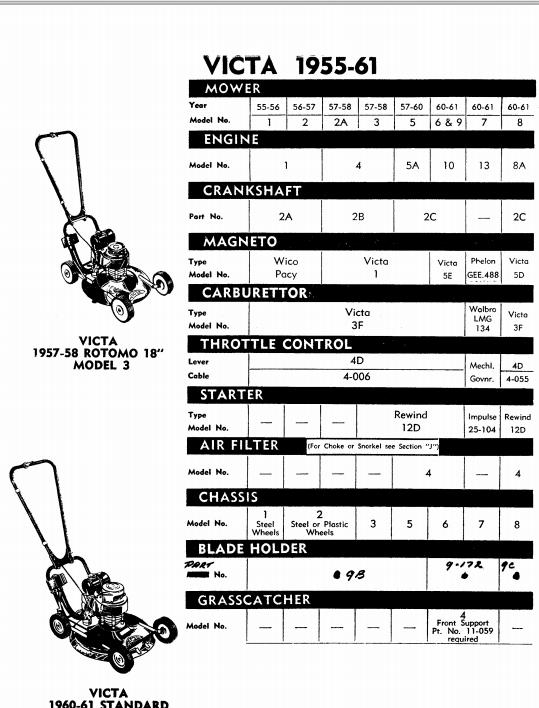

I know a number of the parts books and guides for the era do not cover it, i dont have my green book handy, but in my gregory's manual, there are no automatic specific parts.
I also know in the later part of it's lifespan, they released it without the flaps ir governing, essentually making it a model 5 with automatic badge. Also, it never received a v code.
Originally (I don't know the numbers)(I'm not sure anybody knows the numbers) there was a set numbers made. Lets say 40,000 mowers. So everything went into production and the automatic was born. Now they just weren't working the they were surpose to. All sorts of different problems,now remembering production was in full swing at this time. Couldn't just stop as that would be a huge waste of money. So to get over this problem the automatic was stopped and they then proceeded with the model 4 standard. Which was the automatic minus the guards flaps etc.The model 4 standard still the the handle badge still marked automatic. After all they had been made all the parts.The model 4 standard was born. Yes they had a victacode,just can't remember it off hand. To the green book question yes and no. I know that sounds silly but some of the earlier prints had them in it. The theory is that when it flopped dealers were told the throw out the automatic pages. So there are some but they are as rare as the mower itself.
Hope this is of some help.
They would have had a parts code at the time, but I certainly can't find evidence there vas any V-code assignment (The V-Code being the designated parts code system Victa released in 1970 I beleive) at the release of the V-Code system, V-Codes were assigned to prior models right back to the Model 1, however the Model 4 is not mentioned at all in the V-Code release papers, assignemts going 2a (V3) Model 3 (V4) Model 5 (V5) as below.
Also, in one of the parts guides (1955 - 1969, available on Victa's website from 2007 - 2009) there is also no model 4, again, 1, 2, 2a, 3, 5.

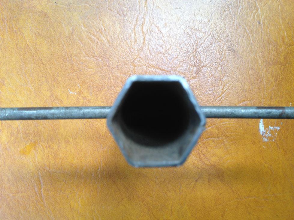

OK guys, so I got myself a little gem the other day that I will post up some details about as there has only been speculation about, The straight Tommy bar plug spanner, also touch on the bent Tommy bar spanner. So check out the headings for each pic for any details. As previously mentioned the straight bar was used for the Romoto and the Automatics until the idea to include a toe ring tool (hoop/spring/clip on type) and the other end to assist with the height adjuster this is the last pic of the bent Tommy bar spanner.
The Straight Tommy bar spanner has a bar 153mm = 6" long it is 6 and a tad mm = 1/4" thick.
I have knocked the bar out to show how the bar is held in to the main body of the tube spanner, these dents around the bar seem to be just done with like just a small cold chisel of sorts to deform the bar just enough to hold it in place.
just a couple of pics showing the ends in good condition.
Bent Tommy bar spanner.
I hope this info can be of use to someone as I know myself I was looking at how to replicate an original Straight Tommy bar spanner as these originals are getting far and few between. cheers2

Jonesy, re the straight tommy bar, those measurements and images match mine exactly - nice work keeping this thread going also mate!
Posts: 539
Ah good to confirm yours is the same, been waiting for you to chime in on the straight Tommy bar spanner, at least that should confirm as correct. No worries, there is always something to post about these machines and if I can play a small role in confirming details about the Model 4 Automatic (or any of these fine Victa's) then that will help with archives for all in the future. rockon
