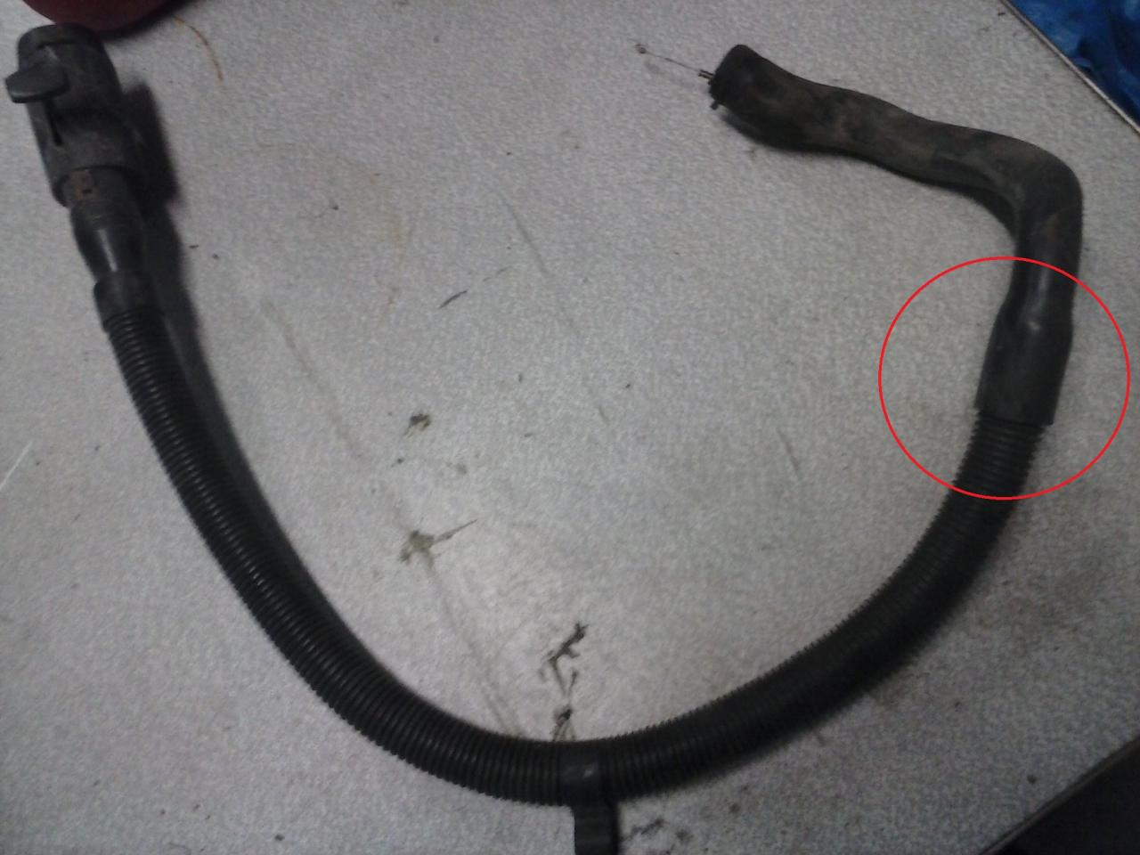

been tinkering with victa 2 strokes for a long time now they were all i ever touched once ! , as far as the snorkel goes the air cleaner pipe is a pretty standard size about 32mm should be able to dummy somthing up. ill wander out to the shed and take a picture of what ive done in the past.
Joined: May 2012
Posts: 467
ok so this part is off a later victa 2 stroke with whats known as a g4 , its has the throttle cable running inside the snorkel , local mower shop should have one you can use . remove the rubber end (or trim the rubber and use the bend ) remove the throttle control and cable from the other end . you can get away with just pushing the pipe on to the carby like pictured and also onto the air cleaner . make sure you re-use your hose clamp for good measure. ![[Linked Image]](https://www.outdoorking-forum.com.au/forum/uploads/usergals/2013/08/full-5911-12369-cam00194.jpg) ![[Linked Image]](https://www.outdoorking-forum.com.au/forum/uploads/usergals/2013/08/full-5911-12370-cam00195.jpg) ![[Linked Image]](https://www.outdoorking-forum.com.au/forum/uploads/usergals/2013/08/full-5911-12371-cam00197.jpg)

The spare snorkel i have is the corrugated type from the powertorque engines. I didn't manage to get the rubber radiator type hose which was the old snorkel off the mayfair over the corrugated hose, the rubber hose didnt have enough give. Can anything be done to stretch the rubber hose over the corrugated one?
Joined: May 2012
Posts: 467
Hey man . don't think its possible to strech it over the corriggated one . but the corrigated one will do the job until you find a rubber one

oh ! i get it now , did you use the rubber bent end that was connected to the corrugated pipe ? would give you a few more inches
Joined: Mar 2008
Posts: 612 Likes: 1
Joined: May 2012
Posts: 467
the one i had in the photos had a rubber end with a wide section to connect to the corrugated pipe ![[Linked Image]](https://www.outdoorking-forum.com.au/forum/uploads/usergals/2013/08/full-5911-12414-cam00194.jpg)
Joined: Mar 2008
Posts: 612 Likes: 1
I tried to widen the rubber hose to match what you had but there wasn't enough give in it. I'll try the Reject Store to get some hose. Rang 2 mower shops and they didn't have any hose.
