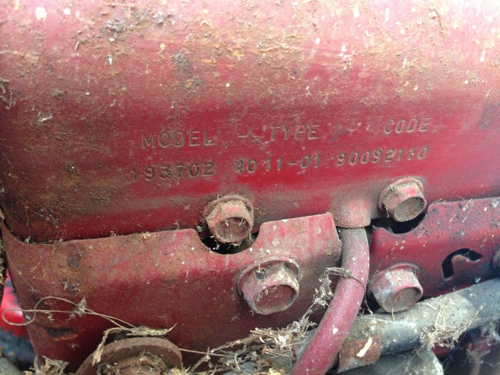

Adam, on the spark plug end of the engine (front) you will find Model, series & code numbers pressed into the engine cowel, if you post them up, some of these fine gents will be able to give you an accurate year etc.
Joined: Jun 2013
Posts: 7
Thanks again, are these the numbers ?
[Linked Image from i174.photobucket.com]
Yes, that is the Model, Type and Code for your engine. Here is the Illustrated Parts List:
http://bsintek.basco.com/BriggsDocumentDisplay/Z6opwCVJ1DajI.pdf
http://bsintek.basco.com/BriggsDocumentDisplay/msozHP-K_ny7tH217FzoPu.pdf
The engine was made on 21 September 1990. I can't tell you the location of the plant where it was made, because it appears that it no longer exists.
The engine is of 19 cubic inches displacement, it is of the third design generation, has a vertical crankshaft, a Flo-Jet carburetor, plain main bearings, and a rewind starter (not an electric starter).

Awesome... Makes sense date wise, i guess it actually got a new engine not a rebuild...
Might see if it will start tomorrow....
Thanks again for all the great info..
