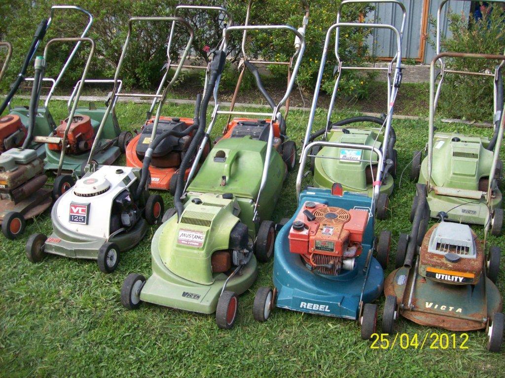

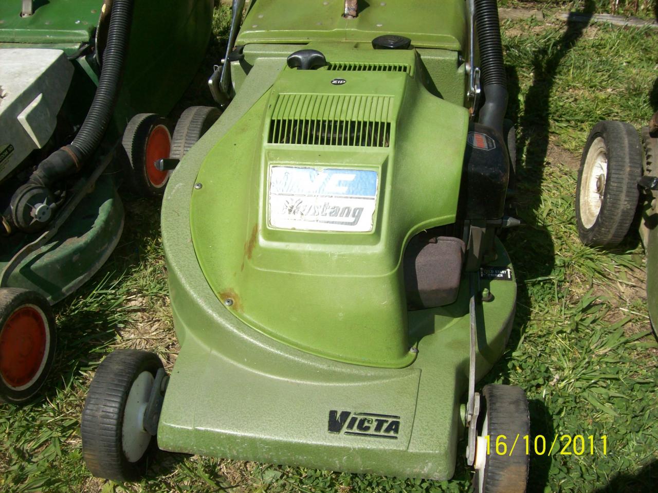

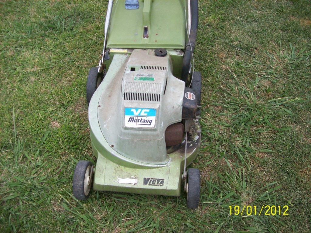

hello again. i have once again a puzzler. at least a puzzle for me anyway. i have taken an interest in the vc mustang range of victas 70S era. i try and try to find info on these mowers but you cant find too much about them. someone of you may know their history?.ive inserted 4 pics of from what i can tell are different year models. does someone with the know which is which from these. once again cheers bazz. ![[Linked Image]](https://www.outdoorking-forum.com.au/forum/uploads/usergals/2013/04/full-5742-10285-mustang_1.jpg) ![[Linked Image]](https://www.outdoorking-forum.com.au/forum/uploads/usergals/2013/04/full-5742-10286-mustang_2.jpg) ![[Linked Image]](https://www.outdoorking-forum.com.au/forum/uploads/usergals/2013/04/full-5742-10287-mustang_3.jpg) ![[Linked Image]](https://www.outdoorking-forum.com.au/forum/uploads/usergals/2013/04/full-5742-10288-mustang_4.jpg)

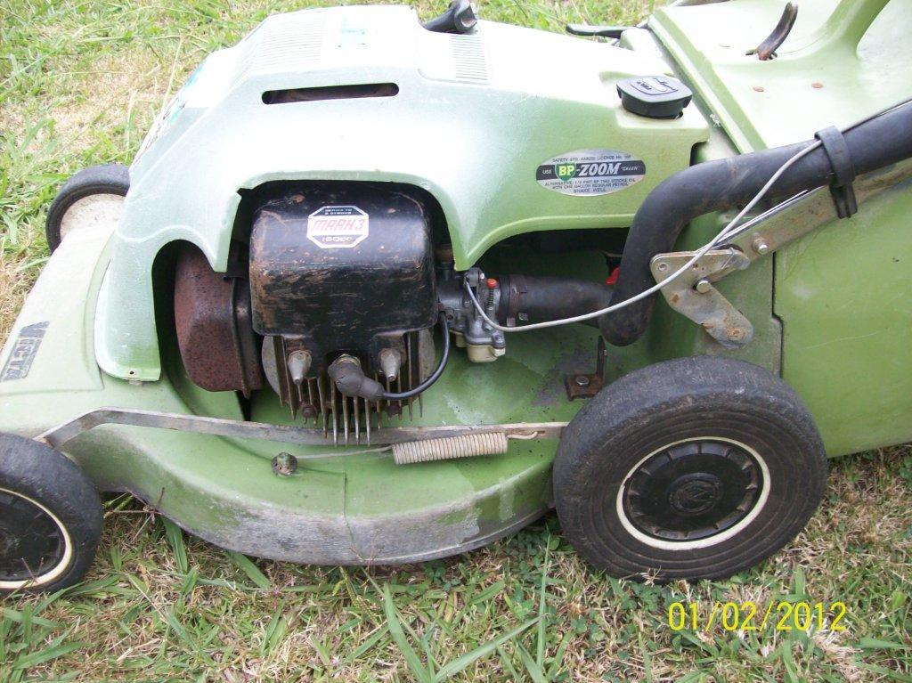

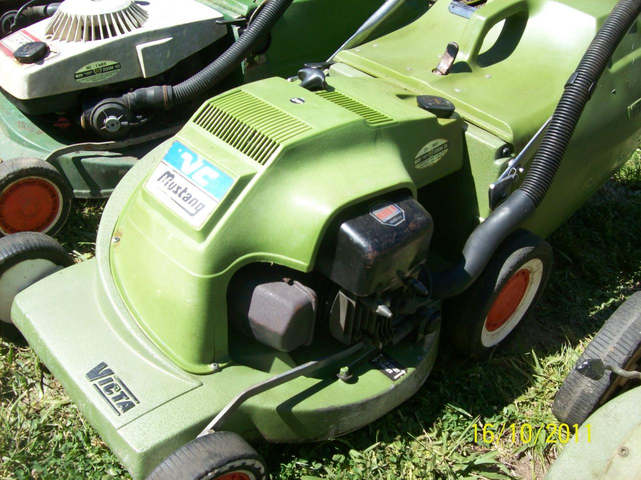

Well yes there are a few different models of the VC-Mustang.The VC-Mustang was the replacement model from the VC-160 series.The first model was:VC-Mustang Mark I 1974-74 160cc G3 carby. ![[Linked Image]](https://www.outdoorking-forum.com.au/forum/uploads/usergals/2013/04/full-5048-10291-100_1843.jpg) ![[Linked Image]](https://www.outdoorking-forum.com.au/forum/uploads/usergals/2013/04/full-5048-10292-100_1868.jpg) VC-Mustang Mark IV 1977-78 G4 Carby. ![[Linked Image]](https://www.outdoorking-forum.com.au/forum/uploads/usergals/2013/04/full-5048-10293-100_1659.jpg) ![[Linked Image]](https://www.outdoorking-forum.com.au/forum/uploads/usergals/2013/04/full-5048-10294-100_1660.jpg) Unfortunately I don't have a Mark II or III at this point.There wasn't a real lot of different's between the four. There is a few other variations of these models.I also have a Red VC-Mustang (which I don't have any pictures of at this stage).Which I might add does have the red VC-Mustang label. I'm not too sure what the picture of the red label on the green cowl is.I'm just wondering if that is the picture of the one Ty had.As somebody had changed the cowl and swapped stickers over. The two with just Mustang on the label are the series 80's.Which yes was made in the 1980's.I know this as they were my mowers.They were basically the new era so the VC was dumbed out of the name.There was also some imported models which we have recently found,but I won't go into that now it just gets more confusing,and we can't work out exactly what the true story is,except they were the export models.If I get a chance I will take some pictures of the red one and maybe I could have the Mark II or III as I have a couple which are not complete right now.Hope this helps.
Posts: 585 Likes: 9
wow . truly awesome info.thanks a bunch Blumbly. i have definately now got the mower bug i am afraid.i just love the look of that mustang cowling. its taken me a while to grow accustomed to the more modern mowers . but i think its going to be a good project too.may the search begin. he he

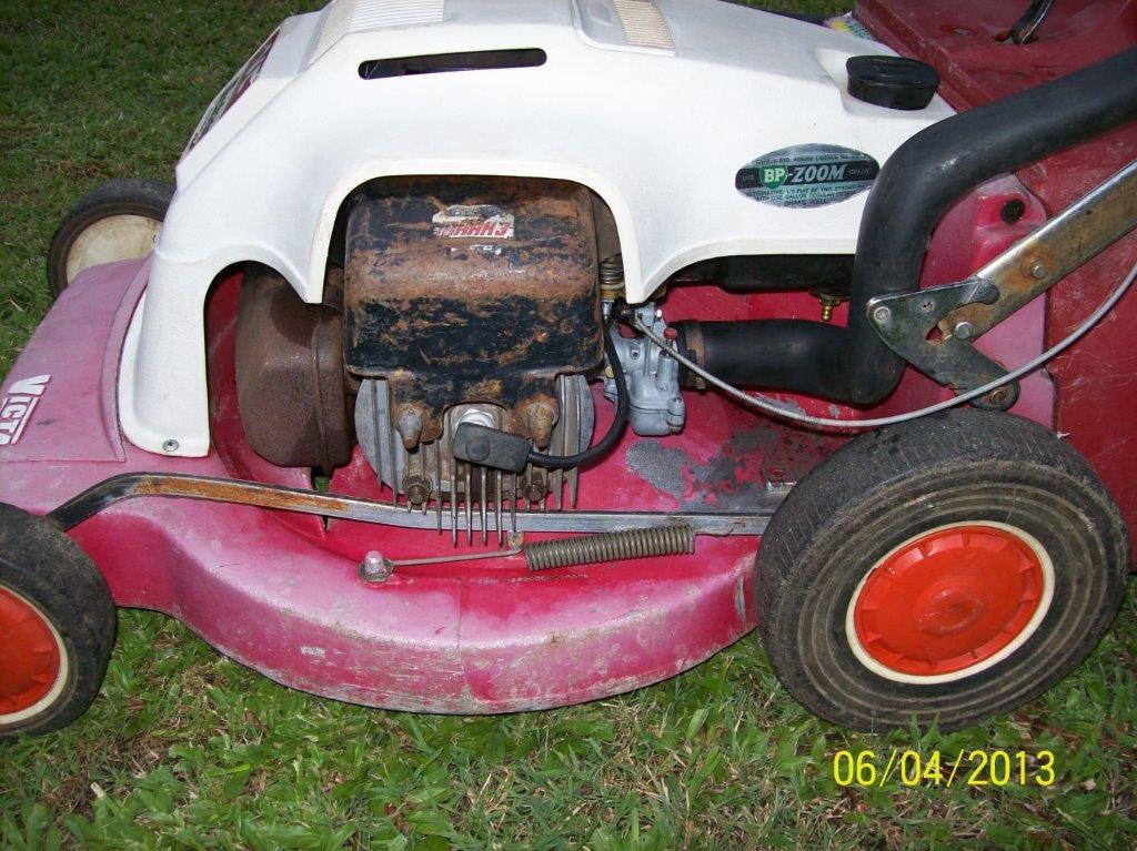

OK after doing some research over the weekend I can only find four different variations of the VC-Mustang. 1973-74 V135 G3 carby (with remote fuel tap) that comes in two colour. Green and Red. ![[Linked Image]](https://www.outdoorking-forum.com.au/forum/uploads/usergals/2013/04/full-5048-10389-100_1860.jpg) ![[Linked Image]](https://www.outdoorking-forum.com.au/forum/uploads/usergals/2013/04/full-5048-10390-100_1868.jpg) Red version ![[Linked Image]](https://www.outdoorking-forum.com.au/forum/uploads/usergals/2013/04/full-5048-10391-102_0761.jpg) ![[Linked Image]](https://www.outdoorking-forum.com.au/forum/uploads/usergals/2013/04/full-5048-10392-102_0769.jpg) 1976-78 V207 G4 carby (This one has a remote primer) not all had that. ![[Linked Image]](https://www.outdoorking-forum.com.au/forum/uploads/usergals/2013/04/full-5048-10393-100_1659.jpg) ![[Linked Image]](https://www.outdoorking-forum.com.au/forum/uploads/usergals/2013/04/full-5048-10394-100_1660.jpg) 1976-78 V207 VC-Mustang S These are the only pictures I could find.(Unfortunately I haven't been able to find one myself)Bugger. ![[Linked Image]](https://www.outdoorking-forum.com.au/forum/uploads/usergals/2013/04/full-5048-10395-full_5264_6613_mowers_013.jpg) ![[Linked Image]](https://www.outdoorking-forum.com.au/forum/uploads/usergals/2013/04/full-5048-10396-full_5264_6614_mowers_014.jpg) After these I believe the VC was dropped from the name and they were just known as a Mustang.Like this one below. ![[Linked Image]](https://www.outdoorking-forum.com.au/forum/uploads/usergals/2013/04/full-5048-10398-100_2073.jpg) Sorry about the picture I don't have this together at the moment. If anybody knows of any different variations of the VC-Mustang please post it up with the year and a picture as I'm curious to know if there is any other variations.Especially between the years of 1974 to 1976 as there is a cap there.

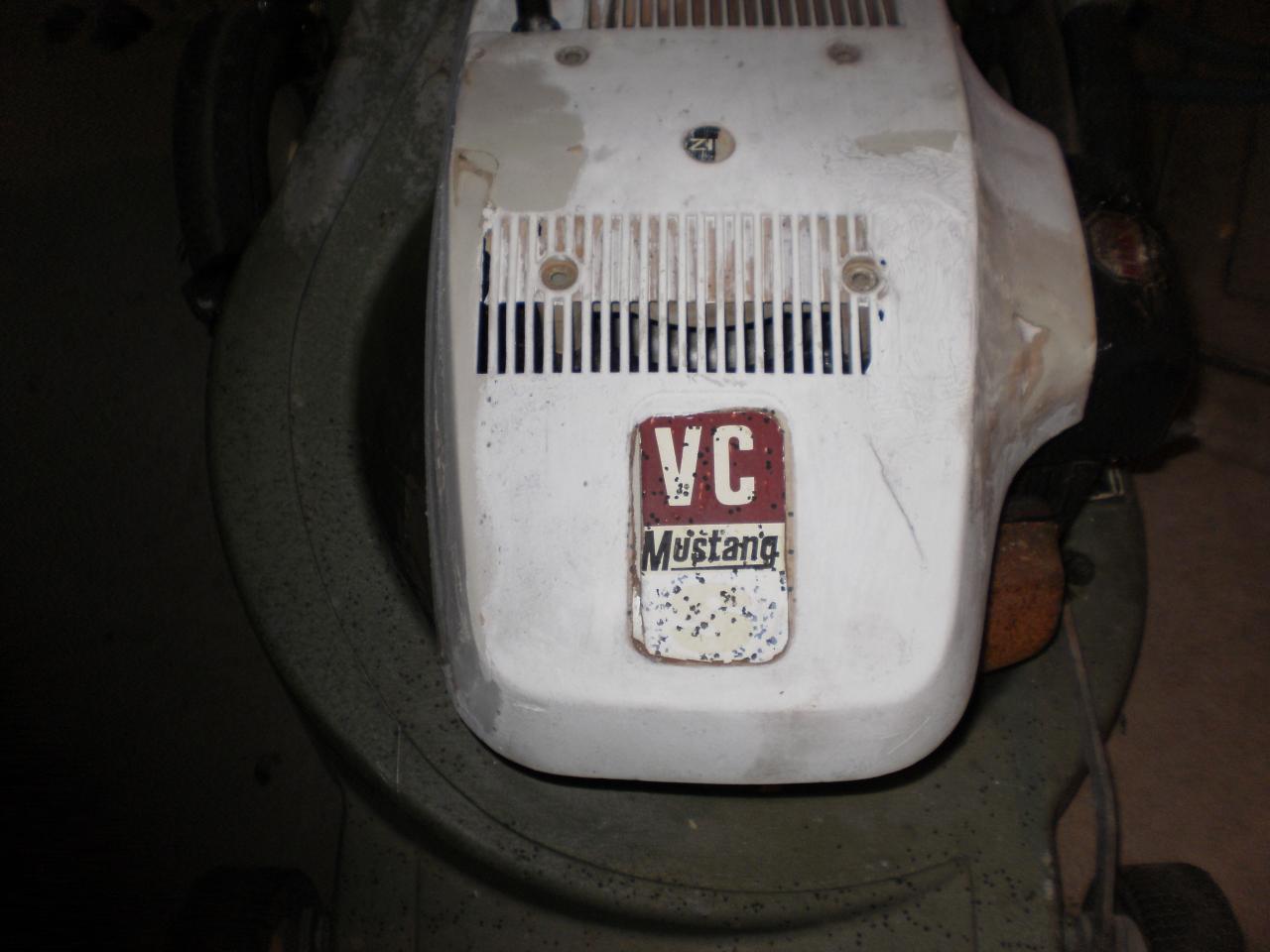

yay i got one of these babies for 15 bucks.Bargain... it has the wrong catcher! so will it ever end? methinks not.
Posts: 4,291 Likes: 4
Posts: 585 Likes: 9
like this one ![[Linked Image]](https://www.outdoorking-forum.com.au/forum/uploads/usergals/2013/04/full-5742-10470-1383187.jpg)
Joined: Feb 2013
Posts: 194

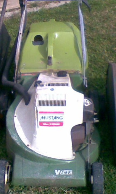

![[Linked Image]](https://www.outdoorking-forum.com.au/forum/uploads/usergals/2013/04/full-6515-10476-imag0026.jpg) Found this one on the tip a while back!!  Still goes  Base missing most of the other side and cowl is sad
Posts: 585 Likes: 9
wow .and still another colour.
Posts: 585 Likes: 9

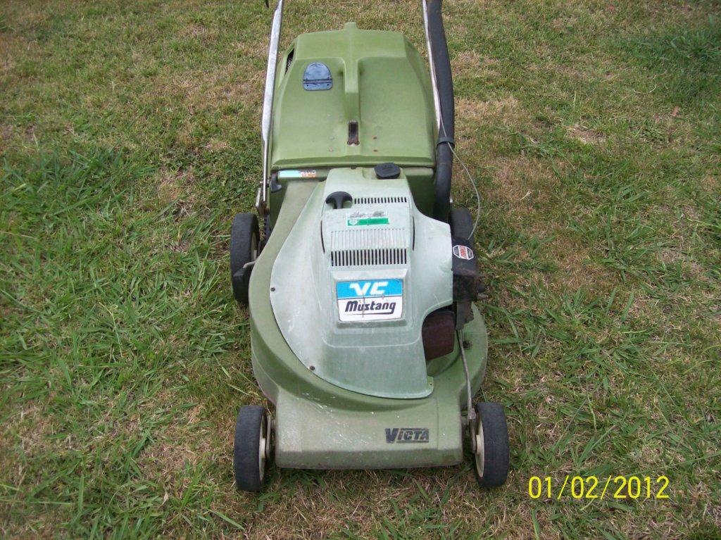

and i finally got one. think its the wrong catcher though. ![[Linked Image]](https://www.outdoorking-forum.com.au/forum/uploads/usergals/2013/05/full-5742-10780-mustang.jpg)
Yes that surely is the wrong catcher.
