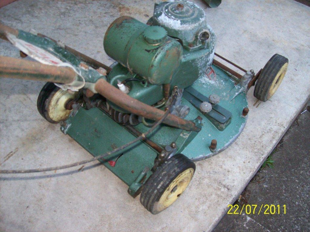

So I did a google image search and came up with this Predicta. still has the back flap, remnants of the front and has serial number 122228 - Pretty hard to argue this isn't the real deal...So now we are well over the 120,000 mark for confirmed Predicta's:
Omg! You stole blumby's Auto....lols. Yes its a real good example, and will restore nicely:) Is this the highest youve found so far unk? Pity that bloke never came back with his 125, 000 would have been good. Was looking at my 3 model 4's this arvo, all base models non auto 128, 000 and 154, 000 and 303, 000 trying to see anything . Surely they cant have gone over this 128, 000? If especially the first one is a base model....Anyways bring on more numbers! Doesnt jonesy have 2? One in the 120's also?
You found my Automatic on google? Curious? Arh yes the story with this one is that the bloke I got it off his father bought it new and when the front flap broke off he had it converted to the throttle set-up,and had the side guards removed as well(Unfortunately he could never find them,bugger).Then ran it for a few years until it stopped running (Still haven't had time to see if it goes).Bought a newer mower and then stored it under the house until a few years after his passing and then sold it to me.It had never had the engine changed,it did have the top and bottom seals changed (the bottom seal was leaking),which apparently the father did.As he did like to play around with mechanical things.I guess that's why it has some sort of sealant along the side.I just wish he could have found the side guards,I bet there still under the house.Also it would have been good if the brackets for the front flap weren't broken either as there are a few people making repo versions of them.
