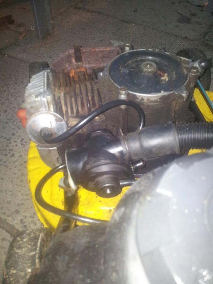

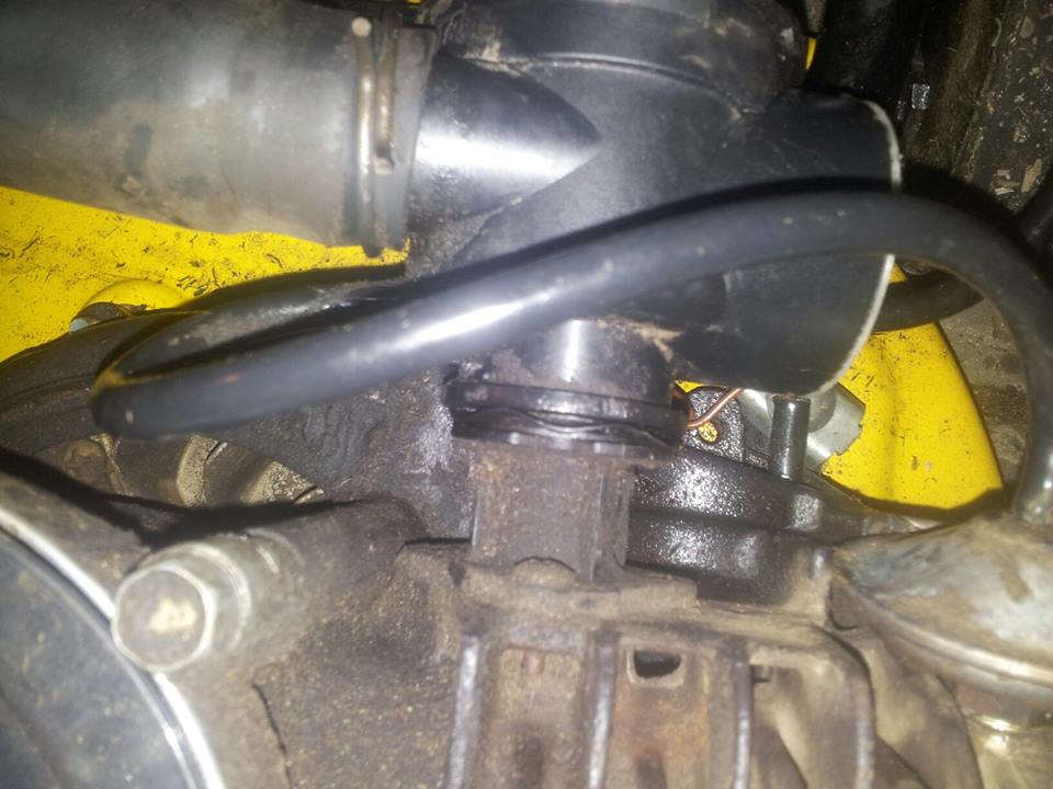

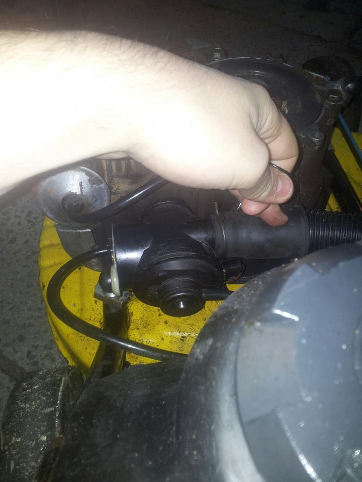

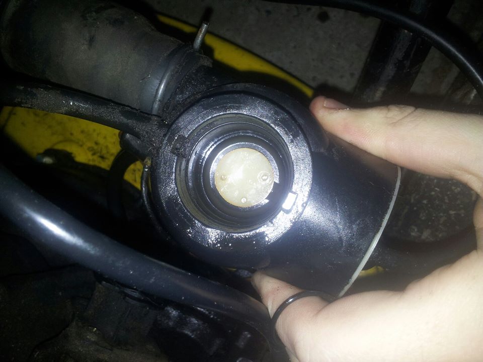

1st pic: Is this white circle what the o-ring goes over? or am i missing something?
2nd pic: The angle of the Carby(?) whilst I am pressing down on it.
3rd pic: The angle of the carby whilst I am not pressing on it.
4th pic: The "wavywasher", not connecting with the carby. Am i missing a spacer or?

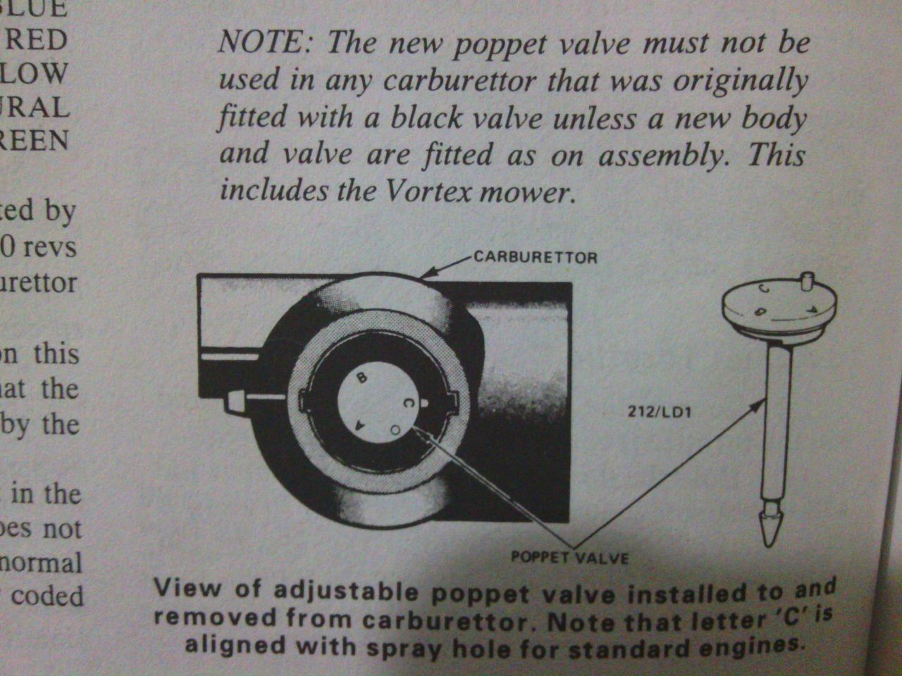

Looks like you got yourself in a jam jam princess, the oring goes on the same bit of pipe that your wavey washer is on,then push your carby over the pipe and slide it on over the oring this should give it a: tighter fit so first the wavey washer then your oring then you carby and it looks like you got the angle of the carby right. The white thing is a poppet valve . The poppet valve needs to
Have O on it and I think you need to turn it so the O faces in the direction of which the fuel goes in . Someone will probably be able to explain the poppet valve a bit clearer . Hope this helps you.oh and id say it's a 160.cheers,and there is a groove for the oring to sit in .

Roebuck: the poppet valve has marking "A" "B" and "C", and a little notch that i'm guessing helps spin it.
Joined: Apr 2013
Posts: 336
I'm sorry I can't remember which letter but I'm pretty sure it's c .
Posts: 104
Small Engine Technician
On your poppet valve you will notice 3 letters, A, B and C. They are there to assist you in positioning the poppet valve the correct way.
I have been taught that for all power torque engines the poppet valve must be set to 'C' next to the spray hole. Only exception is the Vortex engine it must be set to 'A'. If you set it to any other position it can apparently cause richer mixtures, lower governed speed and other abnormal conditions.
It's a victa powertorque engine, which yes, is a 160cc half crank motor.

Well I guess your picture verify's my post. And yes PrincessJamJam, I've always just used that notch sticking out to move the poppet valve to the correct position.

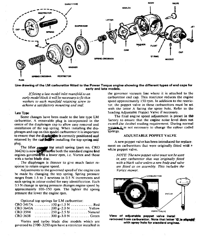

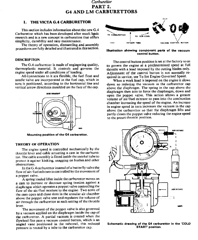

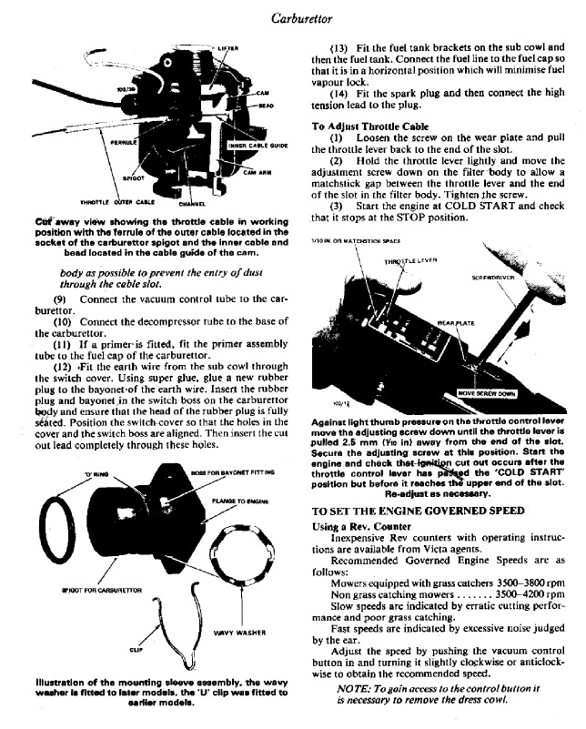

Wow this post has taken off like a bushfire on a 45 degree day with a strong westerly wind behind it.Anyway PrincessJamJam I found these files for a G4 LM carby of which you have it might explain it a little better than what we can.It does sounds a little like it may not be together right.
See how you go.
I do have some more pages of this part of the manual if you need them.

Sorry there I just giving you those diagrams so you could what is suppose to be in it and how it goes together.
Joined: Apr 2013
Posts: 336
That's all good, I just thought for a first timer it might be a bit dawnting but good lot of information all the same.
Well it looks a lot but you'd know yourself it's not that hard.Even more so it is good information for somebody starting at least they can see what's in them and how they go together.It's the best way to learn head first and make the mistakes we all learn from our mistakes not others.
