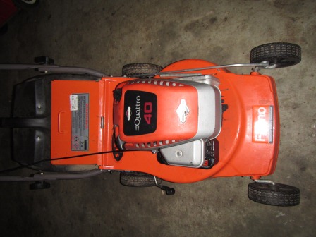

Hi Guys,
I have been repairing two stroke engines for a fair while now. I never really picked up any mowers of the four stroke variety that were not completely stuffed. i.e ran without oil.
This is until recently when I won this flymo on ebay for a whole $11. It came with a catcher which was a bonus.
With a little fiddling I managed to get it going.
So far I suspect the carby diaphragm and gasket need to be replaced along with a carby clean.
Oil Changed
Air Filter cleaned as it is pretty dirty
I will also put a new rope in as that snapped.
The blades also need to be replaced.
I would appreciate some tips on servicing this type of engine before I commence. I do suspect that a carby clean will get this mower going well.
Thanks guys
PJ

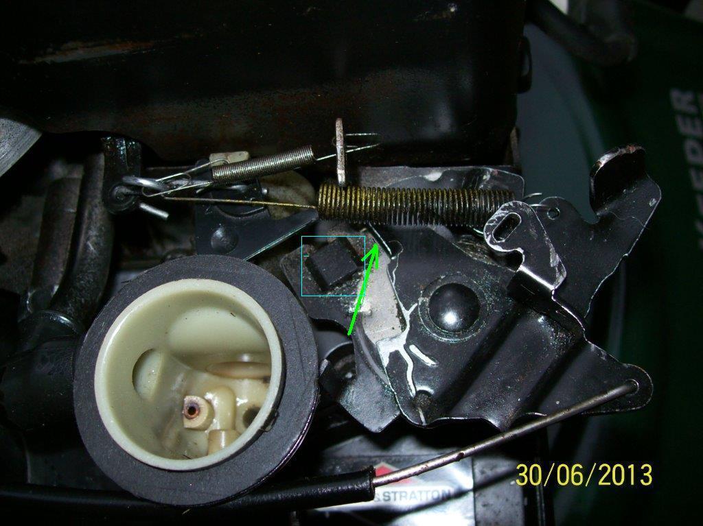

My second question is about the stop start arrangement for these engines. It all works fine but I'd like to learn a little more about the setup in simple terms please.
I also like to know how to safely stop these engines in the event the stop switch fails for safety purposes. Also do I need to service the arrangement like you do with the victa's.

The start stop arrangement is already set up for safety purposes, the only other way to kill it if it fails is to pull off the plug lead, preferably with some insulated pliers.
The setup is quite simple, under the throttle plate assembly there is a switch with a wire on it that goes to the underside of thecoil(on the carby side), When you fully close the throttle the plate moves around and makes contact with the switch, hence shorting the low voltage side of the coil, exactly as a 2 stroke. Pretty easy really. The switch is more easily visible with the throttle assembly removed (the top 3 head bots and the front carby bolt hold it on). You're learning, so pull it off and have a look around, its best done with the fuel tank and air filter assembly off so you can disconnect the governor spring(s) and trace the kill wire to the coil easier.
I hijacked this picture from someone elses post
The bit where the arrow point to is where the contact point for the kill switch is; if you move the throttle plate you'll see it. The plastic bit in the highlighted box is the kill switch assemmly mount, it just pushes through a hole in the throttle plate assembly.

Posts: 445
Bigted,
Thank your for the concise explanation. It is appreciated.
I have taken off the parts you indicated and taken a good look at the set up. The system seems fairly fool proof and reliable.

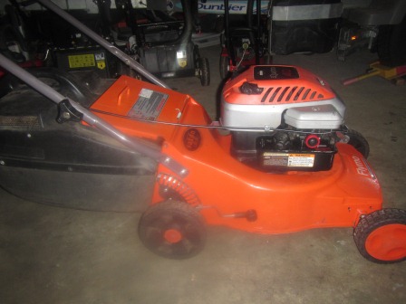

Posts: 445
Some pictures of the finished product.[Linked Image]
