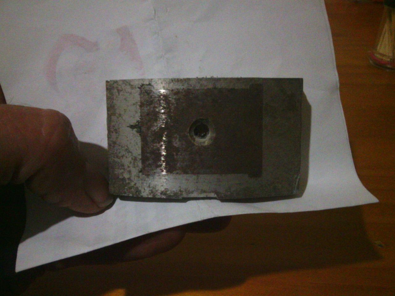

Grumpy I have drilled the screw surgically then hacksawed the two spots you pointed out ( great minds think alike) and found that it was glued underneath aswell so I then put some heat into it and after a few minutes ave it a light tap and off it came so far so good . Next step tmrw is to exstract the magnet out of the alloy caseing which I'm going to try and hacksaw around the magnet but I will wait to see what you think I should do first . [Linked Image]
[Linked Image] I will give it a good clean first eg the glued side.

That looks like good progress, roebuck. Just one thing though: check that the magnet is still magnetised. Heating magnets can have a bad effect on them.
What I don't understand yet, is how the original magnet carrier attaches to your other flywheel. Can you explain that, with a picture or two?
It does look as if careful hacksaw work is a good safe way to remove the new magnet from the new carrier, but I'm not yet clear on whether the whole of the new carrier and magnet could be installed on the old flywheel. If it fits, it seems like you could remove the glue residue from it, put a new batch of glue on it, and screw it onto the old flywheel as a permanent job, much better than the original one. Of course that requires that the whole new magnet and carrier weighs exactly as much as the old magnet and carrier, to keep the engine in balance, but you'll have to check the balance anyway, and correct it if necessary. We can talk about that once this part is sorted out. Essentially, you would have to either drill a hole or two in the flywheel rim opposite the new magnet to reduce weight, or bolt and glue on a small piece of steel opposite the new magnet to increase weight. It is not a big deal to do.

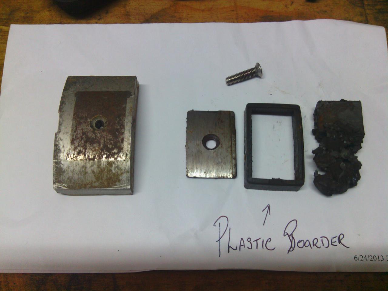

Ok the original carrier is just a plastic border that fits over the magnet and then the magnet plate over that an then the screw. There's not much quality in these parts . [Linked Image]

If the new magnet and carrier is a neat fit into the old flywheel, and the attaching screw lines up nicely with the tapped hole, I think I'd much rather use that and have it rigidly and permanently attached. The only downside is the balancing job, which can be fun anyway. To find out what it takes to balance it, just weigh the old bits (magnet dust, plastic surround, and cover plate, but not the screw), then weigh the new bit (magnet and surround all in one bit, but not the screw). Subtract the weight of the old stuff from the new stuff. You will then have to make up a small mild steel plate to screw onto the opposite side of the old flywheel, in the recess there, that weighs the difference in those weights. Of course you will have to drill and tap the opposite side of the flywheel to mount that small steel plate - you can't rely on glue alone, someone could get hurt.
