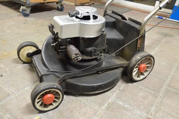

Hi guys,
we've had this old and mistreated lawn mower for three or four years (bought from cash converters for $95) and although it's never run quite right, and is ear-bleedingly loud we're fond of its rugged charm grin
Now that our lawn has finally grown past the point of not only shrouding the house in mystery, but also devaluing house prices throughout our suburb I decided last weekend to sharpen up the blades, clean it up and have at it.
What started as a quick spruce-up led to dismantling almost everything and shooting a quick rattle-can coat of killrust on the engine cover, and ended late Sunday night with this:
Unfortunately we also have a delegation of neighbours, several logging trucks, 40 Ewoks with rope bridges between their huts and a wild rabble waving flaming torches camped in the street waiting for the lawn to be mowed. Despite being pampered and cleaned and reassembled haphazardly Betty refuses to play. B&S ID is as follows:
Model 92502, Type 0938-01, Code 78052501
Perhaps the crudely stuck on FORD logo has something to do with it:
Or PERHAPS it has something to do with the fact that when I reassembled it all I used no new parts. Frankly I had no new parts, so instead made do with welding and grinding and wire brushing old ones in order to make them look less filthy and dilapidated. One thing I found disturbing was the slow weeping of fuel from around the base of the carb gasket after I 'primed' it with a shot down the guts:

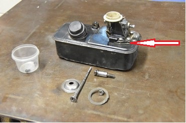

I get a cough and a couple of fires and then she goes back to sleep. idle/mixture screw thingum was wound out 2 turns, then 2.5 and then three to no avail. I used to be able to get her screaming and running quick enough by 'priming' and jamming the butterfly open with the aircleaner screw, but no dice.
Next step? points are clean, gap is 20 thou, fuel tank is cleaned out, fuel pickup tube screen thing is clear, aircleaner is... disgusting, but left off mainly [Linked Image]
and oil has been changed for the first time since 25th may 1978.
Thinking of buying Diaphragm and this: [url=https://www.outdoorking-forum.com.au/bmz_cache/d/d844bb80cbb61e6752272cfe02a98188.image.320x320.jpg][/url]
but none of the model numbers line up with anything and I'm not sure if this is just going to be a waste of time.
Thoughts?

A couple of points to start with. First, never try to run a VacuJet carburetor like yours, or especially a PulsaJet carburetor, without inserting the air cleaner retaining screw and screwing it in. Second, you do not seem to have followed an orderly process with your attempts to get it running, and this might have made your efforts futile. For example, it is very easy to make a 4 stroke too rich to run, and with the air cleaner screw not installed plus a random quantity of fuel poured into the carburetor air intake, you could easily have exceeded this limit.
I suggest you switch to an orderly process instead of a disorderly one. First, prepare the machine by inserting the air cleaner screw and setting the speed control in the start position. Remove the spark plug and pull the starter half a dozen times to begin the process of clearing out surplus fuel, if it has any.
Second, test for spark by connecting the plug wire to the plug (which has been removed from the cylinder head) and clamping the metal plug body to the cylinder head. Pull the starter and watch for a steady series of blue sparks across the plug gap. If you don't get this steady series, stop right there and fix the ignition system. If you do get satisfactory spark, reinstall the spark plug and connect it.
Third, you need to check whether the automatic choke is functioning correctly. Look down the bore of the carburetor and observe whether the choke is fully closed. If it is, pull the starter and see if it opens while the engine spins, then closes again as the engine stops spinning. If the choke isn't fully closed, you've wrecked it and will have to go through the carburetor overhaul procedure from the Briggs manual.
Fourth, check the compression. This means first, feel the resistance to pulling the starter. Second, disconnect the spark plug lead and tilt the mower so you can access the blade disk. Now check two or three more times that the spark plug is disconnected, before you go any further. Move the speed control to the stop position. Rotate the blade disk backwards until you find compression, approaching it from the wrong side. Then flip the disk backward toward compression, and see if it bounces back.
If you have functional spark, compression and choke, you are ready to start finding and fixing the fault. Please report back at that point.

Thanks Grumpy,
The manual and parts list will be very useful! I was hoping for more of a 'replace the carb to tank gasket' type of response, as the leakage seems to be the only thing that has changed since the haphazard rebuild. Although pouring random quantities of fuel down her throat to start her up is obviously not a very professional method, it HAS always worked very well in the past, hence my question.
Considering that Betty is (has always been) held together with bits of twisted wire, shoelaces and badly painted rust I figure any minor improvements and/or replacements that can be suggested by the experts on the forum here will be far better than the alternative (wife says take to tip, buy new mower). Although a rebore, valve job and forced induction are probably not on the cards anything that will return her to her former glory will be considered rather than consigning her to the scrap heap.
I have compression and I have spark, which leaves fuel. Maybe I'll just throw on a new gasket and try some fuel that ISN'T mixed with 2 stroke oil and is thirty years old and see if she wakes up again. smirk
