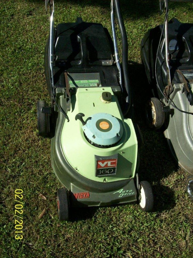

called into the tip today and picked these little treasures up, also scrounged a couple of motors out of their scrap bin, got the lot for $15, put some fuel in the blue one (dont know what it is apart from a victa) and it fired up first pull and runs very very well, could use it as is, but could do with the front axels fixing up a bit better than the pipe saddles it has on it laugh
the sunbeam needs back axles and wheels but only grabed it for parts, it turns over and has spark, the VC160 self propelled needs a new rope on the starter and the throttle fixing as its broken, I just grabbed it for parts as one of my other VC160 has a broken base, it was not until I went to wheel it over to the ute did I realise it was self propelled. blush

vc auto drives , there will be a few of us interested in which mark you have found.

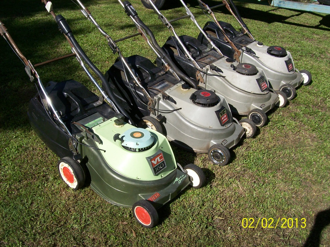

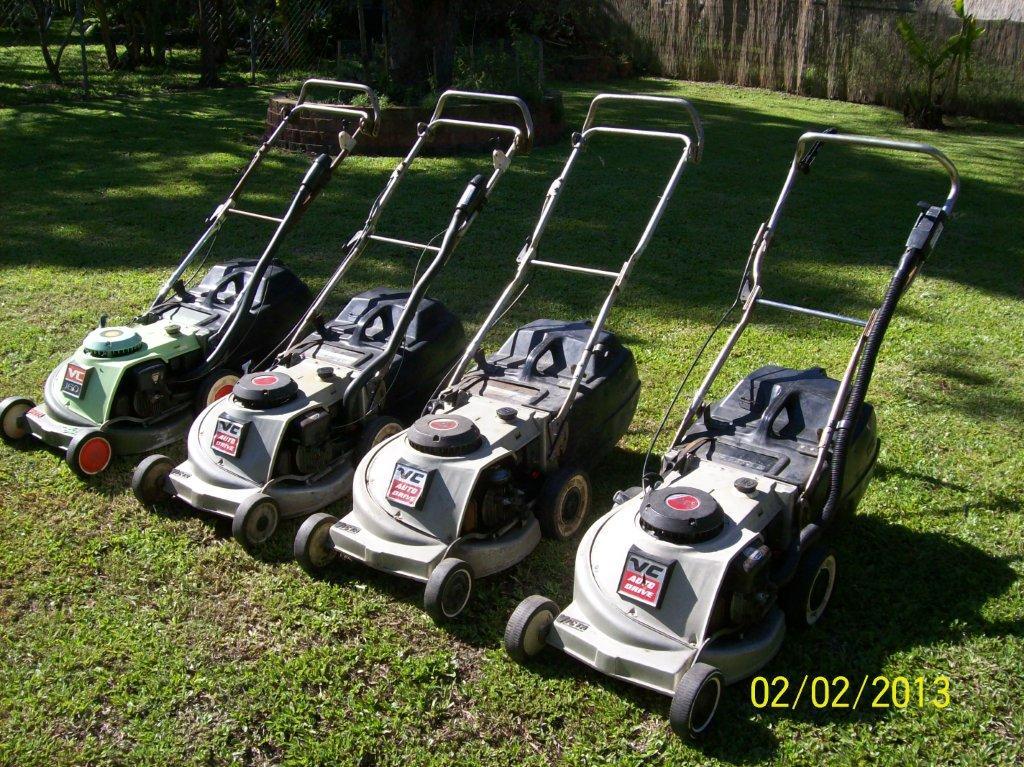

This is the order the auto drives go in.
VC-160 Auto Drive Mark I
VC-160 Auto Drive Mark II
VC-160 Auto Drive Mark III
VC-160 Auto Drive Mark VI
You can see the handles here.My mark III isn't complete and doesn't have an air tube or filter box.It should be like the IV on the right.

The easiest to tell what model it is (without checking engine numbers) have a look at the top of the handles. If it has a chrome bar for the clutch. It is a mark III if it is a plastic handle for the clutch it is a mark IV. As far as being hard to find. Yes they are getting harder to find. No not rare just losing them as they are at the point that people just throw them away. Yes I do have all four but it did take a while. Especially the mark I they are really hard to find.

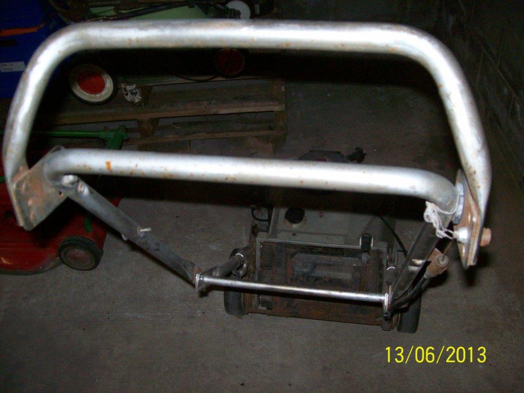

it looks like mark two , as blumbly says plastic handle is a mark 4 .
but im thinking two because it may have the G4 throttle control but it looks a bit like there is a G3 chilling down there hence the other rubber pipe..?
more photos will answer this .

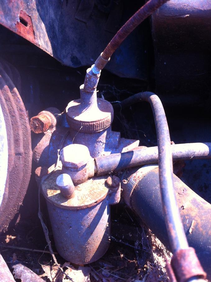

It's got a chrome top handle and from memory I think you are right there is something fishy going on in the carny department as I recon someone has changed it over
jonesy #46582 14/06/13 04:11 AM
Does it have a G3 or G4 carby. It's not really that easy to change from a G3 to a G4. You have to change the whole cylinder. Maybe look at the engine number and post it up. Maybe had a different engine.

From looking at the last pic where they have put another throttle control an snorkel iam guessin its got a g4 carby an most likely the engines been changed

After having a closer look and looking at the details I have it would be a VC-160 Auto Drive Mark III.
As you can see black hub caps and a G4.The only other one that had black hub caps was the mark IV.Also below the handles that were said to be on it.Not sure how we got to saying it was a mark II,but anyway without an engine number I'd say a mark III.Not that the engine number could be right it may be wrong we don't know.

Wow what the heck is it doing with a Amal Carburettor on it?Wow it should have a G4 on there.I'm not real sure how they changed it to fit that carby.Maybe changed the cylinder,or (let's put a spanner in the works)Maybe as it was an early Mark III,then maybe it had a G3.I guess that we will never know.Well from the engine number (which is the correct engine) it is one of the early Mark III's.She is in quite sad condition,but finally it is know what it is.
