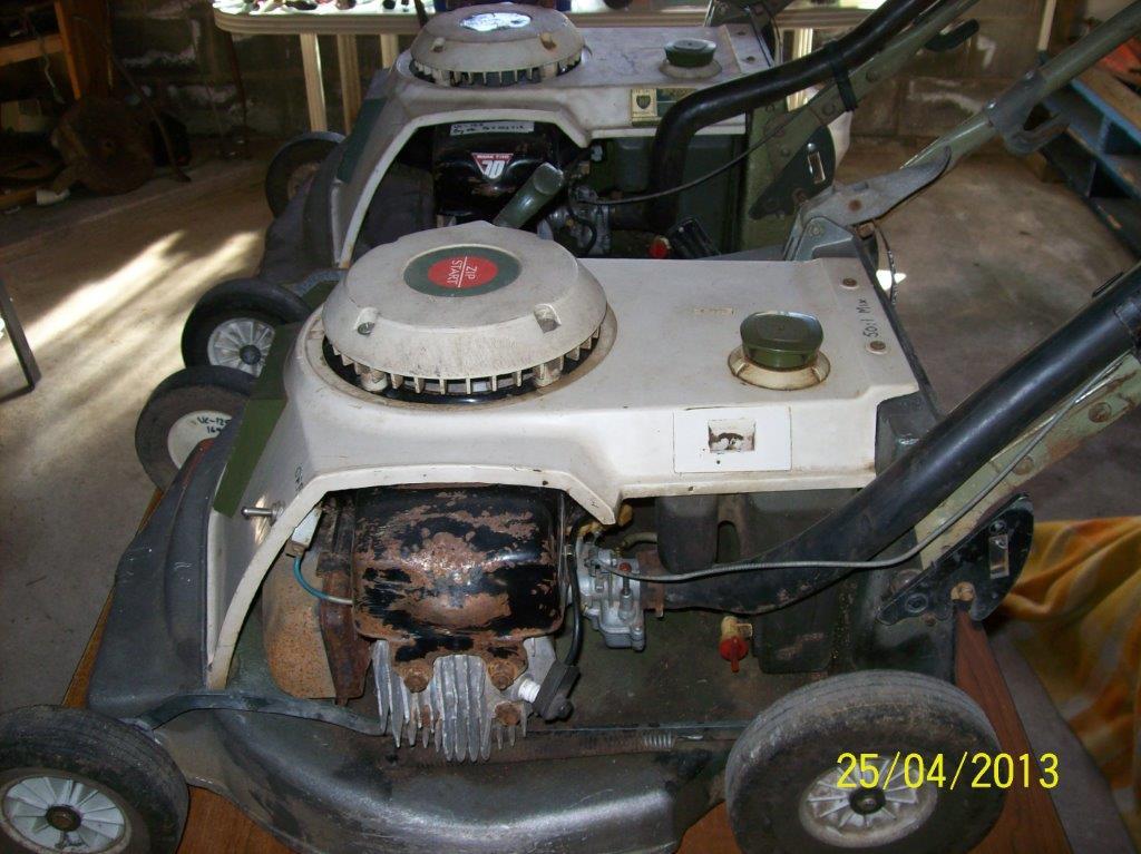

Hi have started with my VC-125 mark I and Mark II restoration.
Here is some pictures for you.
Before the pull down.
Engines removed bases stripped and cleaned.

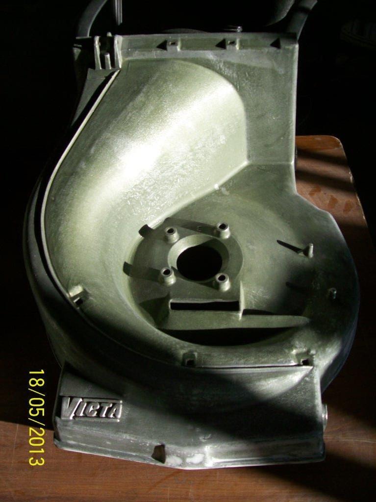

First coat of primer.
Then finally ready for paint.These two bases have so far been the worst to get ready for paint.Especially the Mark II base had so many dents and scratches to remove,but it's there now.Just ran out of day to do them today.Bugger.

They will look better after the paint goes on. Well They should there is a lot of prep work that went into them. I don't take all the dents out its not a perfect smooth surface. I just take out the dents and scratches they have. Just the ones from the using of them. I'm sure the mark II lived with a rock garden. I've never seen a mower with so many small dents. They were all over the front and down the right side.

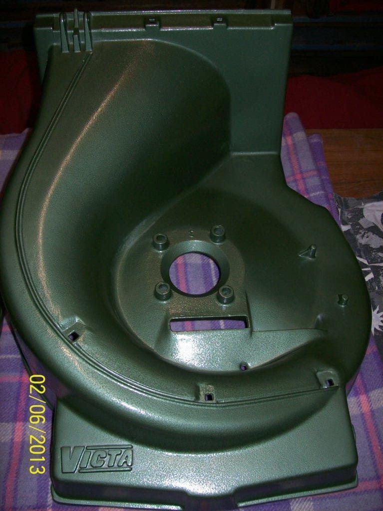

Well after a lot of stuffing around with the whether today I did manage to get some paint on the bases and catcher flaps.
I did have a scare when I started as the heavens opened up and started to rain.They did get wet but lucky for me they were dry enough to take a bit of water.The only problem was I had only just started the second coat.So I got them inside and then waited until I could try again.I couldn't believe how quick the cloud moved over to me.
They came out better than I was hoping for.I guess that just all comes down the great preparation that I do before paint.

So to get that finish did you use some bog then sand over?
Yes there is a small amount of body filer (Bog),but as I said before I only use it to fill in the small dents and scratches.I know you can't see it in the photos but all the in-perfect parts of the casting are still in the base.I don't remove them as they where not how it would have been new.Also to remove all of those would take months.All I'm trying to do is make them look like they did new,not turn them into show mowers.

Blumbly you have a good effect on the hammertone, do you do light coats or heavier coats when painting?
Yes there is good coverage there.You can control the amount of hammertone by the amount of thinners that is used.I use about a 40% to 60% ratio.40% paint and 60% thinners.Then just spray it on as pre regular painting.It still takes about 2 to 3 coats to get it done.I think I only did 2 coats as that seemed to work out.So I left it at that.That was top and bottom of bases as well as both sides of the rear flaps.
Posts: 539
Ok that makes more sence to me as they say on the can to only thin up to 20%. And it's bloody thick paint, do you just use a 1.4 set up in your gun? This will help heaps as the only hammertone I have painted was the blue base in my other thread and that was just a pressure pack.cheers.

1.4mm needle, jet and fan head, dont know if thats the corrct names for the parts but you will get my drift, my new gun came with 3 set ups, 1.4mm 1.8mm and 2.5mm, a friend of mine is a spray painter and he suggested the 1.4 would be best but I was interested as to what you use, cheers.
Oh OK now I know what you mean.I'm not actually sure what it is though.I don't even think I have the instruction book for it any-more.It's a gravity feed gun that I have used for some years now.I mean it still looks fairly new only because I do look after my tools.I guess it would be something around that size but I really don't know what it is.
