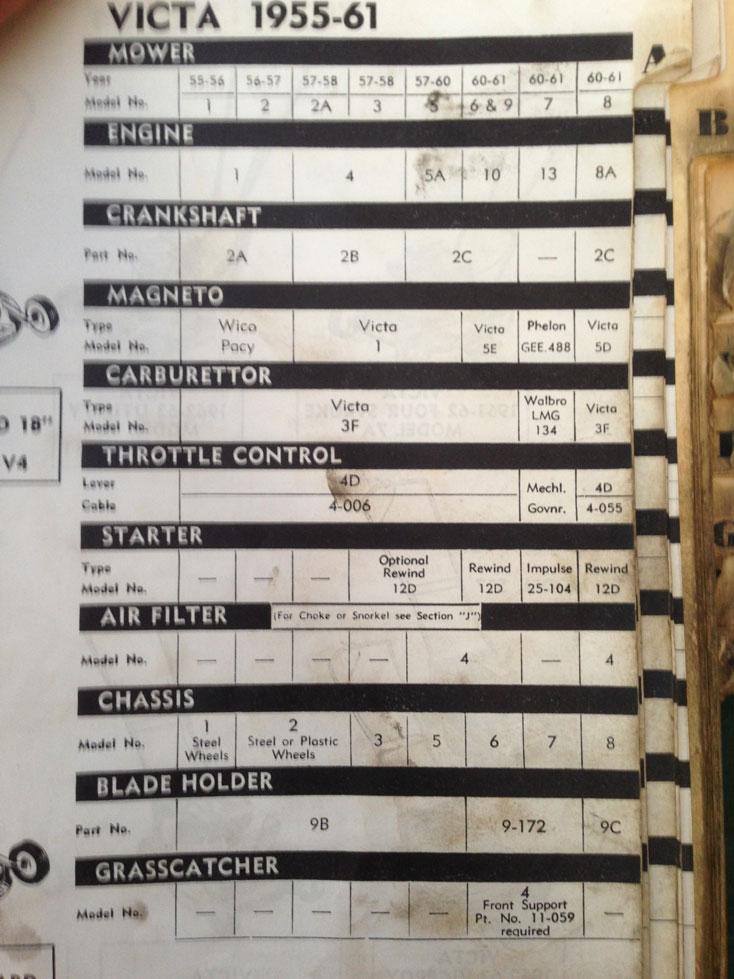

The next is a scan from the 1969-1970 green book.Which really doesn't say much at all.
However the next picture is from the 1971 reprint of the green book.
Now this clearly shows the models and which numbers correspond to which model.

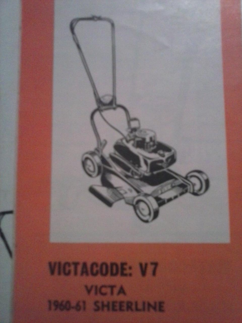

Here is a look at the second document. Now I believe this is a photo unfortunately it isn't the greatest picture,but it is clear enough.Maybe somebody else has this that would like to post it up.
You can see the victacode which shows the same in the 1971 version of the green book.

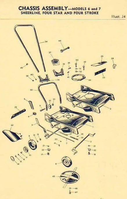

this also shows them that way. from the powerhouse museums website.
this shows v6 and v7 no slotted base [Linked Image]
this shows v6 with slotted base
as you can see . still a lot of conflicting info. i thought the double sided base (for carb) either side was for a consul2?

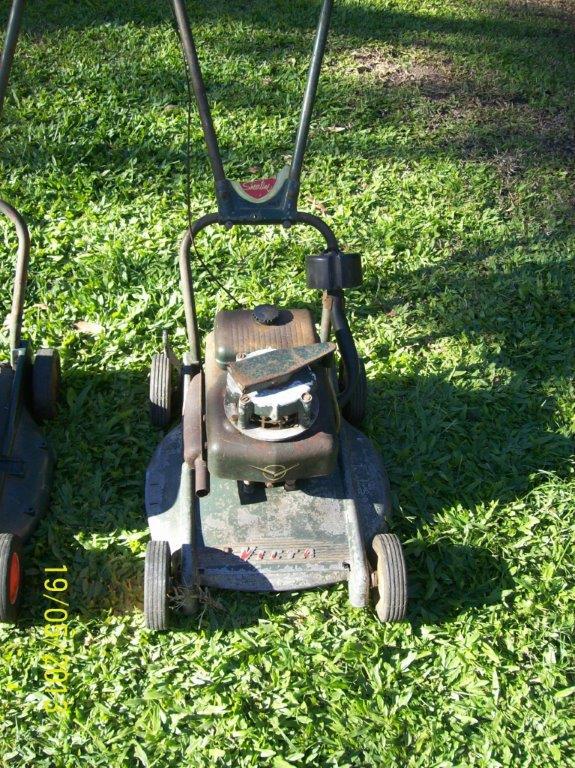

so the one i showed before is a model 9 ? engine number is dap29000. carb on one side only opposite to normal . [Linked Image]
and it was all green , dark cowl and handles , light green base with victa in red . and it is getting confusing now and if it is a 125 still , why is the plug in centre ? confused
Well vccomm as to what model it is,is still really unknown.However that engine makes me believe it could have come off the other Sheerline model.I do think that one has been played around with.I mean gold cowl and gold handles there is no reason for that other than somebody a long time ago changed it.That is the correct sides for the carby and muffler.Spark plugs were in the middle of this style of 125cc.They did run it that way for quite a few models...and yes confusing it is really getting.I really hope we can find an answer for this.

3. Blumbly posted this image in a previous thread.
Now the Image shows the Model 6 or V6....But if you read the lower info about "When Impulse starter is fitted use " blah blah drum" My point is that NOT in any example or document did the Mower we know as the model 6( tank in cowl) EVER come with an impulse starter. The "sure start" impulse was only fitted to what we currently know as Model 9.
