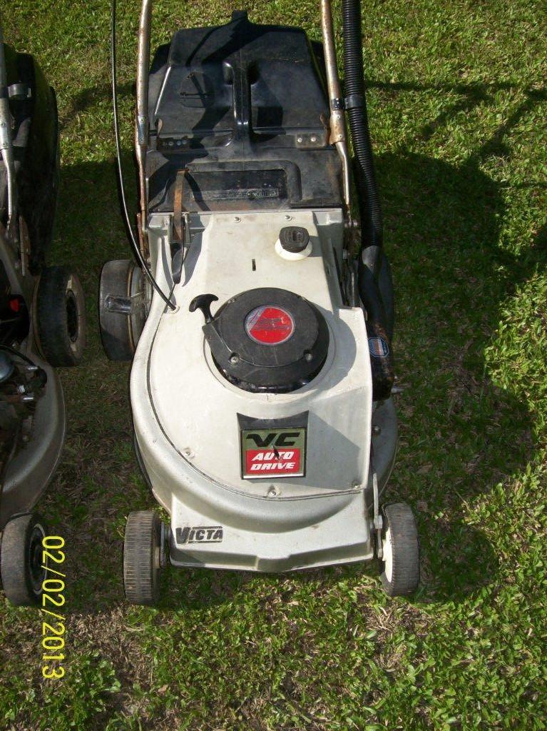

Just to help what Ty (Mr Davis) has done here to help identify the types of mowers in the VC-160 range.I will add some pictures of the Auto Drives.Will look at the VC-160's and VC-125's at a later date.Here are the Auto Drives for now.
Starting with the VC-160 Auto Drive Mark I V109 1972-73
VC-Auto Drive Mark II V136 1973-74
VC-Auto Drive Mark III V169 (1975-75)
Sorry about the condition,my mark III is in some real need of repairs.
VC-Auto Drive Mark IV V198 (1975-78)
Here they all are from left to right.
VC-160 Auto Drive Mark I,II,III and IV.
Any questions please ask always happy to help.
