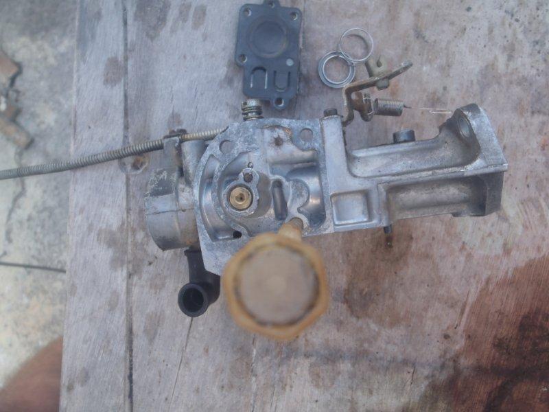

I'm not seeing any dirt or problems, Stuart. Did the carb cleaner squirt out of the pump intake port when you sprayed it into the mesh screen on the long pickup pipe? Did you have any difficulty pushing the fine copper wire through the main jet? Can we see a picture of the mesh screen after cleaning please?
Joe, because the engine stopped running after being out of service for a while, fuel deterioration is a more likely source of the trouble than dirt build-up. However there was a reasonable accumulation of dirt in the small chamber right under the main jet. I can only see a blocked pickup pipe as the problem if something like gum developed right across the screen. This would be a likely scenario if there were 15% ether (MTBE) in the fuel during a storage period, but hopefully we don't have ether in the fuel here in Australia. Claggy yellow fuel, probably due to ethanol, blocking the main jet (with some help from accumulated particulate matter around the jet) seems like the most likely cause to me, at this moment.

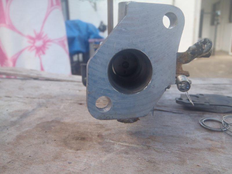

Photos after cleaning. When spraying through the screen, a small amount of debris came out of the port on the carby body. After that it seemed to flow freely. I have fed some fishing line down the main jet with no apparent obstruction. Hopefully everything else looks OK and we can move towards re-assembly? [Linked Image]
Before we talk about reassembly there are two points I'd like to clear up.
First, when you initially took the carburetor off the petrol tank, was there any petrol in the well under the main jet, where all the brown crud was collected? The function of the fuel pump is to continually pump fuel into that well, allowing it to overflow from that compartment and return to the main fuel tank. If that well was dry, the fuel pump was not working at all. If it had at least a centimeter of fuel in it, the fuel pump was working well enough for the engine to start and run, unless the main jet was blocked. Hence the answer to my question can tell us the cause of the engine not running in the first place.

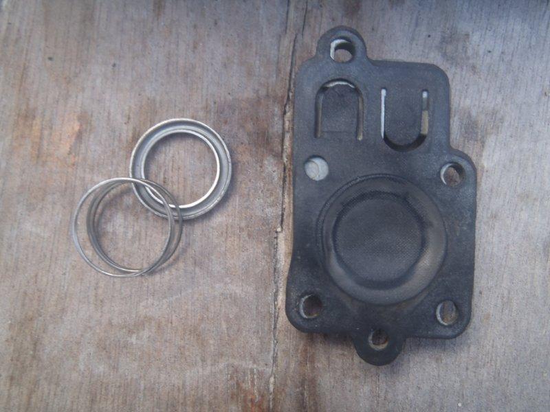

Second, could you please look closely at the diaphragm, checking for thin spots or actual cracks or perforations, especially where the piston/cup bears against it. If it shows signs of deterioration it would be appropriate to replace it while the carburetor is apart.

Yep, there was about 1cm of fuel in the well. I will replace the diaphragm as suggested and have cleaned out the petrol. Will start on re-assembly and check in when I get stuck with the levers. I am also replacing the throttle cable/lever so is how do you ensure that this is done correctly?
